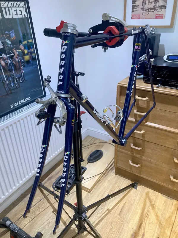

1993 Condor Professional 653 (Dave Yates built)
Finally the frame arrived today. Overall, I'm happy with how it's come out. The paint job is very good, and the colour is exactly as I had hoped – it's a dark metallic blue that looks very dark at times, but when light hits it, the blue shows a lot more, as does the metallic shine.
Some of the stamped areas which have been filled in white are a bit rough around the edges, which is a bit of a shame. I suppose white against a dark background is pretty unforgiving, plus those areas will be rougher inside than they were originally due to the rust that had built up in parts, but still ideally they would be a bit cleaner.
Hopefully I'll start the build tomorrow. I'm only slightly petrified of dropping a tool on the frame, the sort of thing I am inclined to do...😬

Beautiful frame and love the color. I just dropped a 10mm socket on forks, chipped the paint and lost the damn socket😭

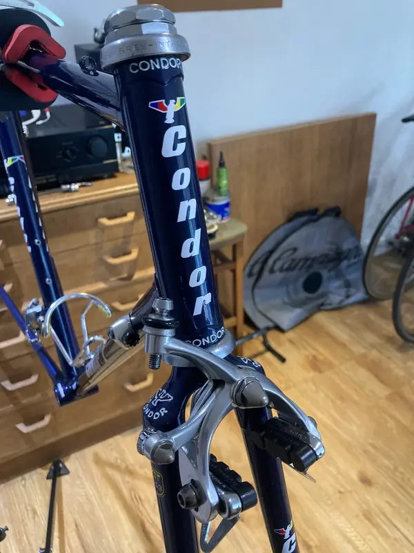

The headset is installed, plus a few other parts. I wasn't going to use the Veloce headset that came with the bike due to it not being in the best cosmetic condition, but due to the low stack height I was quite limited with options. The bearings and races are good, so after much deliberation I went for it. The top nut is not the original Campagnolo one due to the bad spanner marks that were on it, so I'll see if I can get a replacement at some point. There's a bit of patina to the headset but I think it's okay.
The wheels look pretty nice with the Rubino Pro 25s on, I think, and the cassette cleaned up very nicely.
Bottom bracket and chainset next. The stem and handlebars will have to wait a little bit as I'm still deciding about those.
Bottom bracket and chainset next. The stem and handlebars with have to wait a little bit as I'm still deciding about those.

The Mavic 610 unthreaded BB is installed, after a bit of improvised tool use. Because I had to separate the aluminium sleeve of the BB from the other parts to actually remove it from the frame when stripping it down, I've now had to re-insert the bearings into the sleeve (and therefore onto the axle). Unfortunately this seems to involve a specific tool Mavic created for this purpose, which obviously I don't have. The bearings of course have to be a very snug fit in the sleeve. The drive side one is fine because it can be inserted while on the axle, but the non-drive side has to be pressed onto the axle while also sitting tightly in the sleeve. I used a mallet to push a stem shim which was roughly the right diameter against the bearing. It's not exactly an ideal way of doing it, but it seems to have worked.

I decided to drop the idea of a triple chainset – it just didn't seem right on a bike like this. Instead I've got a Veloce CT compact chainset. This would originally have been 50/34T, but I couldn't find a 34T so I've got a NOS 36T ring on instead. Obviously this is more modern than the frame, but overall the look is fine, apart from the lettering design which for me marks it out as being too modern, so if this all works fine I will take the cranks off and sand, polish and wax them to make them fit better with the overall look.
The RD is Chorus and the FD is Veloce. For me the late 80s/early 90s was the sweet spot for the look of Campagnolo groupsets, with the polished and adonised finishes and the miminalist branding (though admittedly this does have the drawback of making it tricky to actually identify the groupset quite a lot of parts belong to).
