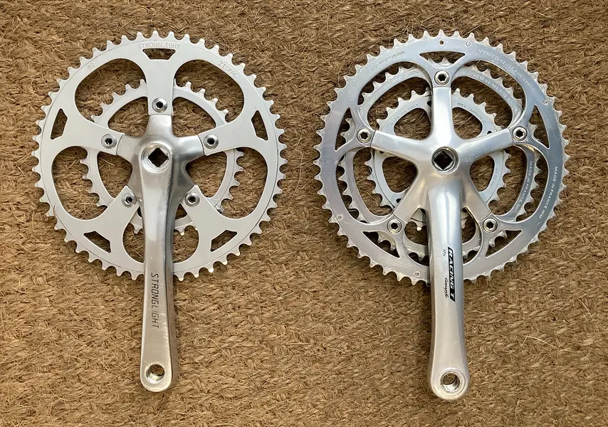

All this waiting has given me time to ponder how this is going to be built a bit more. I now have a Stronglight 50/32T double chainset which I got as part of a job-lot. It's from 1997 and I think it's the Escape model. I guess you could call this a 'super-compact' double, although I do also have a 34T ring I might use instead. This has got me thinking about ditching the idea of a triple, although this would mean having to get different derailleurs, of course. I think both these chainsets will work with the BB I have.
The plus sides of using a double would be that I can get a nicer-looking short cage RD (Athena or Chorus, probably), plus save some weight. Looks-wise I also normally prefer the look of a double, but in this case I'm not really sure. The Campagnolo chainset is more nicely finished, and of course if I don't use it, I would no longer have a full Campagnolo build. 🤔
Any thoughts welcome! I will wait until I actually get the frame back before deciding anything, anyway.
