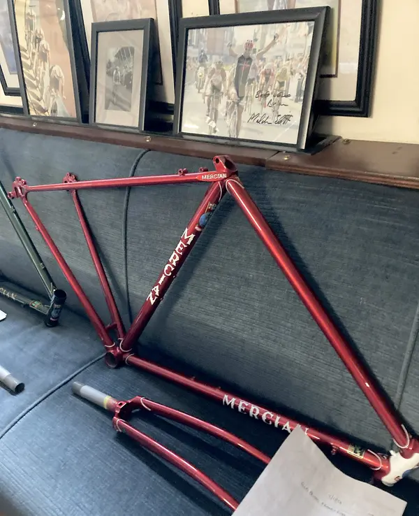

The paint shop reception is upstairs, where it becomes obvious that in a previous life the building was a snooker club/working men's club or similar, with seating around the walls. They are actually moving to a different building soon so I thought I'd document a bit of it, as it is pretty unusual. They still have a knackered pool table, which now of course has a bike on it.
I was amused to see a line of 3 newly painted Mercians in there. Presumably they picked up some of the work Mercian might otherwise have done when the latter were out of action (I think Mercian are now taking orders again, though I've not checked recently).

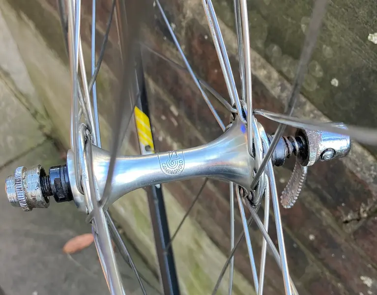

Hopefully it will only be a few weeks until the frame and fork are back with me. In the meantime I got the wheels out from the depths of the shed to clean them up. The wheels (Veloce hubs with Omega Hardox rims) are good enough to re-use, but the skewers are a bit too tatty for use on a newly painted frame, I think, so I'll have to source some nicer ones. This is of course the problem with putting parts on a pristine frame.

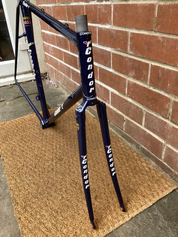

Finally the frame arrived today. Overall, I'm happy with how it's come out. The paint job is very good, and the colour is exactly as I had hoped – it's a dark metallic blue that looks very dark at times, but when light hits it, the blue shows a lot more, as does the metallic shine.
Some of the stamped areas which have been filled in white are a bit rough around the edges, which is a bit of a shame. I suppose white against a dark background is pretty unforgiving, plus those areas will be rougher inside than they were originally due to the rust that had built up in parts, but still ideally they would be a bit cleaner.
Hopefully I'll start the build tomorrow. I'm only slightly petrified of dropping a tool on the frame, the sort of thing I am inclined to do...😬
