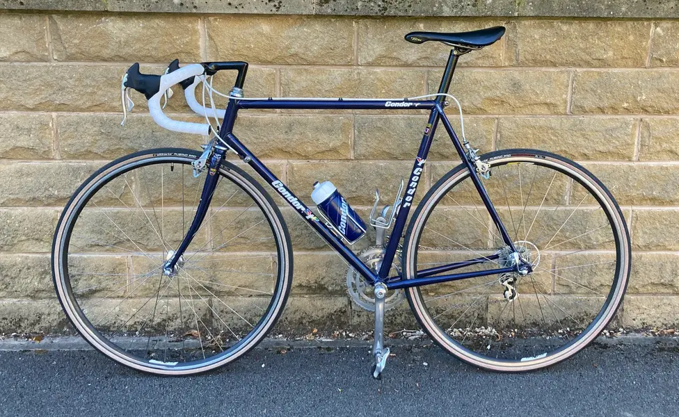

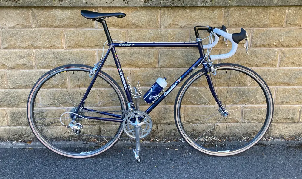

Finished. I took it out for a short spin today, but tomorrow I'll do a proper 25 mile shake-down ride.
Condor 1993 Professional
Frame and Fork: Reynolds 653, built by Dave Yates, renovated by Blue Whippet Paintworks.
Headset: Campagnolo Veloce
Stem: ITM 400
Handlebar: 3ttt Ergo Power Due
Bar Tape: Condor Supremacy
Bottle Cages: Condor
Saddle: Selle Italia Flite Titanium
Seatpost: Unbranded
Brake Calipers: Campagnolo Chorus
Levers/Shifters: Campagnolo Athena
Front Derailleur: Campagnolo Chorus
Rear Derailleur: Campagnolo Chorus
Chainsest: Campagnolo Veloce CT 50/36T (polished)
Cassette: Campagnolo Veloce 11-27T
Chain: KMC 8 speed
Bottom Bracket: Mavic 610 RD
Pedals: Shimano Ultegra (polished)
Rims: Campagnolo Omega Hardox
Hubs: Campagnolo Veloce
Skewers: Campagnolo Chorus
Tyres: Vittoria Rubino Pro 25c
It wasn't a bad day for a shake-down ride :cool:. Comparing this bike with my 531-framed MB Dronfield from 1994, there's not much to tell them apart, they're both equally nice I would say on first impression. Both are the same size, with similar geometry, and this one weighs almost exactly 10kg, which is also very close to the MB (any weight saving with the 653 frame is probably negated by the use of Campagnolo parts... :LOL: ).
This one's been a longish journey, but definitely worth it, when comparing to how it was when I got it.
Thanks to @mdvineng @Kempes and @Walterscot for their invaluable help with this one.

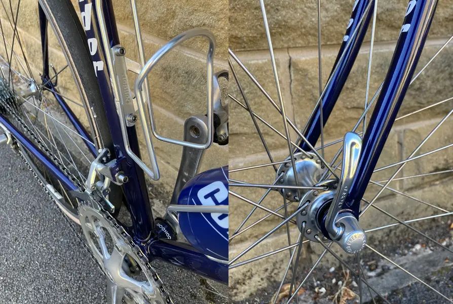

I've done a bit over 150 miles on this now, over the usual Peaks roads with plenty of climbs, both long and short. One thing I have had to change is the FD, as it really is designed for a 52T chainring. The 50T chainring meant the chain had a tendency to slip off through the too-large a gap between the FD and chainring. Really this should have been obvious, but I optimistically thought I could get away with it. I couldn't, so I've put on a FD for a triple that I already had, which has solved that issue for now.
The brakes are nice and solid, I have no complaints at all there. I'd say they are better than any single-pivot brakes I've used, but unsurprisingly not quite up there with dual-pivot ones, although comparing the 105 dual-pivot brakes from the same era with these monoplaner ones I don't think there's that much to choose between them.

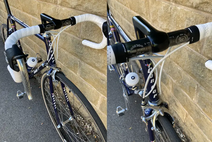

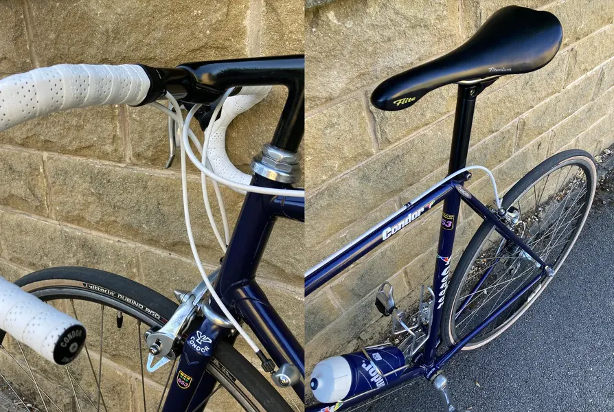

I've not used Ergopower shifters for quite a few years, so it's taken a little while to get back into using them. They certainly look better than the STI shifters that were out at the same time, but ironically given the name, they are less ergonomic, I've found. In particular, the cable routing where the gear cables go on the inside of the bars puts the cable right under my wrist when on the hoods, which is not comfortable. I can see why some people put both cables on the outside of the bars, and I did think about doing that, but decided against it. I might change it at some point.
The bike feels particularly good on long climbs and when cornering on descents. It's probably still a bit early to give a proper judgement, I feel like you have to live with a bike for a while to really get a feel for it, but overall it rides as nicely as it looks.
