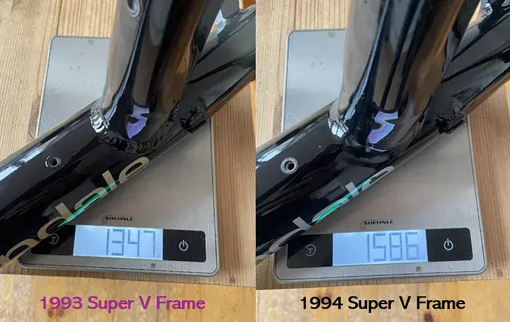

During the assessment of the parts, I learned many interesting things about the 1993 version of the SV, including the surprising fact that it was astonishingly light. Much lighter than the following models, as a comparison between the frames of identical size between 1993 and 1994 show:
This is all because of a fundamentally different frame design, with butted and thinner tubed, which is hard to spot but amazing for any weight weenie (more details in article above).

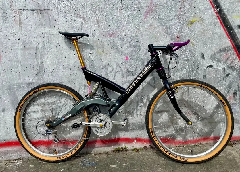

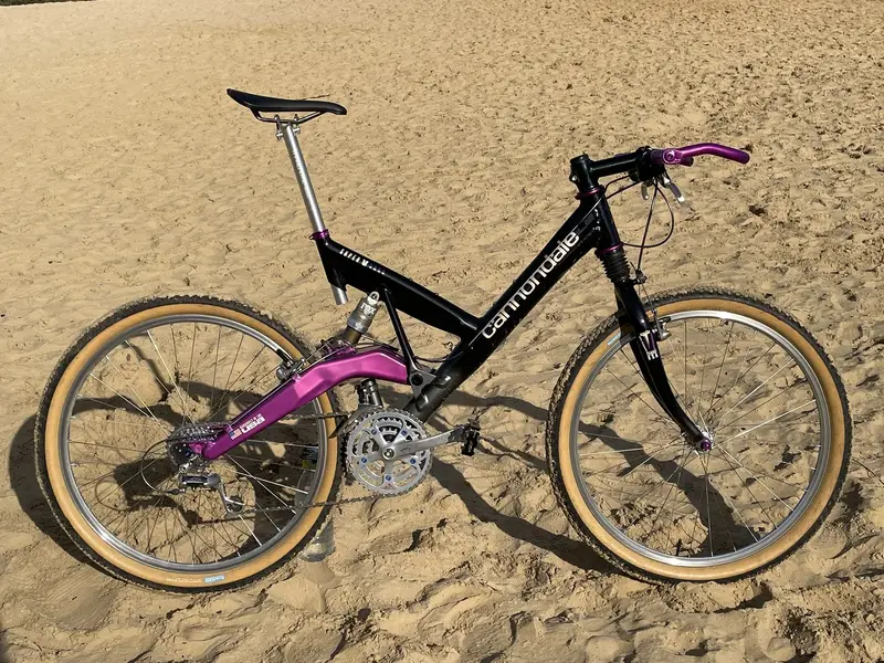

The first version of the build is shown below: in this version, a feather-light 10,05 kg. Quite light for a full suspension bike, and with a few optimisations I can easily get it to 9,8 kg.
Much more important, though, is that it rides really well, essentially its a fast XC racer, and the non-active suspension is perfect for this kind of ride.

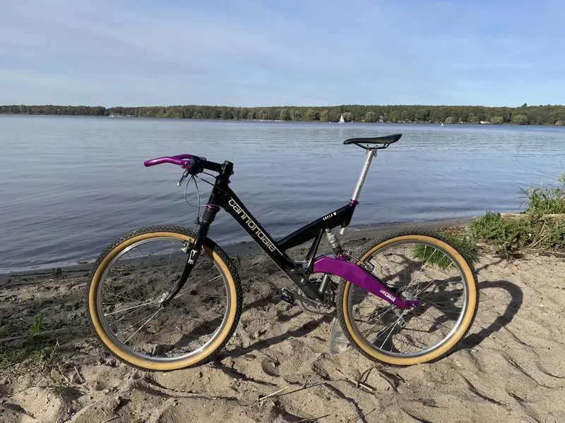

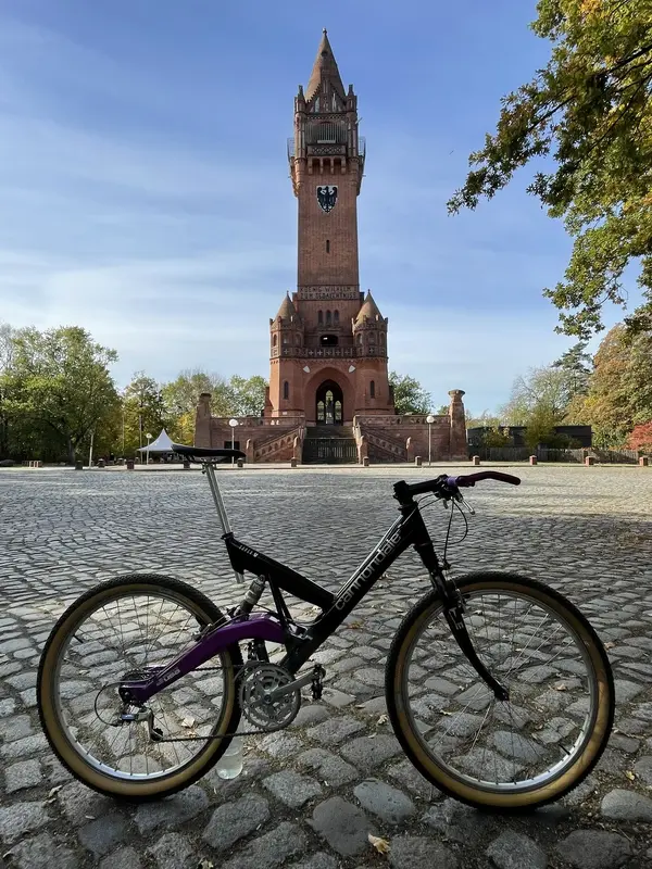

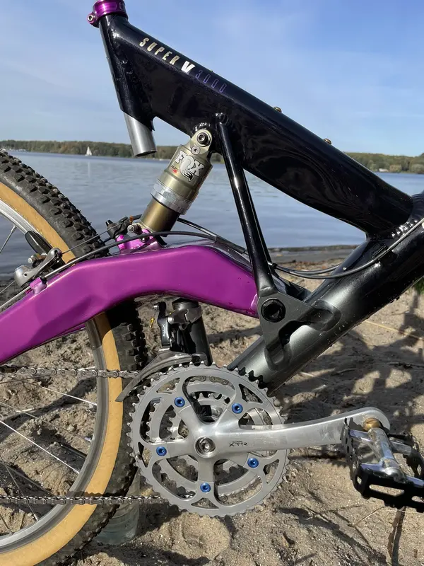

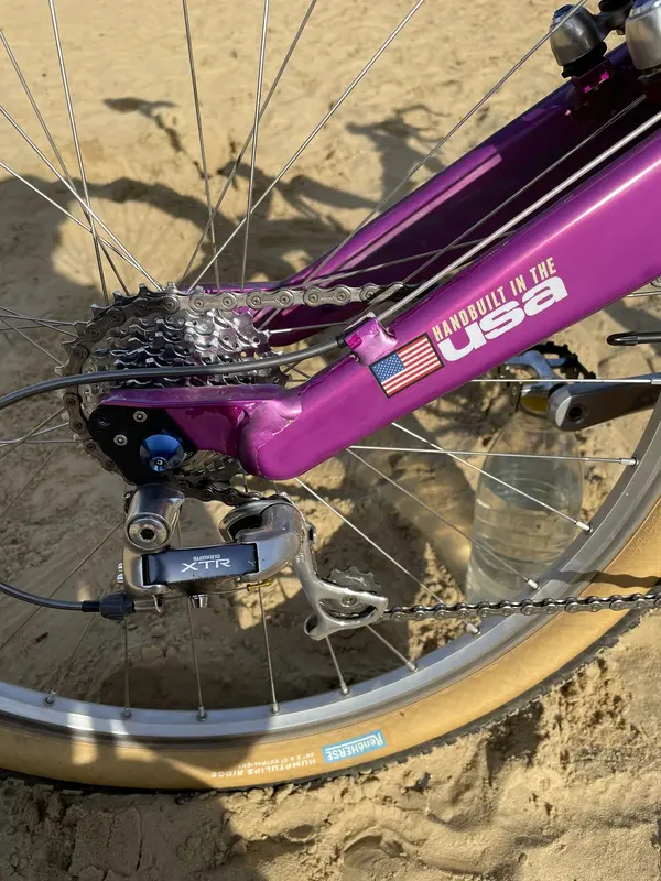

The 10 kg mark has now been clearly undershot, with a weight of 9.62 kg, thanks in part to a different (extremely light) original fork (with a top-mounted valve, very practical, under 1300 g).
Incredible what a lightweight marvel the first SV 3000 frame was. A full-suspension bike in this weight class without any CFRP ("carbon") ... unheard of.

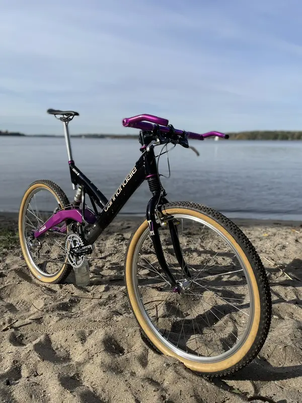

By the way, with the Rene Herse Rat Trap Pass tyres (395 g), you can still ride pretty well in (dry) XC conditions, but for the justified critics, here’s a picture with a more everyday-suitable NN (565 g) tyre setup:
It’s now entering the final round of pimping, where looks become the main criterion 😎
