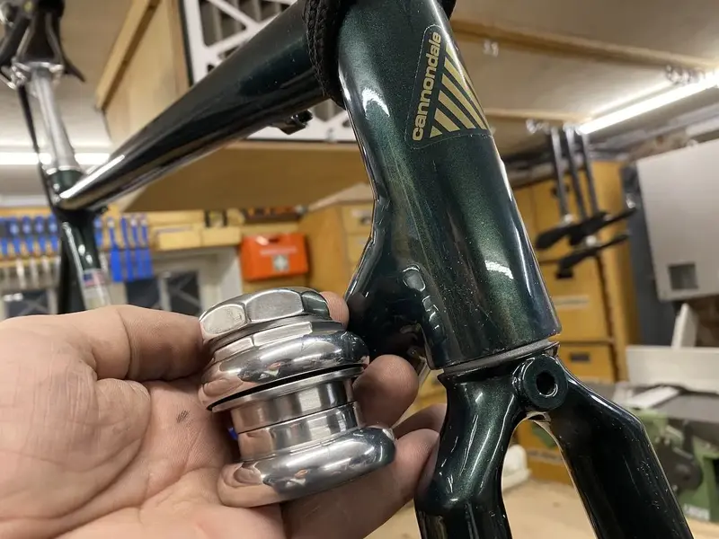

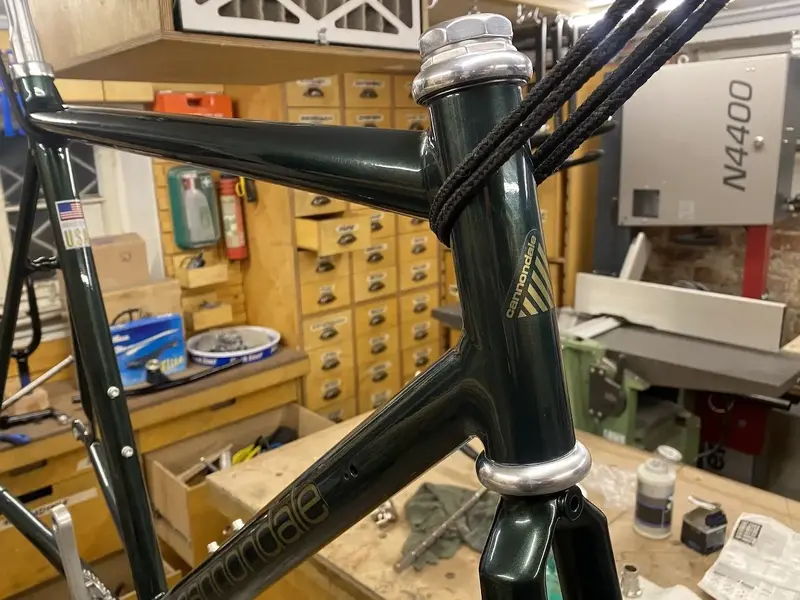

fguki

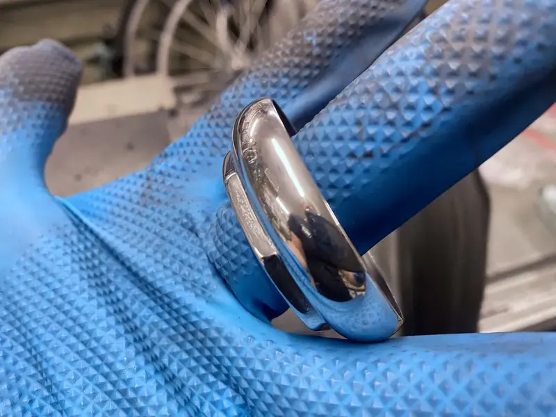

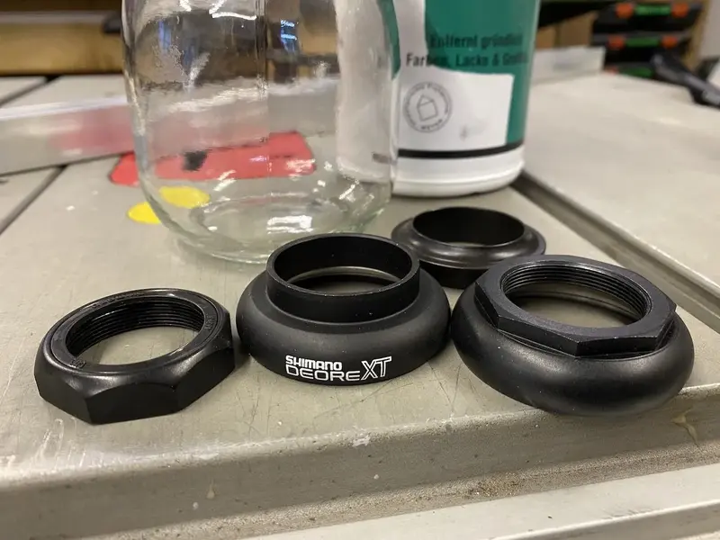

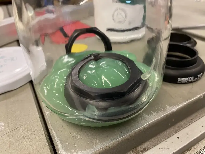

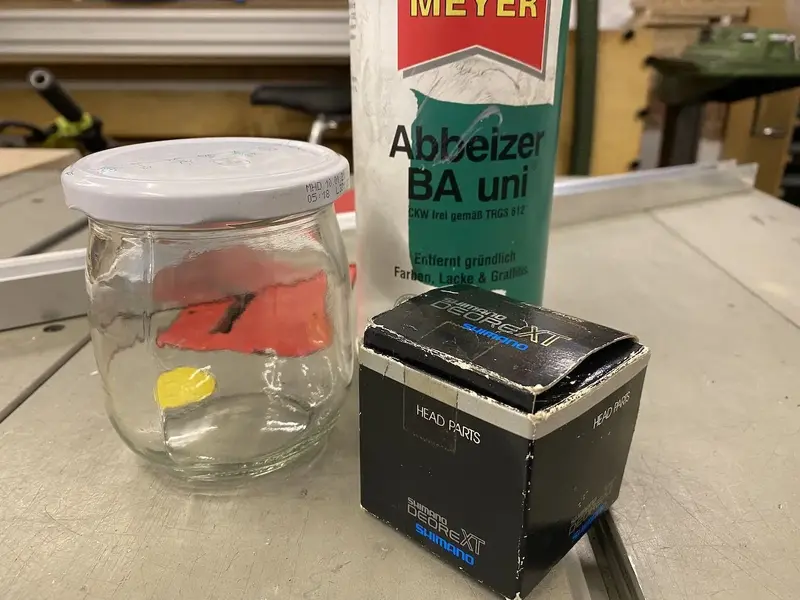

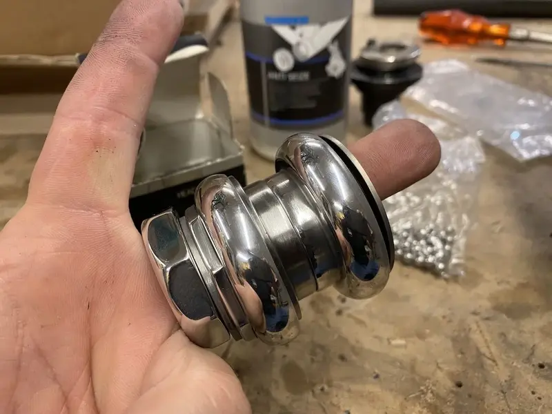

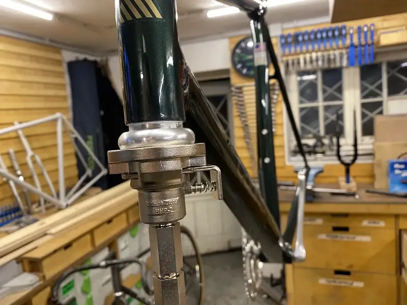

...while we were desperately searching for 1 1/4" inches CHRIS KING headsets (silver), I had the idea to take simple retro XT headsets and polish them to high gloss! :) The shape of the cups were pretty nice and the looks of it is quite similar to the original Chris King.

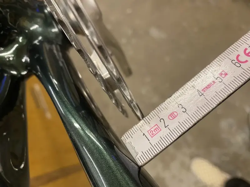

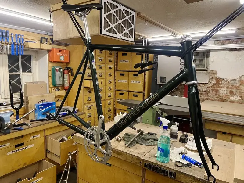

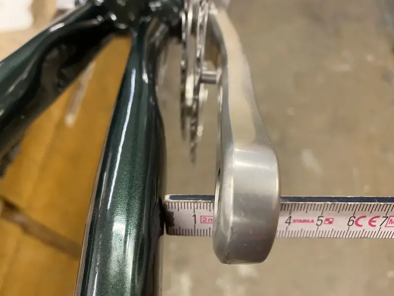

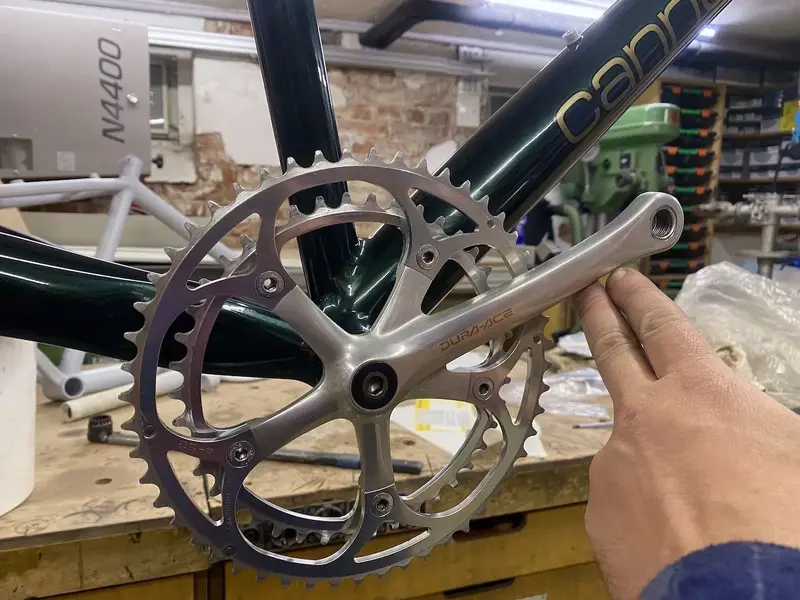

fguki

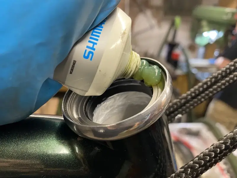

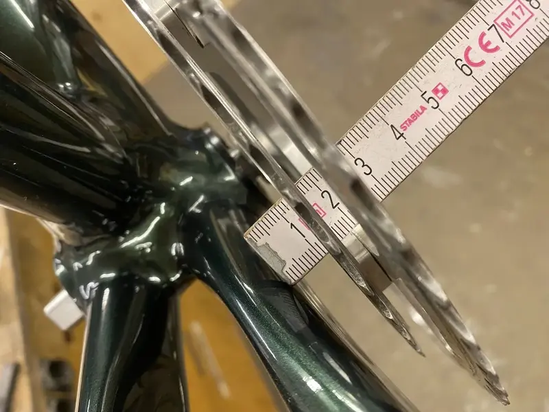

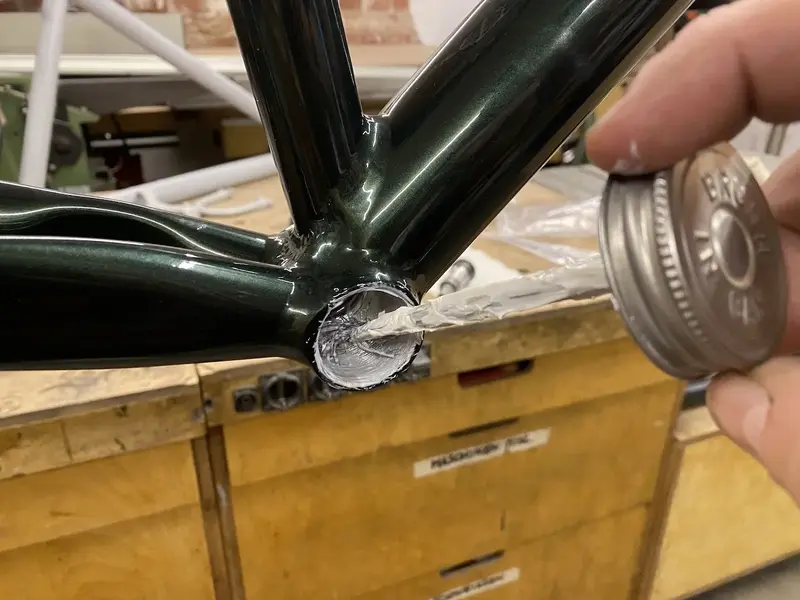

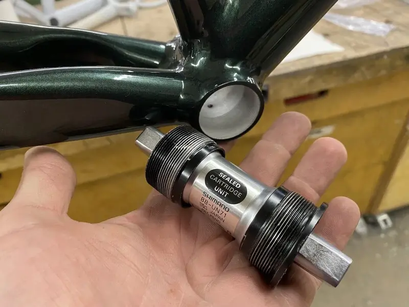

I had several retro bottom brackets laying around. I decided to try out an older SHIMANO XT M737 and already mount the first part of the SHIMANO 7400-7410 group set. Works perfectly! We`ll leave it like that.
1993 Cannondale R800 road bike track bike hommage restoration project by Falko Schloetel 044.jpeg
1993 Cannondale R800 road bike track bike hommage restoration project by Falko Schloetel 045.jpeg
1993 Cannondale R800 road bike track bike hommage restoration project by Falko Schloetel 046.jpeg
1993 Cannondale R800 road bike track bike hommage restoration project by Falko Schloetel 047.jpeg
1993 Cannondale R800 road bike track bike hommage restoration project by Falko Schloetel 048.jpeg
1993 Cannondale R800 road bike track bike hommage restoration project by Falko Schloetel 049.jpeg
1993 Cannondale R800 road bike track bike hommage restoration project by Falko Schloetel 050.jpeg
1993 Cannondale R800 road bike track bike hommage restoration project by Falko Schloetel 051.jpeg

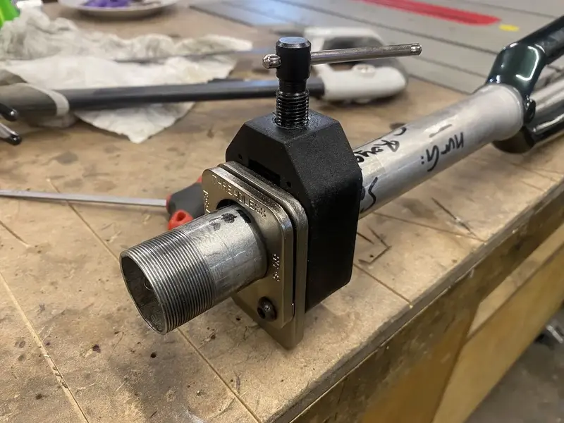

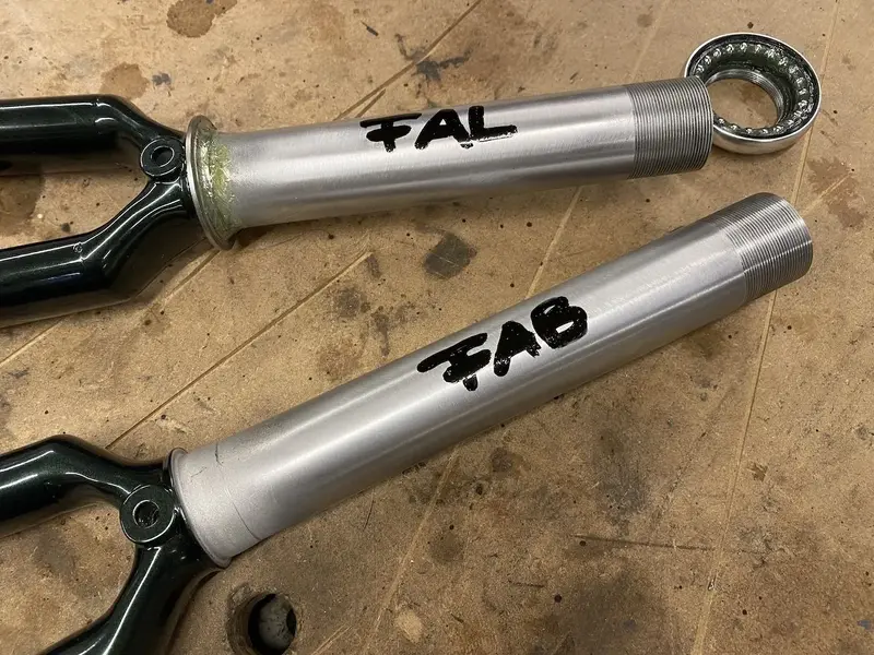

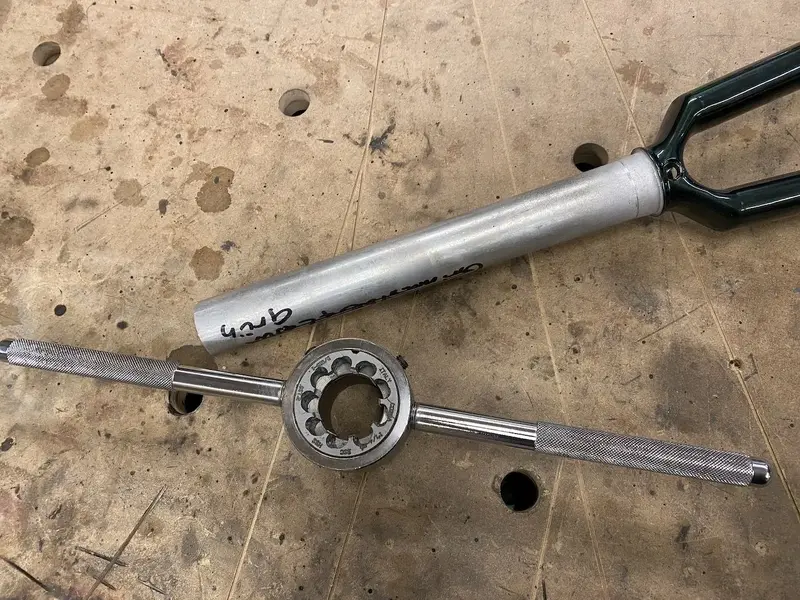

fguki

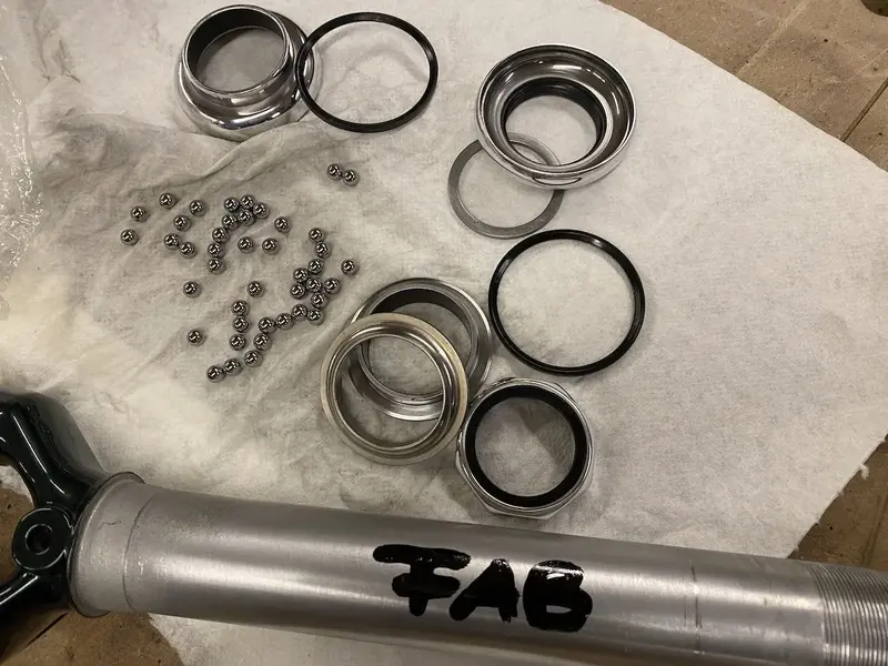

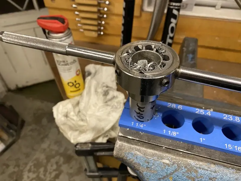

The steerer of the Sub One Fork on my brothers bike was a little more tricky. We wanted them both to be threaded, so I had to cut a 1 1/4" inches thread on it and shorten it a little. No problem with the right tools! <3 This worked out very smooth & fine. Both are now equally 1.25 inches and threaded:
