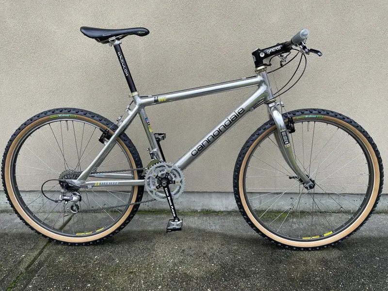

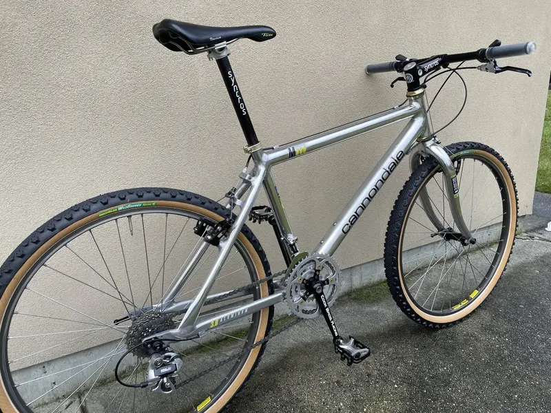

A few changes made since the last post:
I toned down the gold anodizing of the seatpost clamp to better match the faded look of raceface headset. A quick bath in ZEP industrial Purple, just not too long or the gold will fully disappear!
Ended up going with black caged XC pro pedals and put the bronze cage versions on another bike

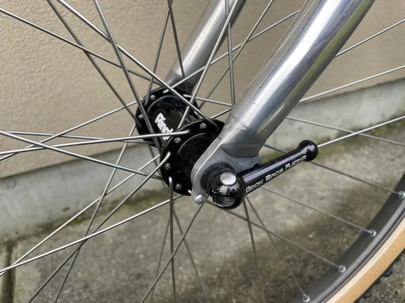

Swapped to black ano Mavic 231 rims with Ringle front hub. Unfortunately the rear is a non-matching LX unit but wheels are still an upgrade in my books

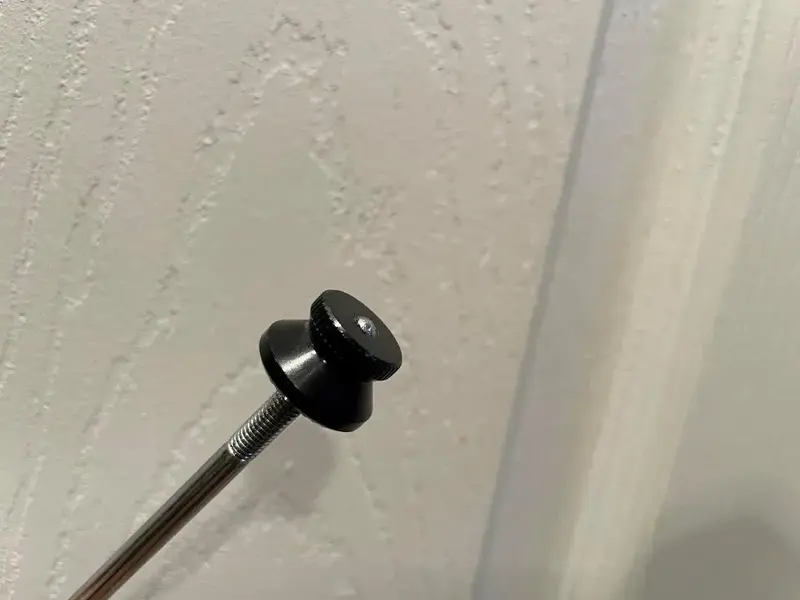

Cook skewers. These were more affordable due to them not having correct skewer nuts. Using some XT “O” rings and some careful hand filing followed but hand turning against a hand held disc sander I managed to create some acceptable (I think) Cook skewer nut copies. Much better than a random black ano nut I think.
Here is what I started with and how it ended up:
Another handlebar swap to a Syncros Hardcore bulge bar. It’s got the Syncros lettering under the grips. I’d always wanted to see what clear grips would look like so gave it a go. I’m pleased with the result.
One upcoming change is the removal of the Syncros crank-o-matics as I just landed a bucket list crankset that needs them more :cool:. I’m going with repro black domed Cook style dust caps on the Cook cranks
