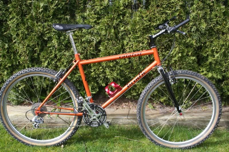

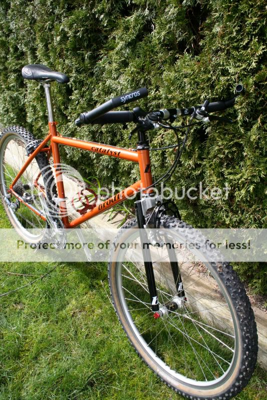

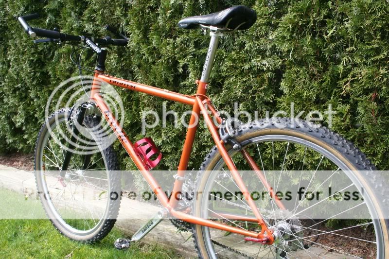

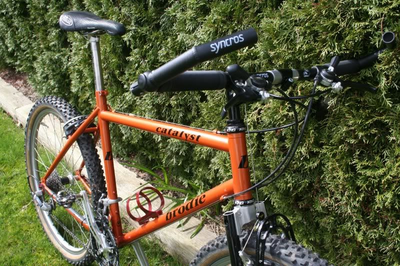

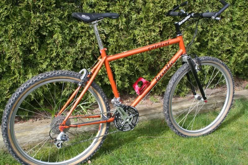

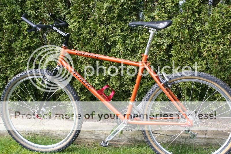

Finally have this built up. Specs are as follows:
All are reasonably retro except pedals. Had considered a set of Syncros revos, but liked the look of the RF and didn't want the hassle of repainting/redecalling the Revolutions only to have them come off after 2 rides...
Frame: Fillet brazed Brodie Catalyst
Fork: Brodie Gatorblade
Headset: Chris King 1 1/8 threaded
Stem: Brodie Superlight
Handlebar: NOS Syncros Gorrilla
Grips: ODI
Barends: NOS Syncros Prohorns
Brakes: Deore XT II U brake/M900 XTR cantis with Brodie Brake Booster
Brake Pads: XT
Brake Cables:
Cantilever cable hangers: Onza chill pills
Brake Levers: Paul Short pull cantis
Shifters: XT Thumbies
Front Derailleur: M732 XT
Rear Derailleur: M735 XT
Derailleur Cables:
Cassette: 8 Speed XTR
Chain: XT Hyperglide
Cranks: NOS Race Face Turbine LP
Crank Bolts: SRP Ti
Chainrings: NOS Race Face
Chainring bolts:
Bottom Bracket: M900 XTR
Pedals: XTR (M970)
Hub Skewers: Ringle Ti
Rims: Mavic 217
Hubs: Nuke Proof
Nipples:
Spokes: DT DB
Tyres: Ritchey Megabite 2.1
Saddle: NOS Flite Titanium
Seatpost: NOS Syncros Ti
Other bits: NOS Ringle anti chainsuck thing, NOS XT sharkfin, Ringle bottle cage
Weight: ?24 pounds

Very, very, very nice. I had the same handlebars on my Fuquay and Yo Eddy, excellent, and one of the first wideish bars.
Very nice. Brodies are absolutely among my favourite bikes. Pretty much on top the shortlist.
What year did the first Turbine LPs appear? I thought it was '94 - I can't help feeling that the first gen. Turbines (with clover-leaf spider) would suit it better...
And what happened to the Brodie bars?
DAMN looks exactly like my 1990/91 Catalyst I used to own in 1991/92 except mine was the Emerald Green color. Man I paid $800 CDN for the frame back then and was the only Catalyst in my area (Kamloops British Columbia) at the time. Ahhh the memories.
