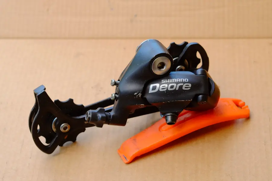

New (old) parts
To get 11-36 rear and 50/40/28 front to work
