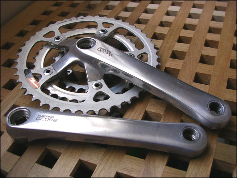

Deore Chainset - I've borrowed this from another bike until I get my hands on a suitable XT Chainset as a more permanent fixture.

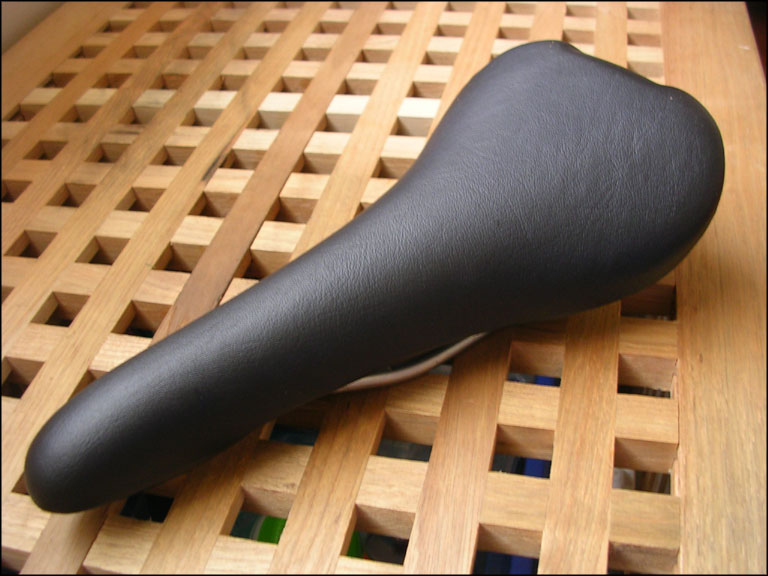

One of several saddles I've re-skinned recently.

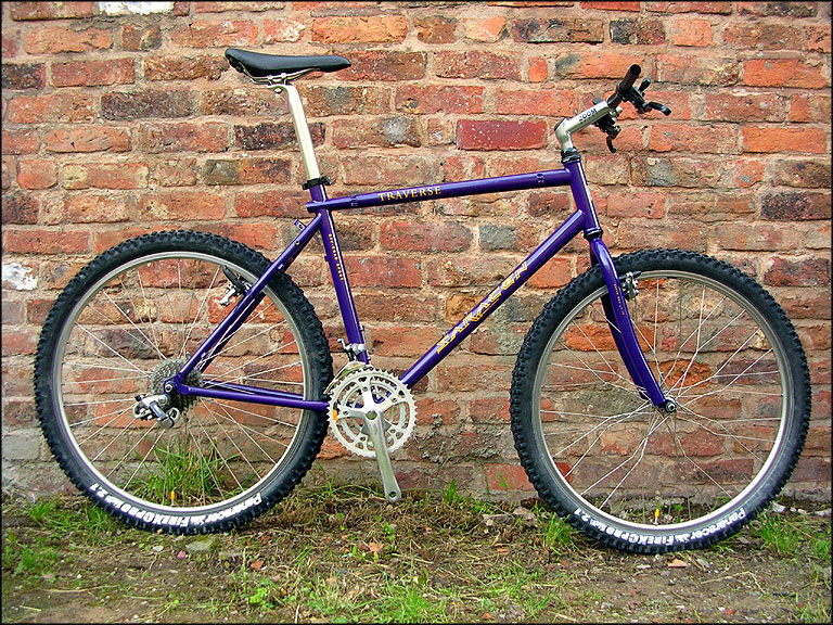

I spent a little time today building up the parts I have so far, with a spare set of bars until the new ones come along, and some wheels of course.
This photo makes the frame look a bit shorter than it really is. The fading evening light and bright orange bricks don't really do the colour any justice either.
Anyway, I'm away all next week so this build will, rather frustratingly, have to be put on hold.
looks great Paul, tyres add muscle! Using a high band front mech tho... would it not have had a low band on originally?
Excellent - just as i remember my one.. originally 27.2lb fitted with standard ritchey megabites
Dead Rats - they were fitted high front mechs originally if memory serves me correctly.
Yep. High band front mech was the original spec. I would like to get hold of some more skinwall tyres for this one. Megabites were the original spec but I'd be happy with Z-max or Smokes.
In the meantime though, Panaracer Fire XCpros have proven performance. The 2.1 Fires are just about narrow enough to fit within the limited chainstay clearance. I'm not too keen on the big white logos on this one though.

Will keep a look out dsp.. This bike will look so cool with megabites or like..
Now you mention the clearance - I hit a tree and slightly bent my drive side stay.. Would no longer accept 2.1s so i had to run a 1.9 porc rear.
