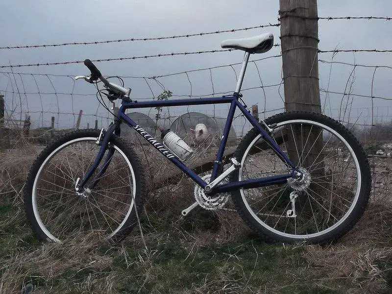

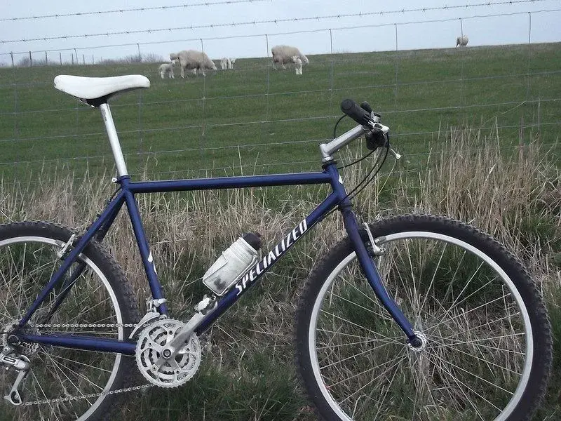

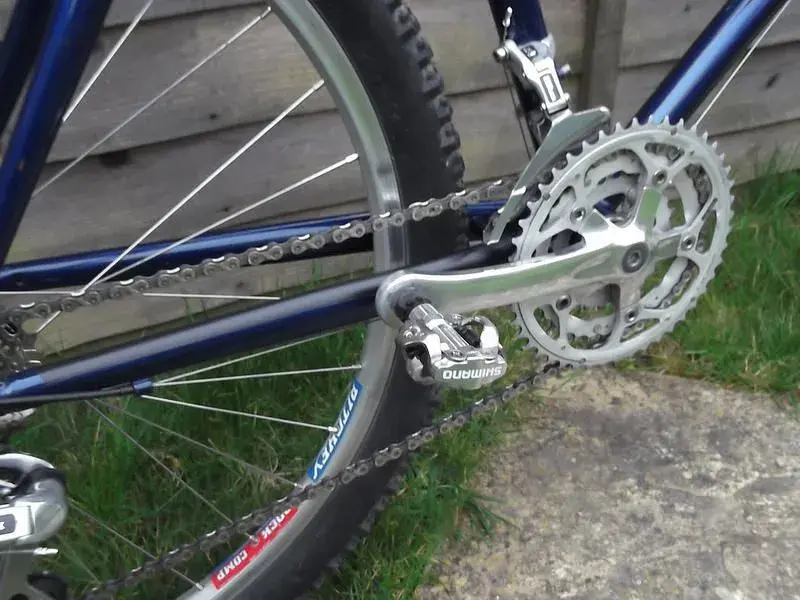

Finished pics for you,
The observant among you may have noticed the gear cables are crossed under the downtube, feels a more natural line to me at the downtube bosses.
I think the dark blue and shiny silver goes nicely together 8)
Those wheels aren't the lightest I'll ever ride, but they're ok and stayed true ok :wink:
BTW, the drop out seems to be holding out ok
Hope you like it folks :wink:
Mike
