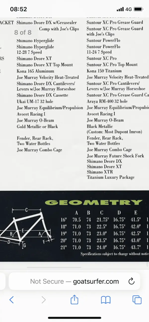

To be fair, looking at the 92 catalogue I’ve measured the top tube wrong:
I’ve measured actual c/c where I should measure virtual.. I’ll check again when I get home. 👍

Looking on a computer rather than phone now, I see what you mean about the tapering on the other tubes. Downtube and toptube tapered similar to my 95 Explosif with Columbus Max, but clearly not that late with the rack mounts - still seems to be a 1992 style, also with classic Kona missing cable stop, noting that isn't foolproof.
I had always thought the 92 explosif was straight tubed, but apparently Tange Prestige Concept did have ovalisation.
So subject to new measurements being taken - if they check out and ovalisation matches the Tange Prestige Concept style, then I would go 92 Explosif as other tubesets then are all straight (I think - I'm learning today!)
Awaiting new measurements excitedly

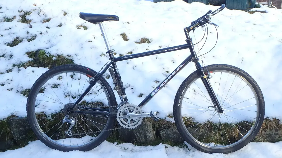

I am pretty sure that early Konas measured from top of BB to top of seat tube. Pic of my 18" 1992 Explosif is below (it measures 19" C to T). Down tube is tapered and ovalised. Top tube ovalsised. Bulge at base of seat tube. I think top tubes were a bit shorter than later frames as well. So....frame for sale is probably catalogue size 16" which might explain why seller found it a bit small.
