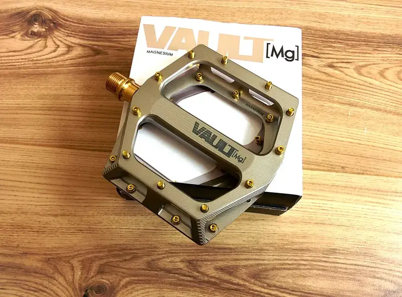

Hadn't really thought about pedals until recently. I've always used spd's but flats seem to be the in thing, I know my brothers pretty much only ride with them. So decided to go for them instead.
For the Kona I bought Saint's which seem well made and good value in the sale but a bit on the heavy side. So looked around and DMR Vaults seem to be most peoples top choice so went with them. Instead of the cheap muck I went for the Mg Superlight's which are nearly 1/2lb lighter than the Saints.

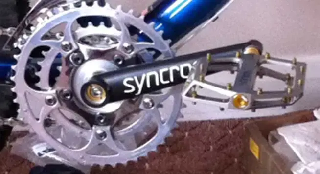

Well it's built but the pedals don't look right, they're massive, just look silly with the Revolution cranks. So I'm going to look around for something period correct. Guess that's Grafton Speedtrap's, Suntour XC Pro's (not likely) or XT M737 SPD's.
