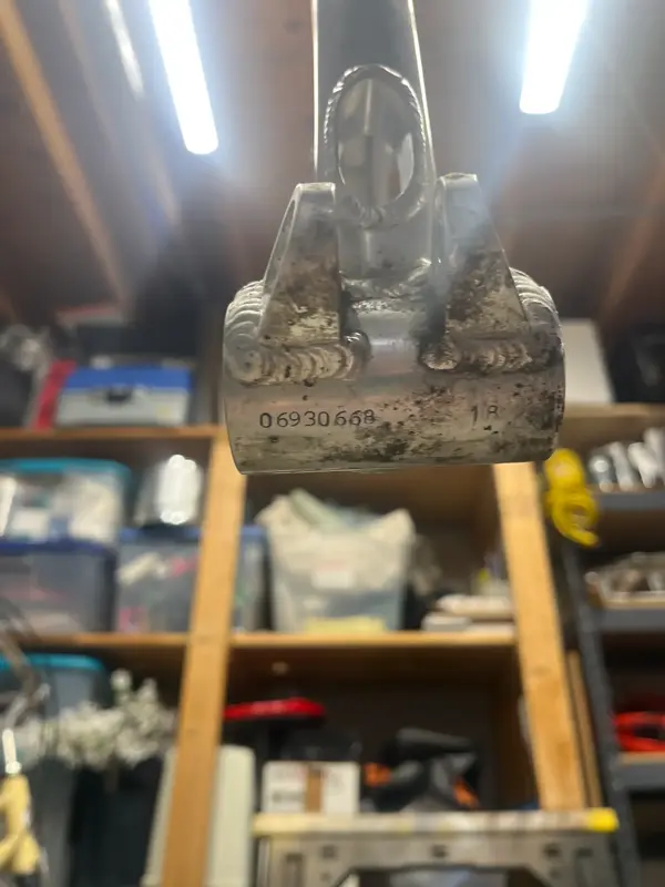

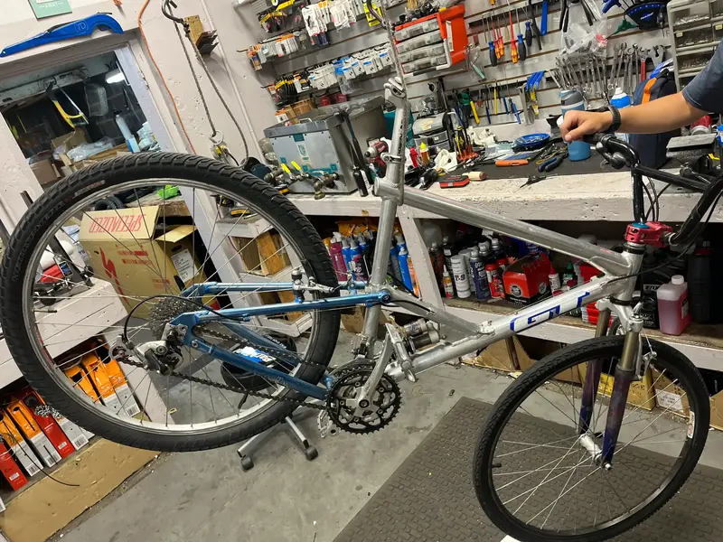

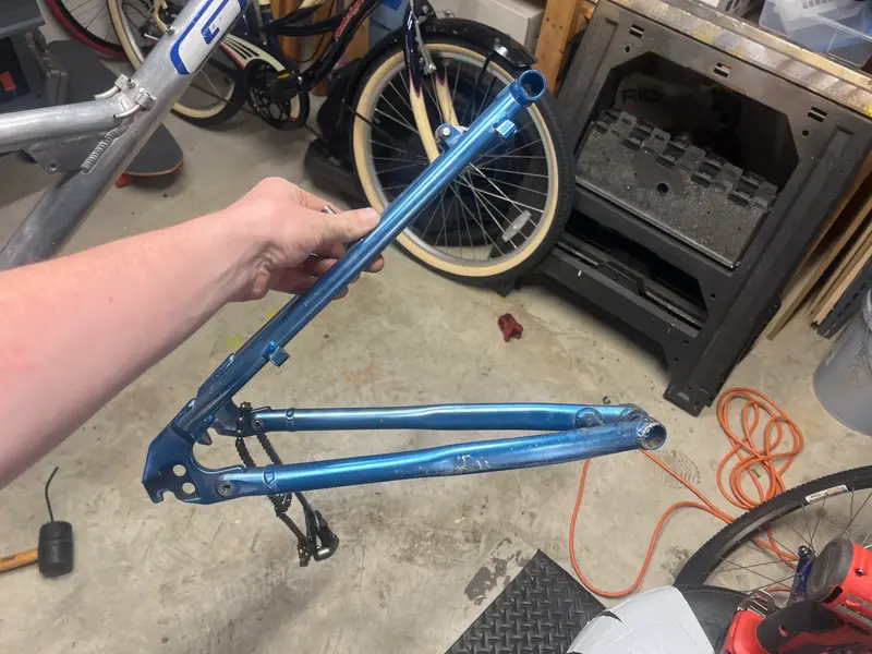

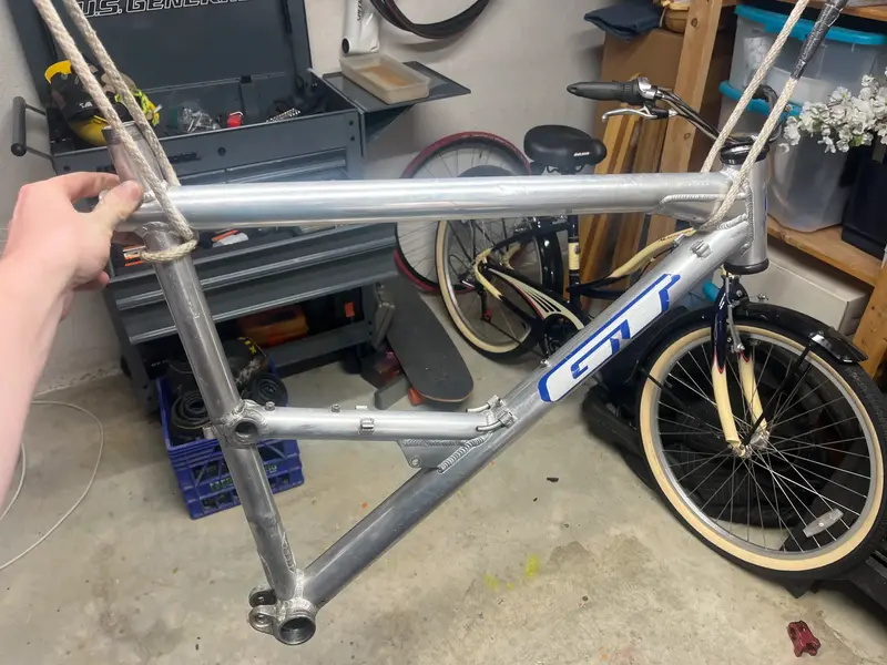

Some guy came in to the shop I work at and dropped off an old gt rts. I was wondering if the rear triangle is original or a warranty replacement of sorts.
Also wondering about recommendations for rebuilding the rear shock.

I'd guess the rear end is original, I have a 93 team with an alloy rear end. I would hazard a guess that the rear end pictured has been resprayed, blue decals to match. It's also got the canti rocker which is often removed and lost.
Shock rebuild wise it's a challenge in the UK. It's nitrogen charged and old, though i don't think it's a complicated shock with proprietary parts.

It would be second version which was 94 MY.
93 had the steel rear , brake roller , and different cable routing.
