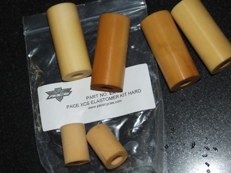

some bits and pics (having trouble with p/bucket at the mo) :D ...........
BNIB :D
New elastomers :D

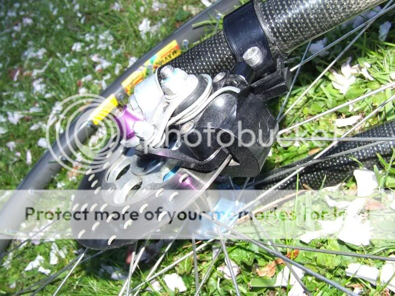

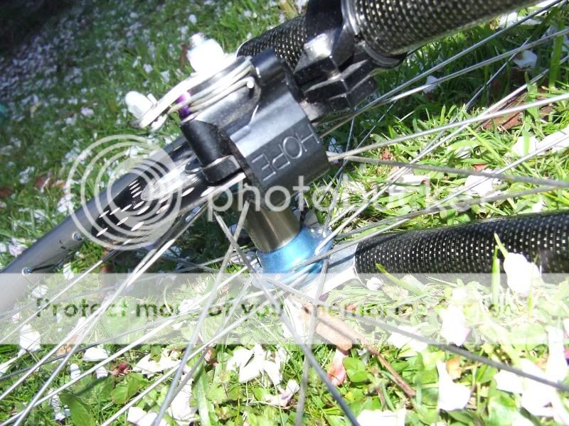

Early (1992?) Hope cable disc brake caliper and hub assembly - still need correct bracket to fit onto RC35 fork leg :wink:

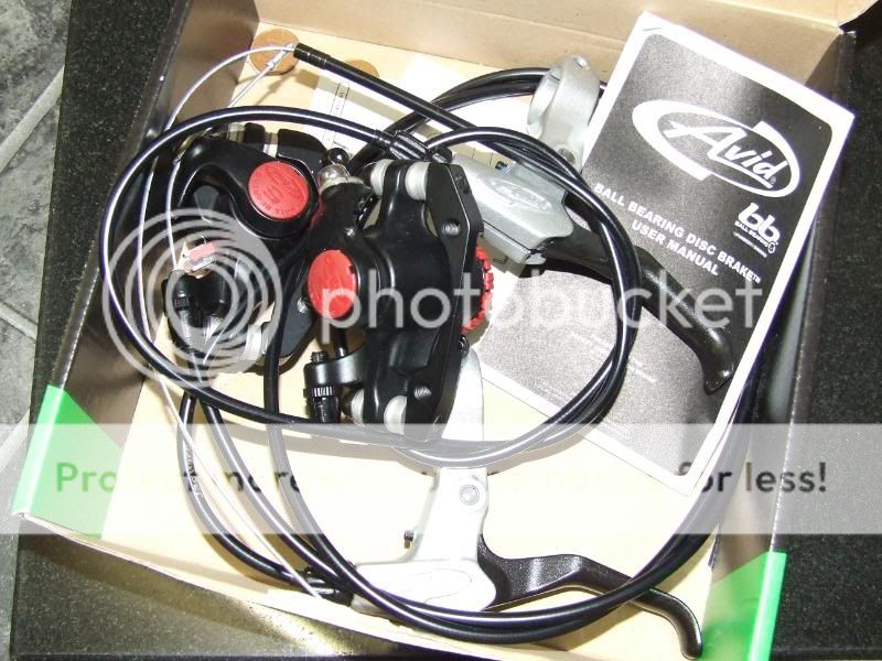

Avid BB5 disc calipers - I may use these if using forks newer than RC35s

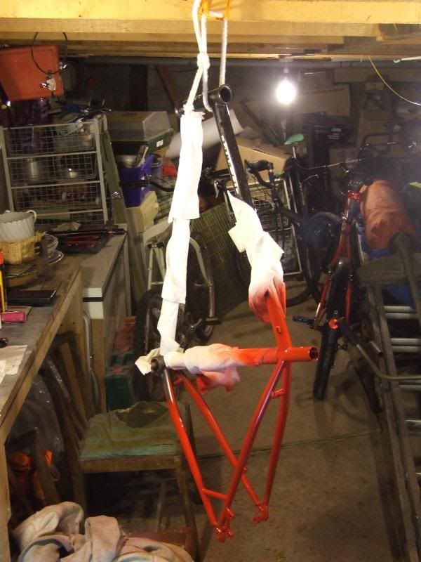

However, as I was preparing parts last month and then passed this lot last week.....
.........I now have a better idea for colour scheme based on the black (burnt) frame :twisted:

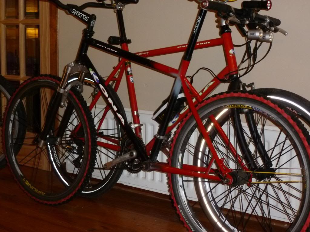

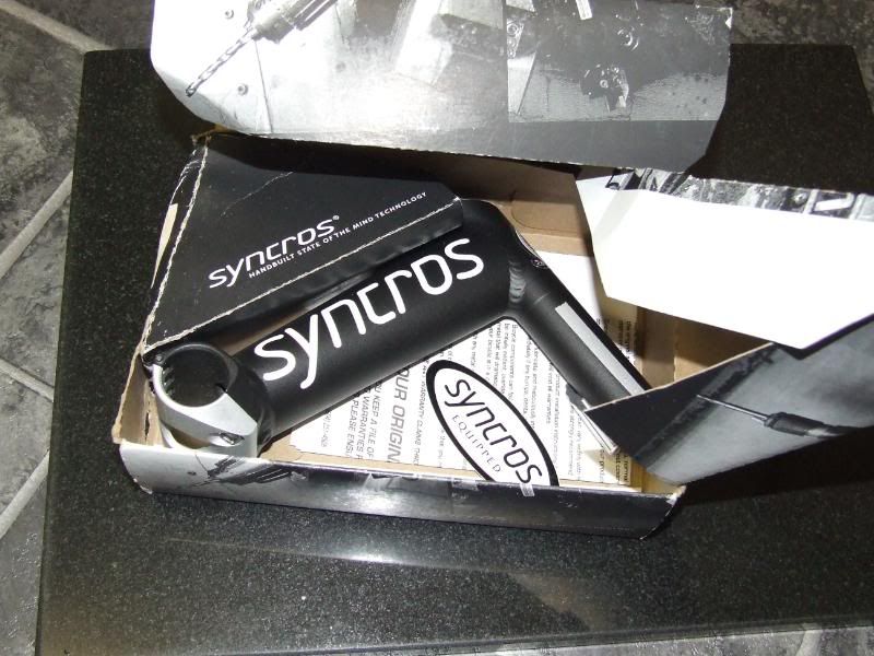

Not sure if I like the Syncros stem - might swap back to Velocity and Kona seatpost :|
Stem looks awfy bulky in the flesh :|
Paint not finished yet :lol:
