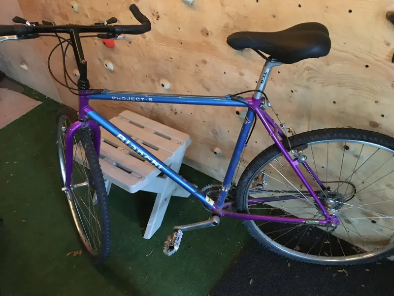

Here is mine as specced when I got it. It was full Deore DX, 7 speed, with thumbies and cantis, but 700 wheels, 1” threaded fork and Ritchey Logic headset. It had been well maintained, and other that the newer Bontrager tires, everything seemed mostly original: 6F126130-A335-4369-A8DB-89266563DF32.jpeg

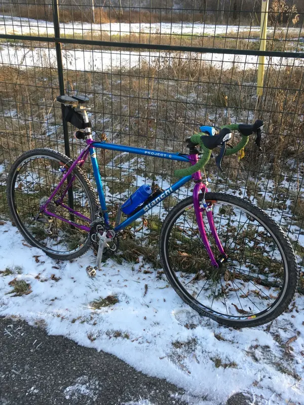

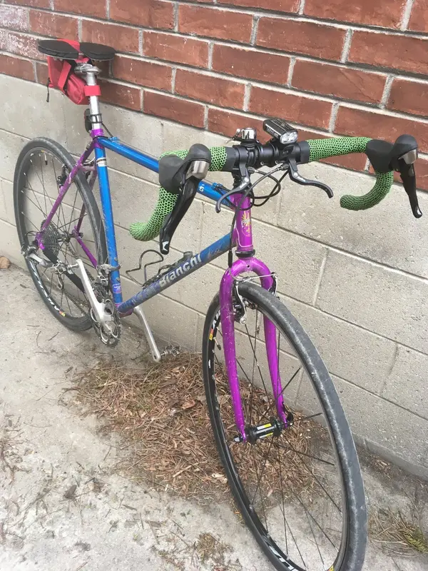

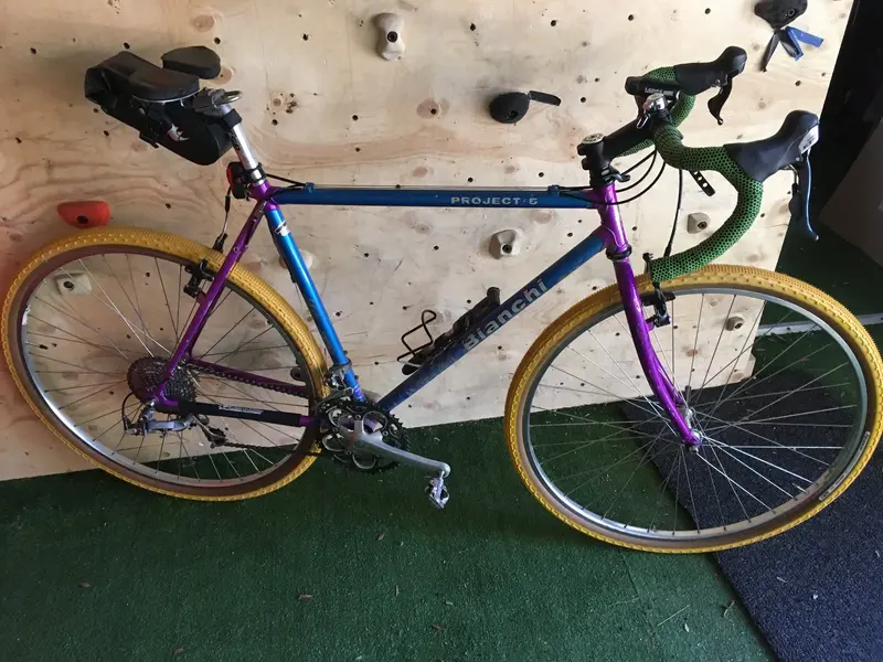

I built it up using older Shimano 105 5700 shifters, Easton flare bars, found a pair of Mavic Aksiums for wheels. Went to a road gearing with a 50-34 front, took off the small inner ring for now and reused the DX cranks. I used an XTR rapid rise 951 for the rear with a 10 speed XT cassette, which works well with the road STI’s and a top pull CX70 front derailleur. I reused old Marin Lite cantis I had kicking in my parts bin.
Final pics...wasn’t happy with the braking power of the cantis so upgraded to TRP 8.4 v-brakes, and holy hell do those stop! Very happy with the braking now. I found some nice Rivendell Jack Brown 33mm tires to put on the Aksiums as my road wheels.
I wanted re-use the DX wheels as a spare gravel set since the rims were wider. I had to swap the old 7-speed freehub to an 8-speed so I could run a 10-speed cassette on it, and got my local shop to reddish the wheel. But I can now swap freely between wheel sets, with only a few twists of the inline brake adjusters!
Here it is running Gravel King 42’s

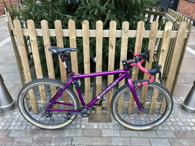

Approval. I built something similar at the beginning of lockdown. Needed something I could do a bit more exploring on but needed to still be capable on-road, so I was reluctant to go full mtb and didn’t really need suspension or anything. I put a mix of 10-speed 105 5700 and cantis on my early 90s Rudy Project. Done a few thousand miles now in this setup commuting, exploring with child seat on the back and weekend road rides with zero worries about the state of the road. Thought I’d post since I’ve seen quite a few bikes built like this while out and about, so a lot of people are having the same idea.
