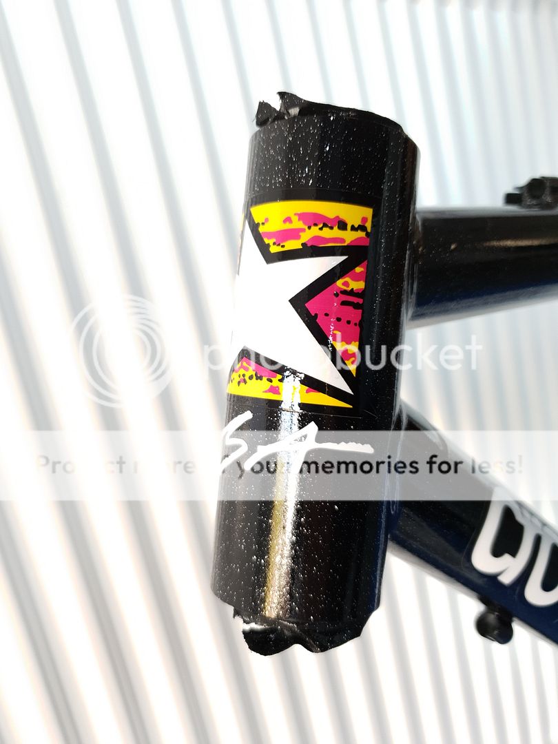

This initial strip revealed a crack at the base of the seat tube slot. Not a big issue with steel so I stop drilled the ends and had it tig welded. I elected not the grind the weld flat as it isn't in the way or particularly unsightly. Probably stronger like this too.
Other than that and a couple of small dents the frame looks to be in fine fettle.
Some interesting BB scars...

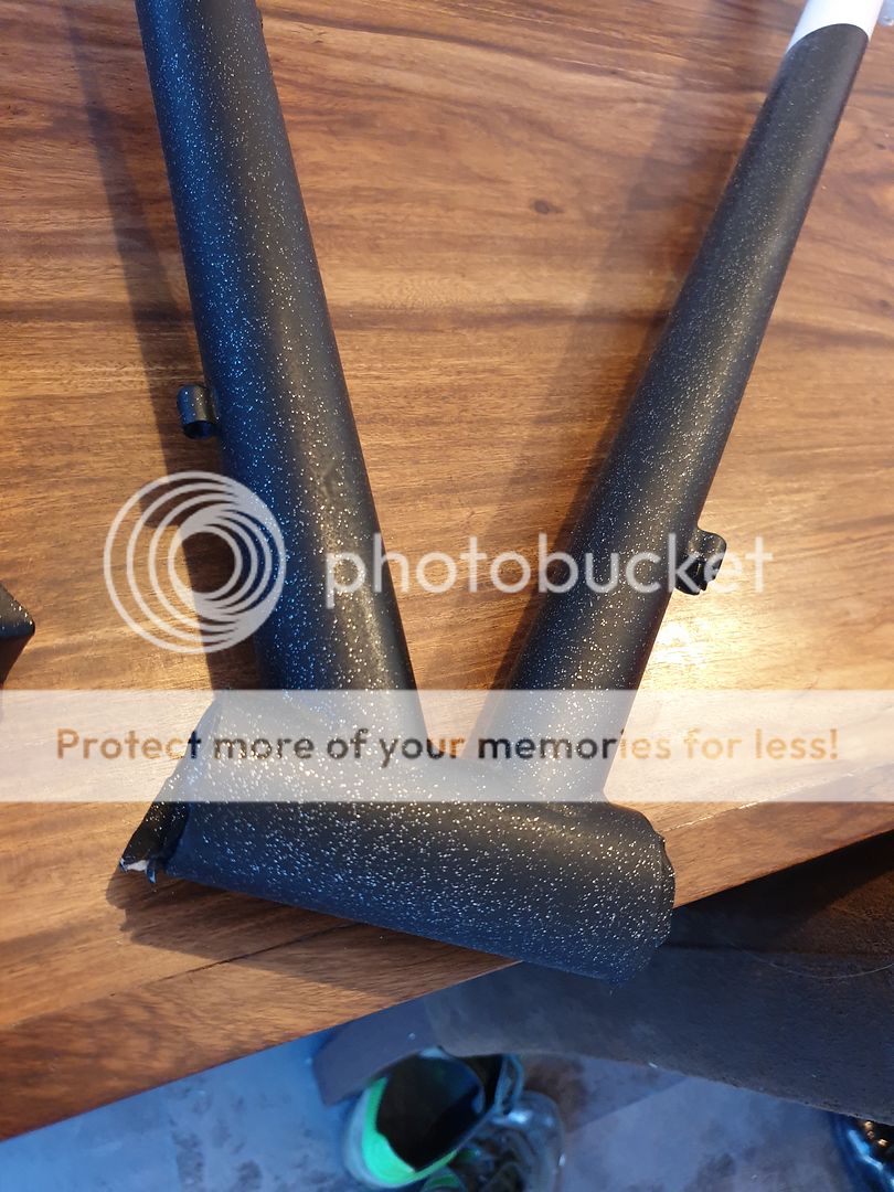

Forks

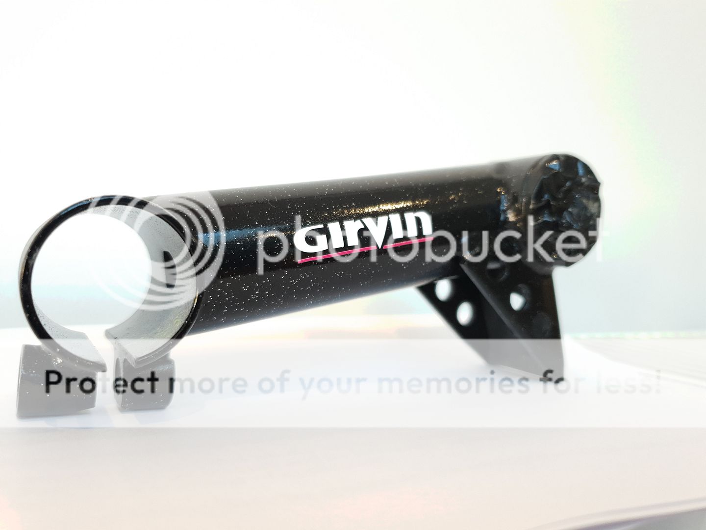

Stem (was fluorescent yellow....)

Are these frames renown for this or the result of a previous owner not having sufficiant seat post inside the frame, stressing the area. there doesn't appear to be much space for a long seat post !?
Not that I am aware of. There certainly isn't a lot of room to put a long post in, indeed, the post that came with it has been cut quite short but still appeared to be inserted down to the kink.
I think that either a post has been used far too high or, more likely looking at the scars on the back of the seat tube, someone had a stuck post and levered the split open in an effort to free it up....

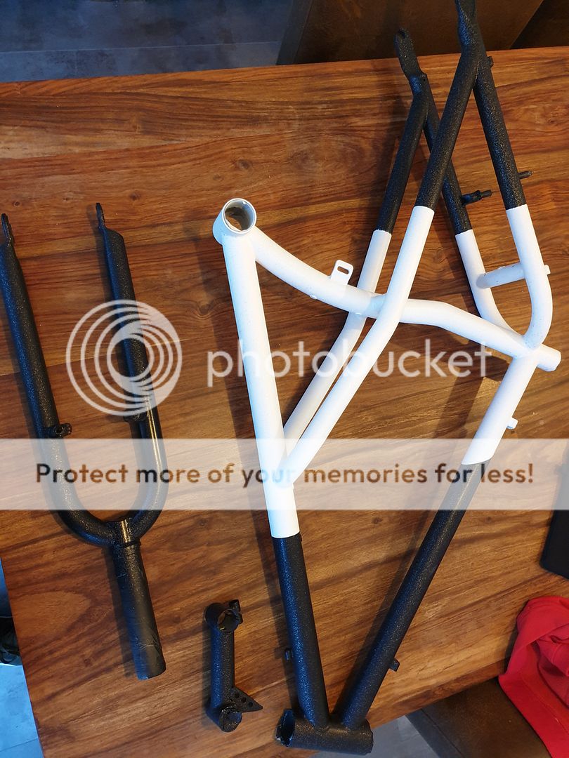

Some progress....

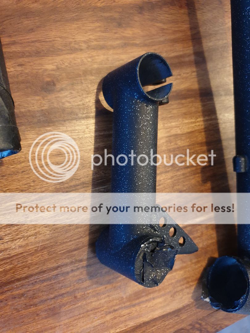

Forks and stem painted in gunmetal. It certainly looks darker than I expected but I imagine once lacquered and in the sunshine it should look a bit less black. The original colour, for bikes in the paint scheme I am using, was a plain grey.
Frame primed and the centre sections painted in a white topcoat. Front and rear end to be Gunmetal once this layer has dried and I work out the positions of the decals that cover the colour change.
Not the prettiest original welds...
The "dodgy" clamp area...

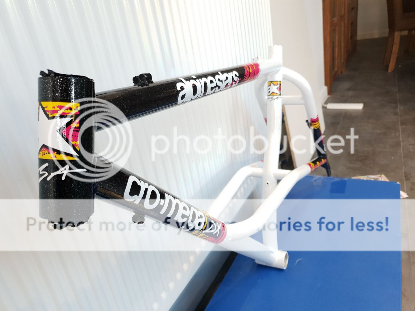

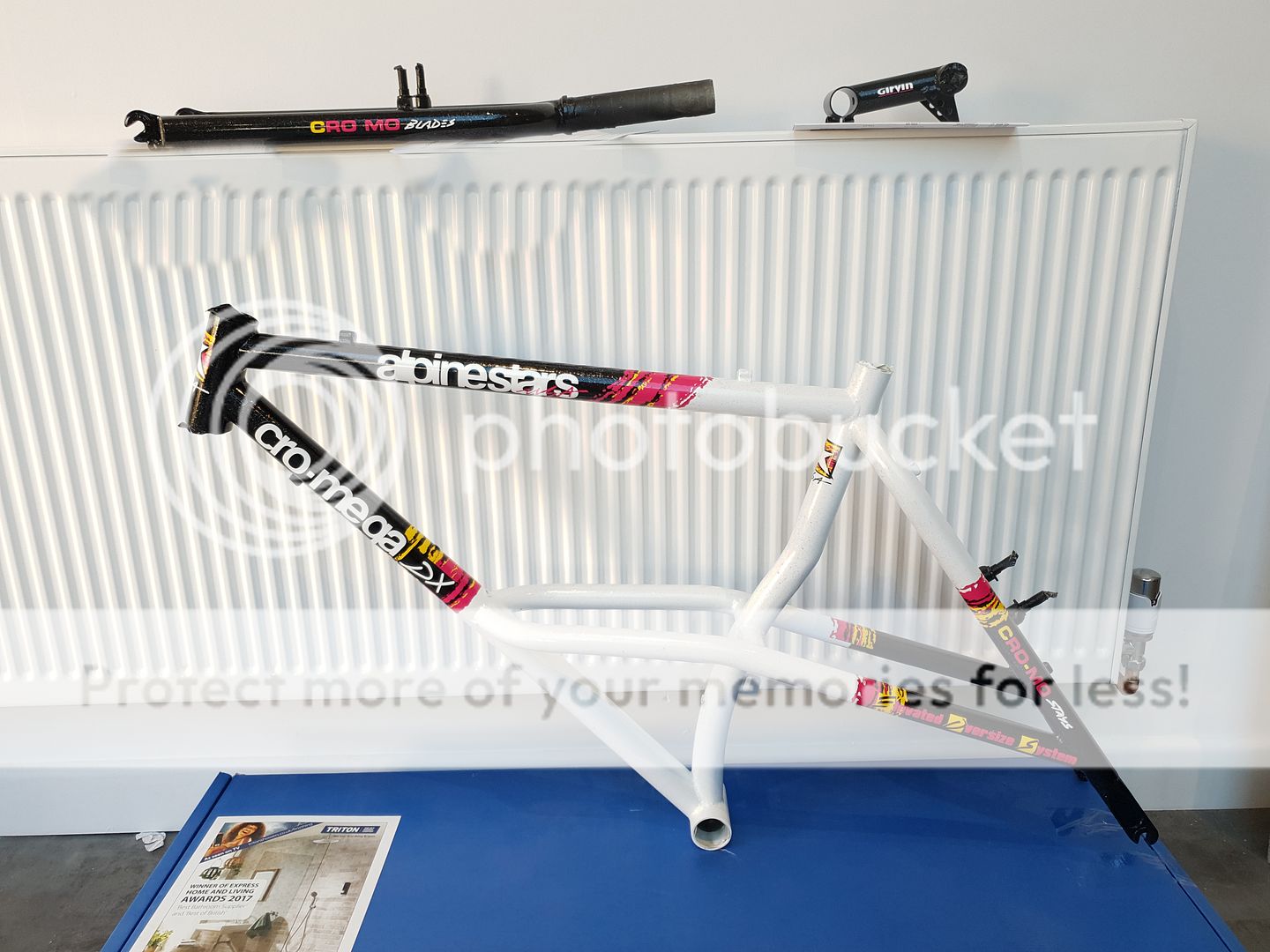

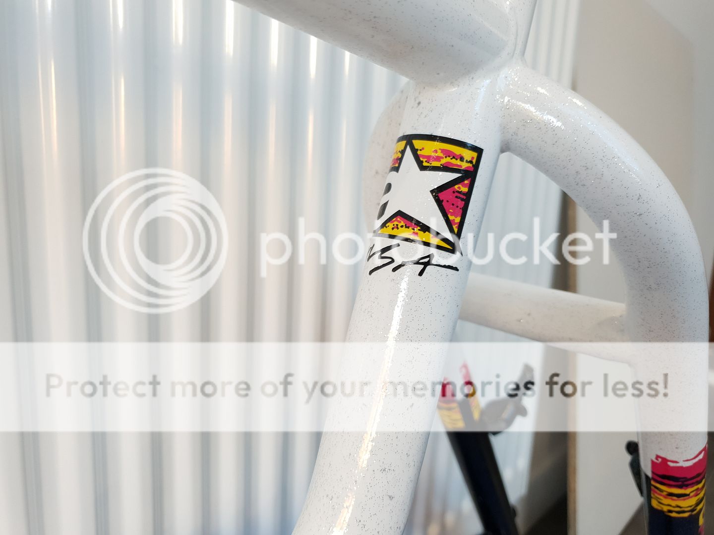

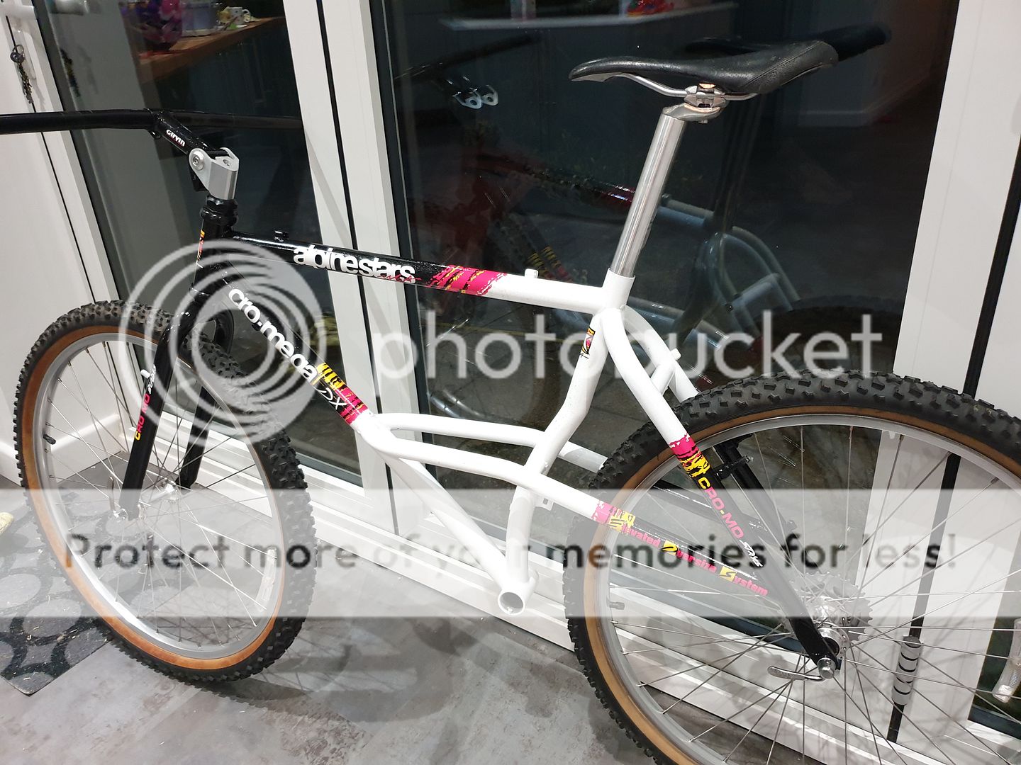

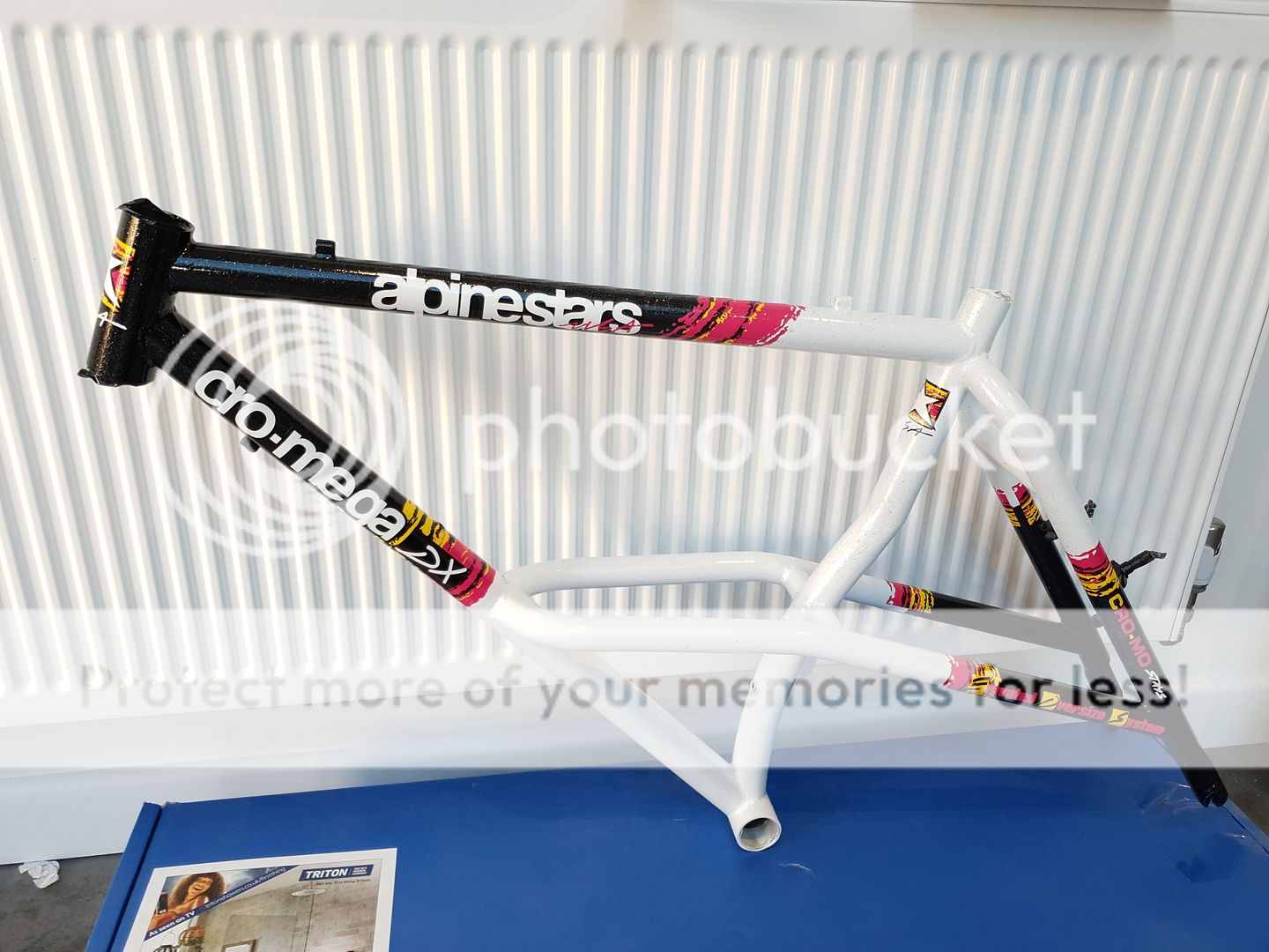

Well, after painting the stem and forks I was rather compelled to use the same colour for the frame accents. The grey (black) went on nicely but even in bright light it was still rather dark.
What to do.......GLITTER!!!
I wasn't completely convinced but went ahead and stickered her up, courtesy of Gil_M and Retrodecals. Great quality decals and a top bloke to boot.
Followed up by the first of many coats of lacquer and dare I say I am quite pleased with how it turned out! I can't wait get her all polished up and built up with the kit from the Black Panther.

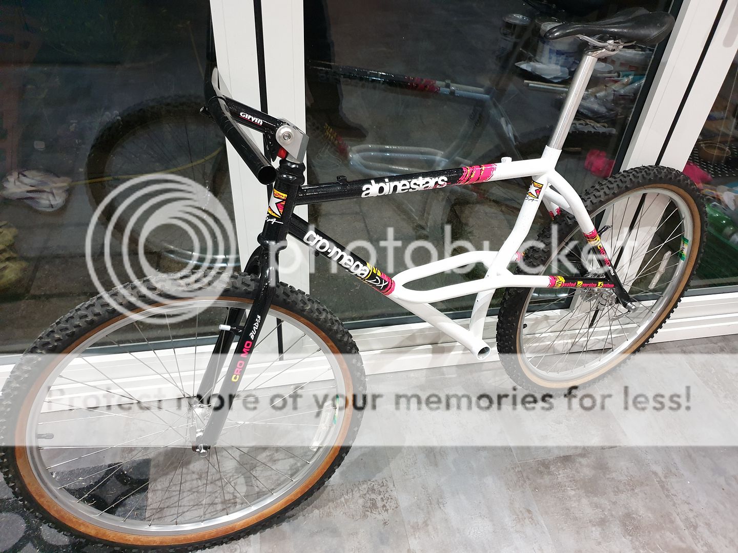

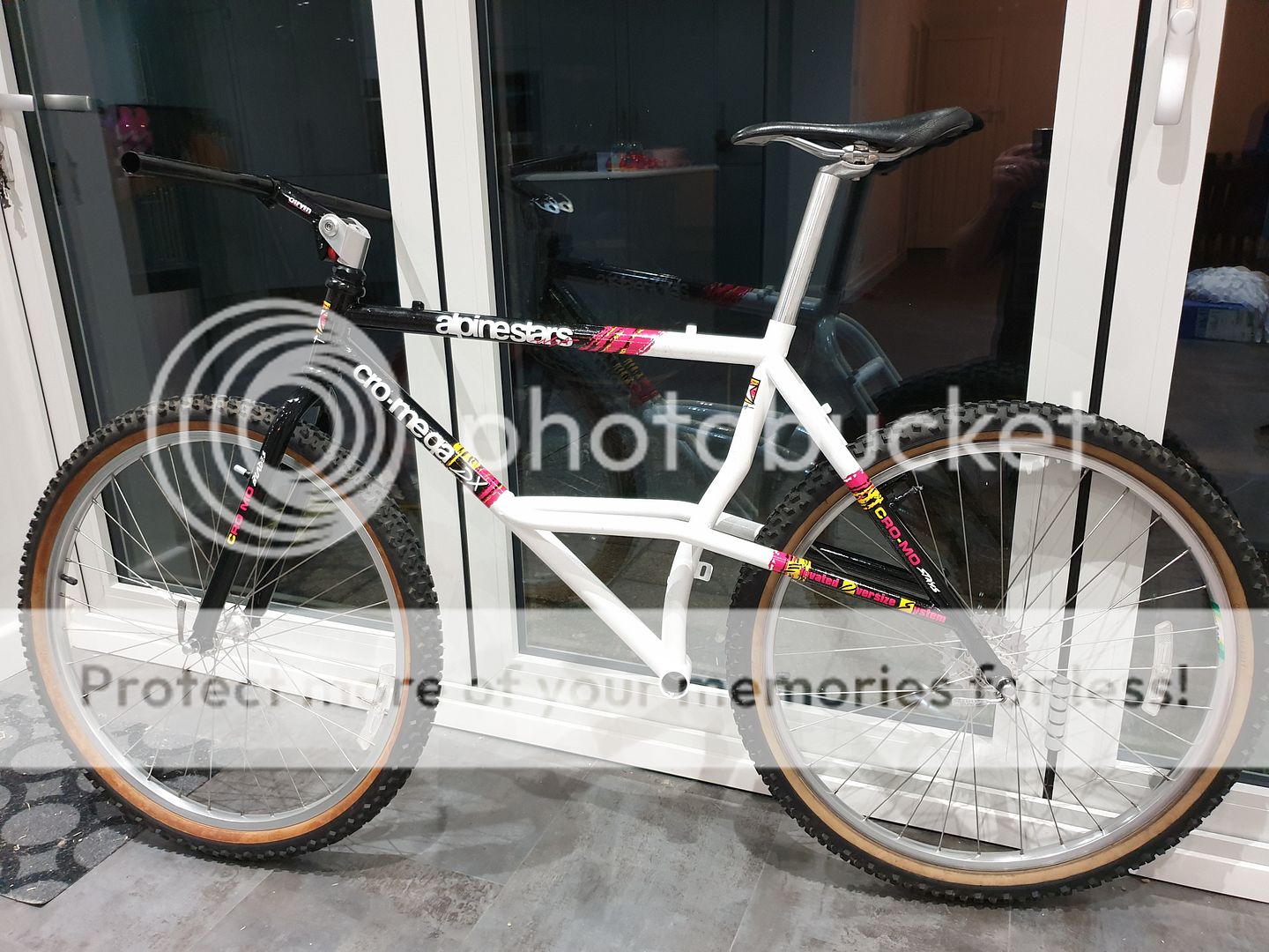

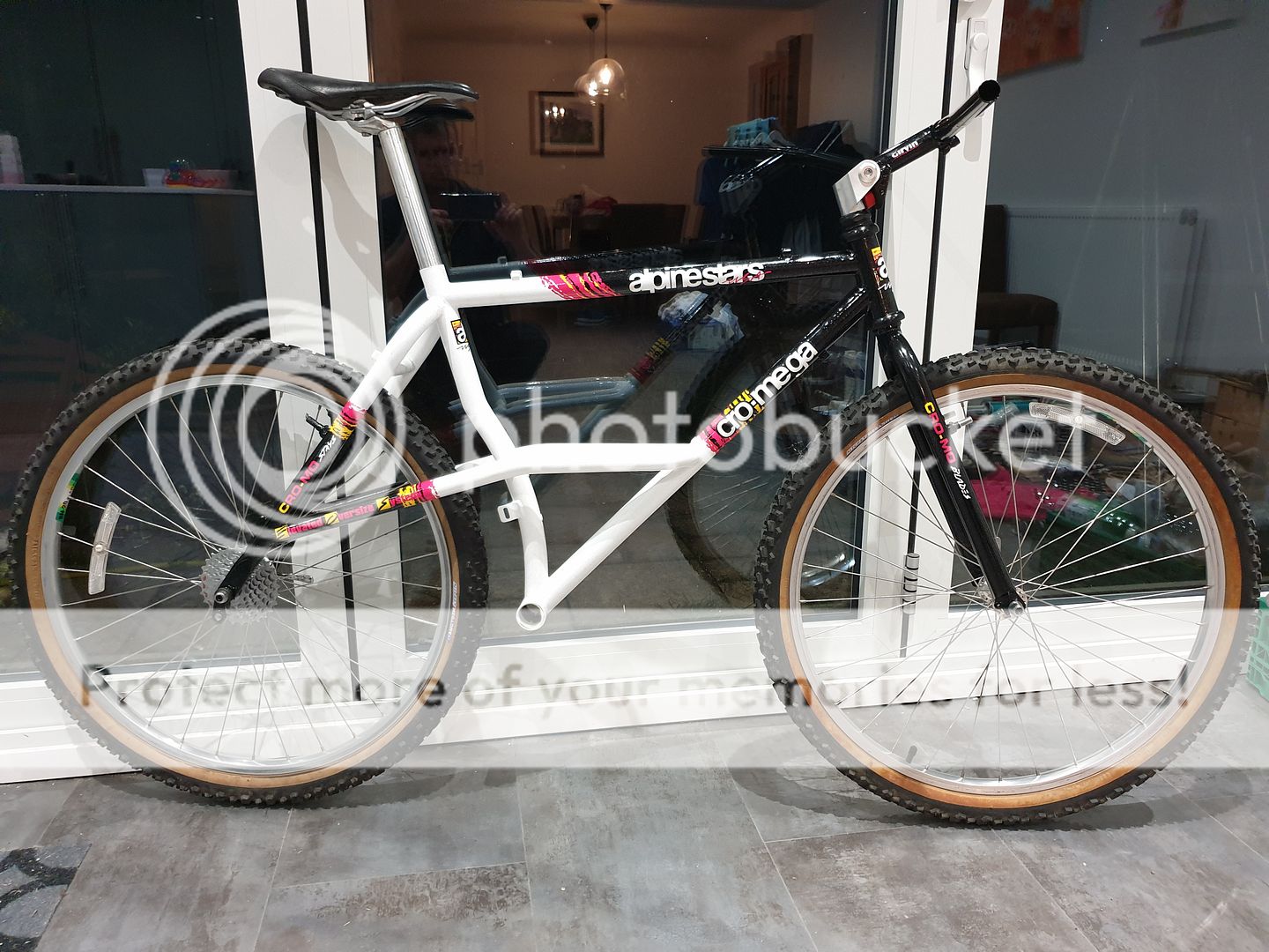

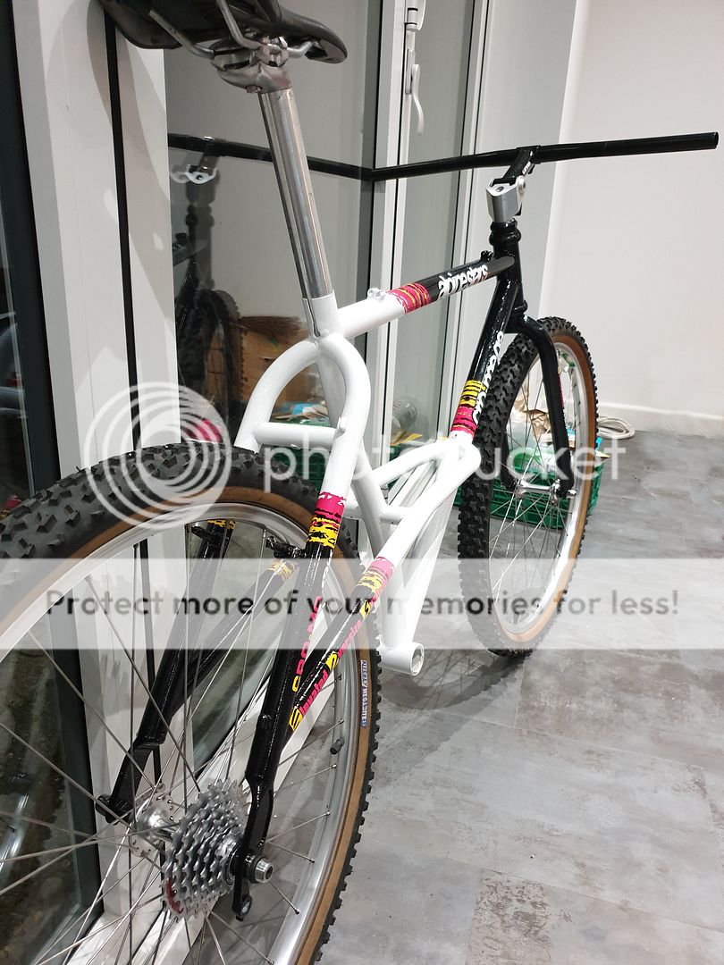

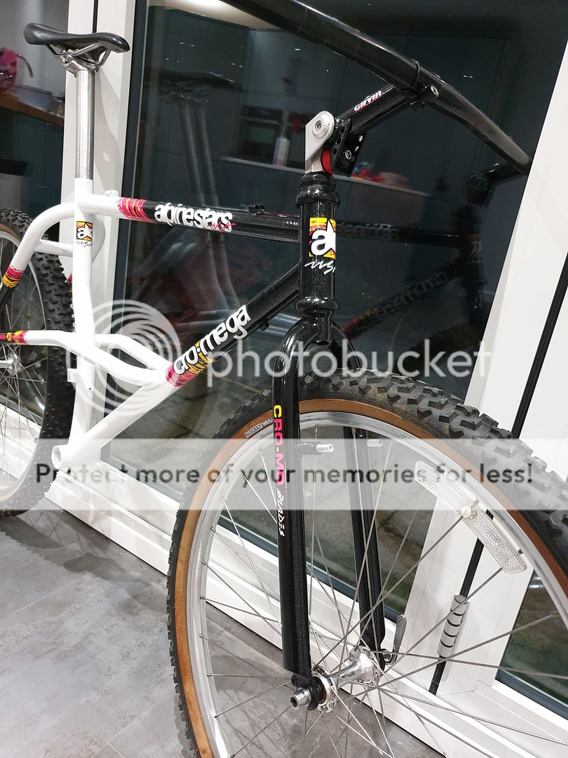

Anyway, some more with a quick mock up. Must find the correct post, seat and bars, anyone?
Great work, brave move on the glitter
What’s the elastomer like in your flexstem, I’ve got new spares if you get stuck,
Admittedly I’ve only got firm black and soft violet (no red ones)
