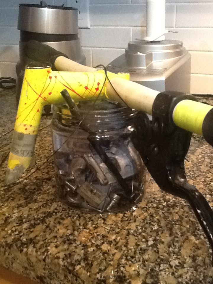

A small update. I am giving the little bits and pieces an oxalic acid bath. The screws had some rust and a few other parts were marred by the brown stuff. This should clean it up. I may get some replacement limit screws as they are starting to strip. Sorry for the bad iPad photos.

The oxalic acid bath worked...ok. It tidied up a couple pieces but nothing magical. I used steel wool to scrape away what I could after the bath but I think that is going to be all she wrote for that cleaning angle.
