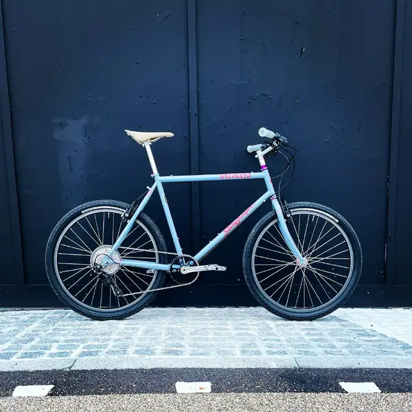

1991 Stumpjumper Comp, NOS Frame & Fork

Think i have a frame like that in the shed. Its been rough powdercoated with specialized transfers. it has the same dropouts, stay design, seat collar and cable hanger. No forks unfortunately, so it sits unused Mine is a 1 inch head tube. What's yours head tube dia?

That'll be 1" I'm sure. Specialized were a bit late to the party with 1 1/8" iirc
It's got a 1" head tube, but it was JIS-sized from the factory, making headset choice very difficult as the fork crown seat is ISO-sized. I had the head tube reamed to ISO inner diameter so that I could use a standard CK 1" headset and crown race.

this is so good mate, nice one!!
