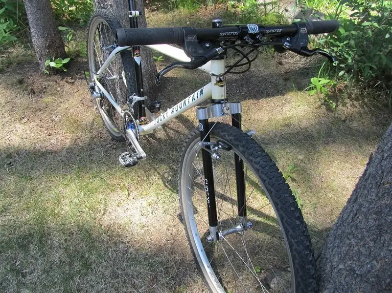

So, here's an update:
The bike is near complete, with just a few small changes and touch ups needed.
I found a set of 2 finger lever / Rapid Fire XT shifters, so ended up putting these on instead of the thumbies. I've got the thumbshifters on my 89 and 92 Blizzard and T-Bolt, so I ended up going with rapid fire XT since I wanted this one to be different and a be bit better for off-road.
I recently found an old Syncros post 8) , 737 pedals, and some ODI grips to use.
The only thing I need to change is the BB to a shorter one. I might put on a short cage XT RD and I also have a set of black rims on old XT hubs that I might try out to see how they will look. And if I find an older Syncros bar, I'll swap it onto this bike as well. But really, I'm happy with how it's come together and lucky to find almost all the parts I was after.
