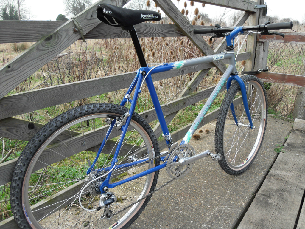

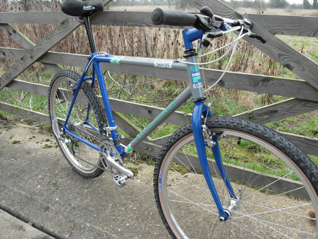

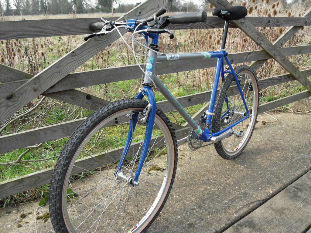

These were offered as framesets and complete bikes. I have more-or-less nailed the original spec. XT components with DX hubs and Araya rims. Finally finished the cabling tonight so will take some nice pics over the weekend and show it off in all its glory.
Super nice! I keep coming back for another look.
Picture Heavy

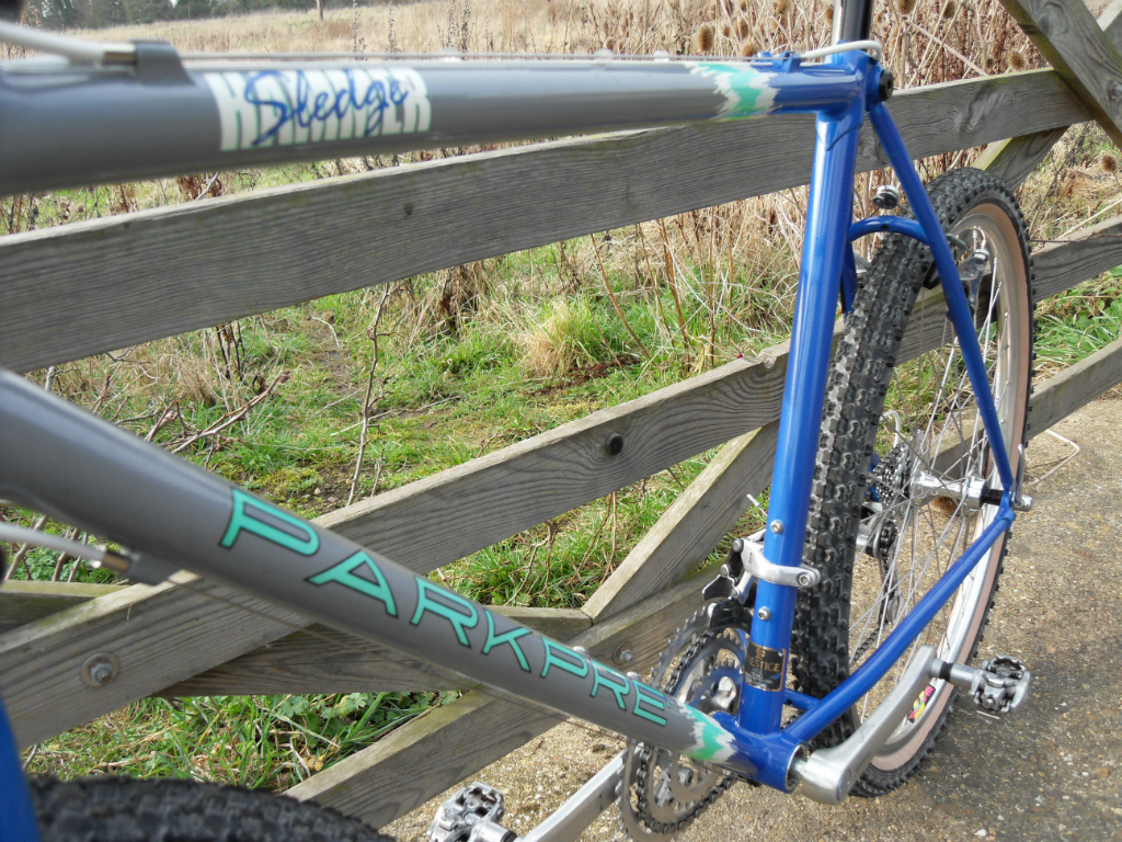

Frame: Parkpre Sledgehammer 20" - Tange Prestige double butted
Fork: Chromo butted
Headset: Shimano XT 1 1/8"
Stem: Velocity

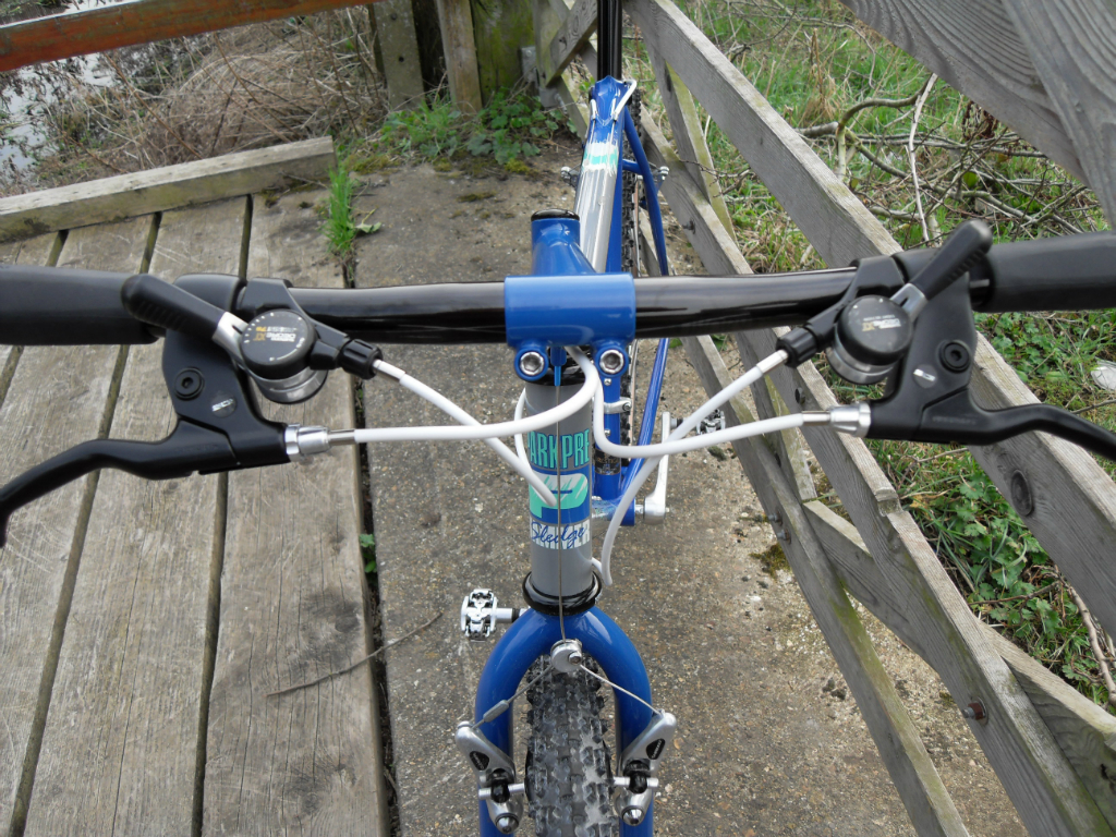

Handlebar: Kalloy
Grips: Ritchey Trugrips

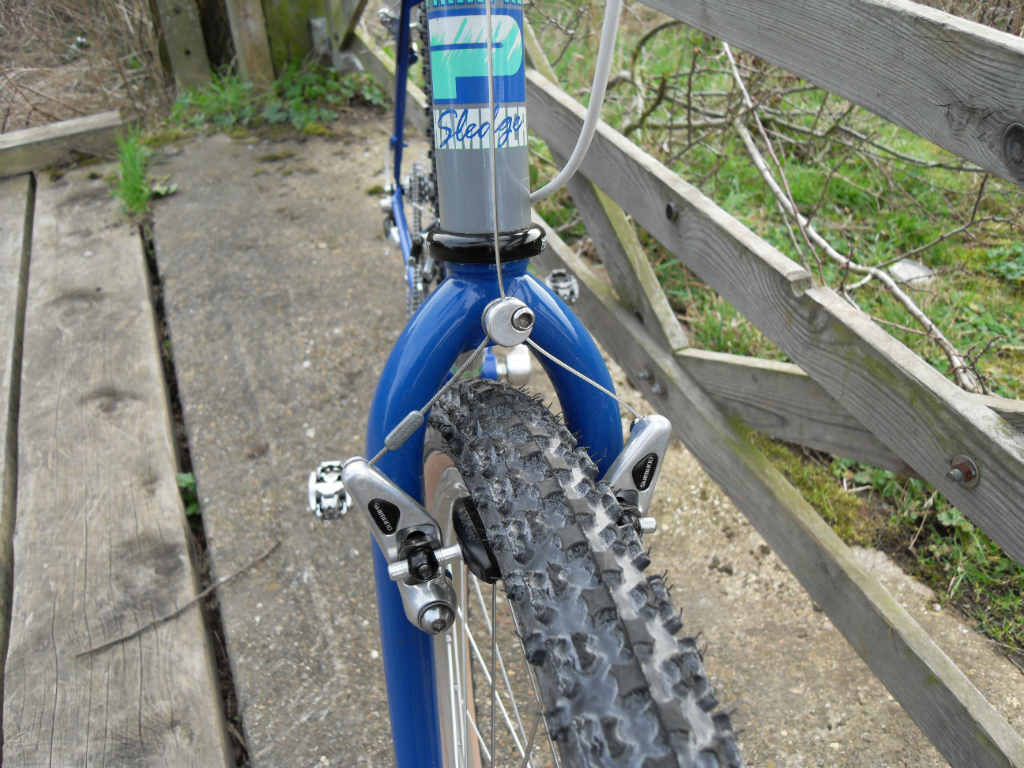

Brakes: Shimano XT M734
Brake Pads: Koolstop
Brake Cables: Clarks White
Cantilever cable hangers: Shimano
Brake Levers: Shimano XT M733
Shifters: Shimano XT thumbshifters

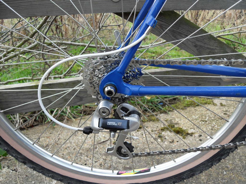

Front Derailleur: Shimano XT M735
Rear Derailleur: Shimano XT M735
Derailleur Cables: Clarks White
Cassette: 12-28 7 speed
Chain: KMC X8
Cranks: Shimano XT
Crank Bolts: Shimano
Chainrings: Shimano Biopace 48-38-28
Chainring bolts: Shimano
Bottom Bracket: Shimano UN71 122.5x68mm
Pedals: VP-104
Hub Skewers: Shimano DX
Rims: Araya RM-17
Hubs: Shimano DX
Nipples: Brass
Spokes: Stainless
Tyres: Ritchey Duro Force 2.0
Tubes: Schrader valve
Saddle: Avocet Racing II
Seatpost: Kalloy 26.6mm
Seatpost Binder: original
poweredbypies":242jeovt said:
Love how they route the rear brake cable through the post clamp area, sheer class.
Gorgeous build!
I can see where Jamis got the inspiration for the routing on my old Dragon now...
The two frames share some other similarities too.
