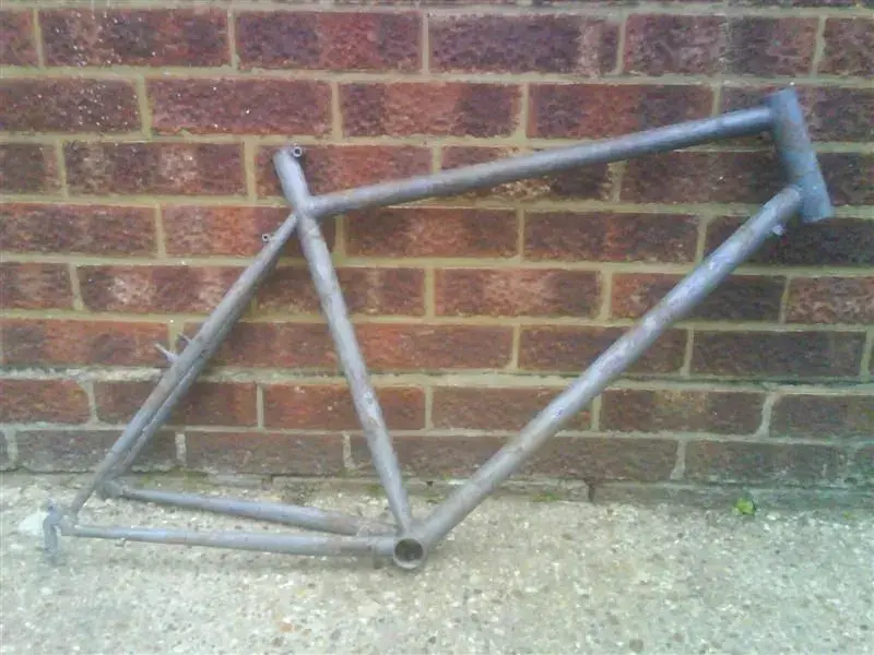

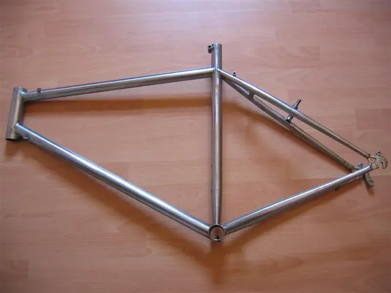

First off the removal of the paint, clean up the metal in preparation for painting. To keep costs down and for my own personal satisfaction I wanted to do the work myself. The frame itself under the paint was hole free from rust, these frames have quite thick tubes! I got the threads recut and cleaned at the LBS.

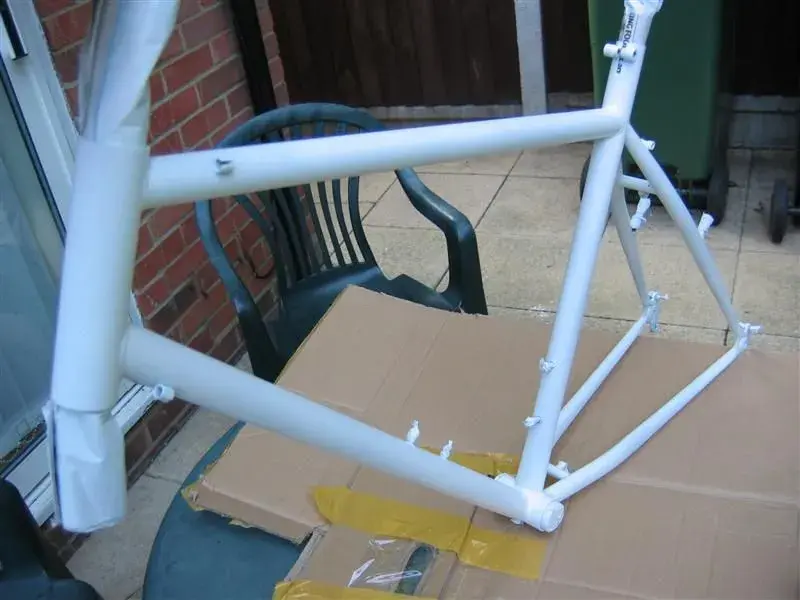

Next up priming and colour. Now I know that there are a fair number of white Konas around and this colour does make the frame look fresh and is probably not the most practical colour for a bike for off roading. But I thought I will give it a go as I had something different lined up for the decals.
I opted for rattle can domestic appliance paint that seems to be relatively hard wearing. If I enjoy the bike and use it more often I will probably get it resprayed in epoxy paint by a finishing company when funds permit. Six coats of top colour and three coats of primer were applied.

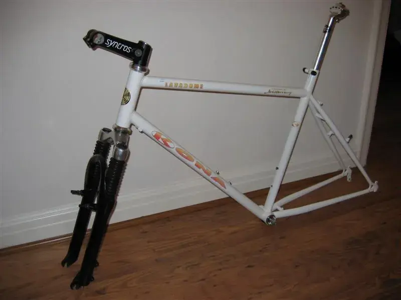

So on to the home straight. I had an idea that I wanted a sunset finish to the decals on the white frame. Decals were produced and applied then frame was laquered a few times. Frame now ready for building!

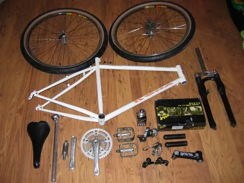

Let the build commence!

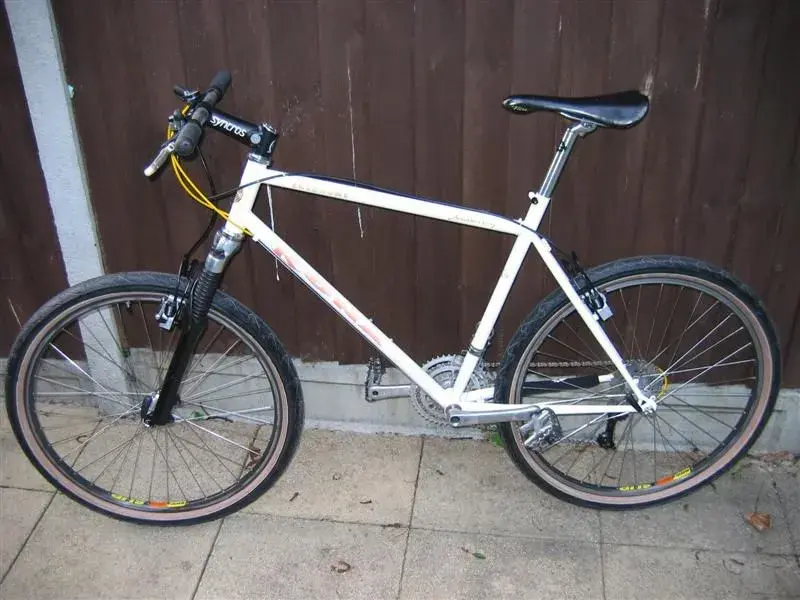

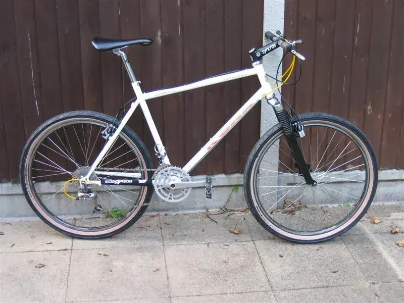

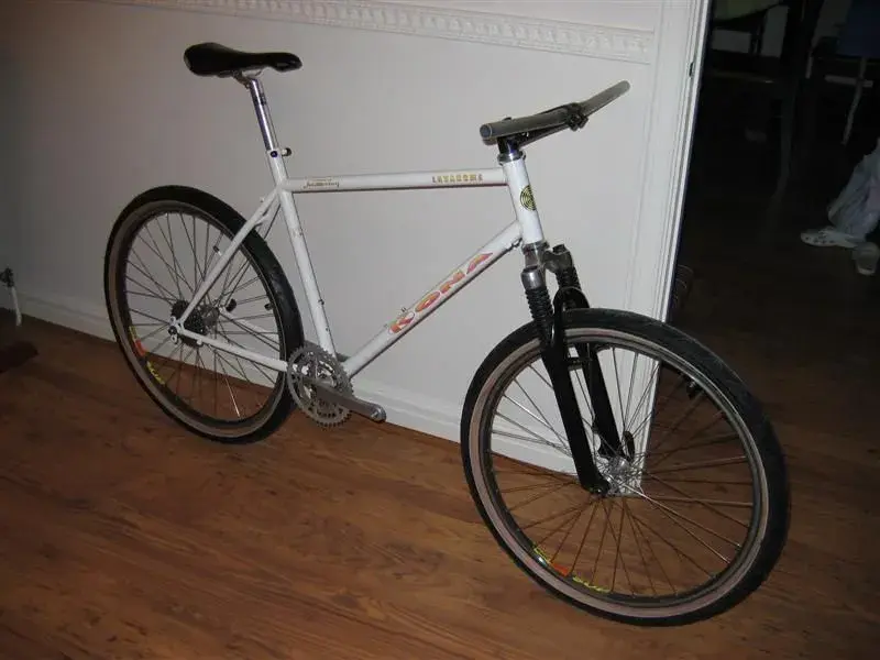

Ta-daa! :D

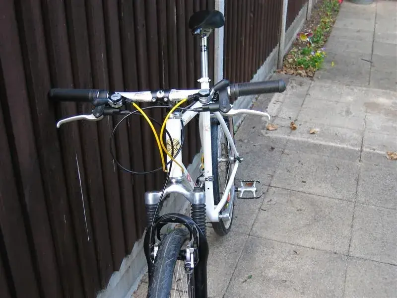

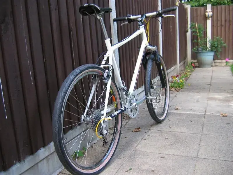

The handling with the forks isn't too bad and better than I thought it would be. It's a little on the quick responsive side but with the more laid back feel when in the saddle this seems to suit me more than the old days of a head down low profile feel.
I do have some P2's that are designed for this frame that I will probably put on later on but for now I will enjoy it as it is. :)
