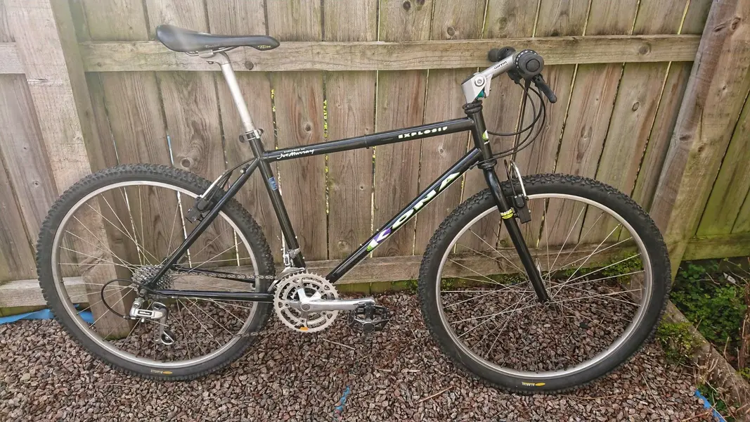

So over the last few days I've got the Explosif ready to ride.

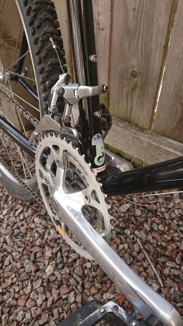

Unfortunately today's test ride was curtailed by the dreaded skipping chain on the cassette :facepalm:
Both are previously used, the Cassette "looks" OK to my eyes, so I'll change the chain and try again :lol:
Don't mind the cable ties :lol: I've some stick on cable guides to fit :wink:

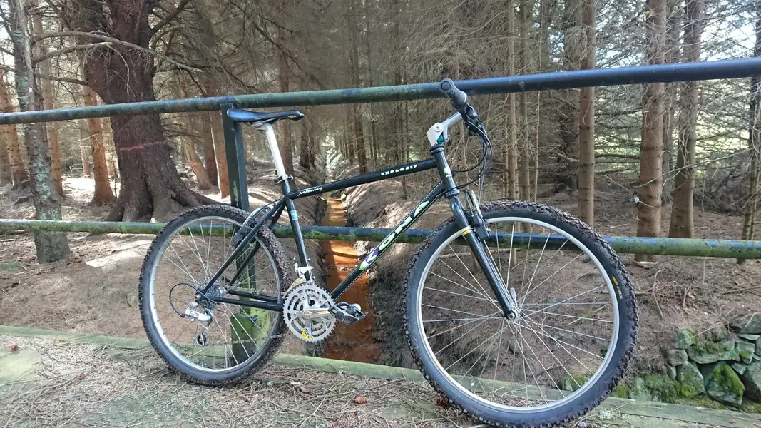

So, it was actually the chainring that was causing the slippage, middle ring too worn out to handle a different chain.
Fortunately I had another MT-60 Deore chainset so I a quick change and all is well.
Went for a quick ride in the local woods today, whilst it's no lightweight I could tell straight away that it just felt a much better ride than the Fire Mountain it replaced.
The Flexstem is actually OK, trails were pretty dry and running fast today, it definately took the sting out of some of the rooty sections. :)
