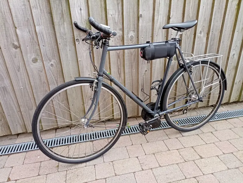

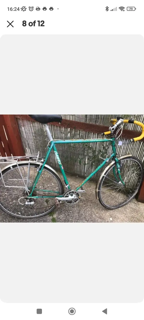

Picked this up locally rusted up.
Got lucky as inside the tubes is perfect, just surface rust lifted the paint.
Came to me with all original kit, Deore DX and RX100.

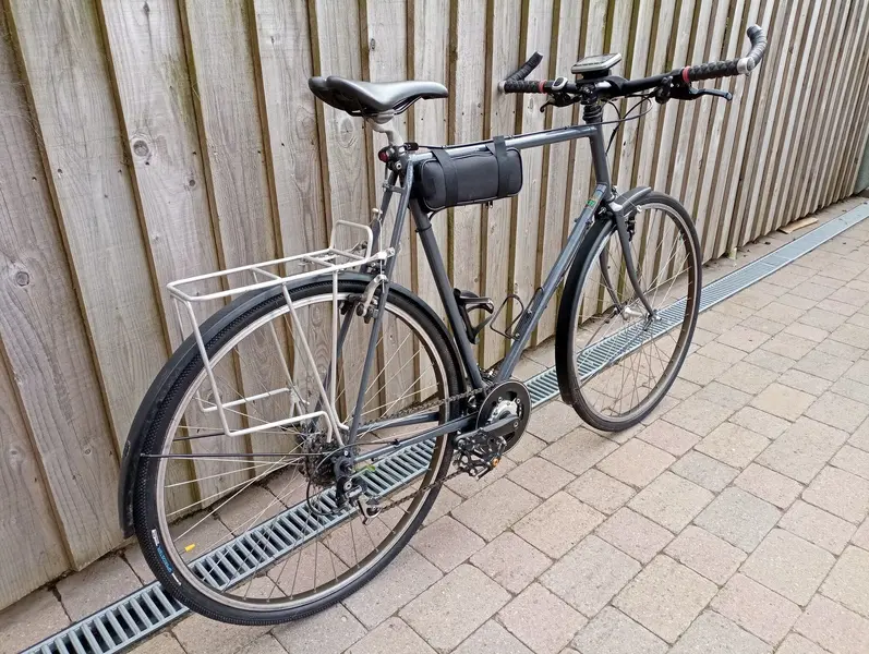

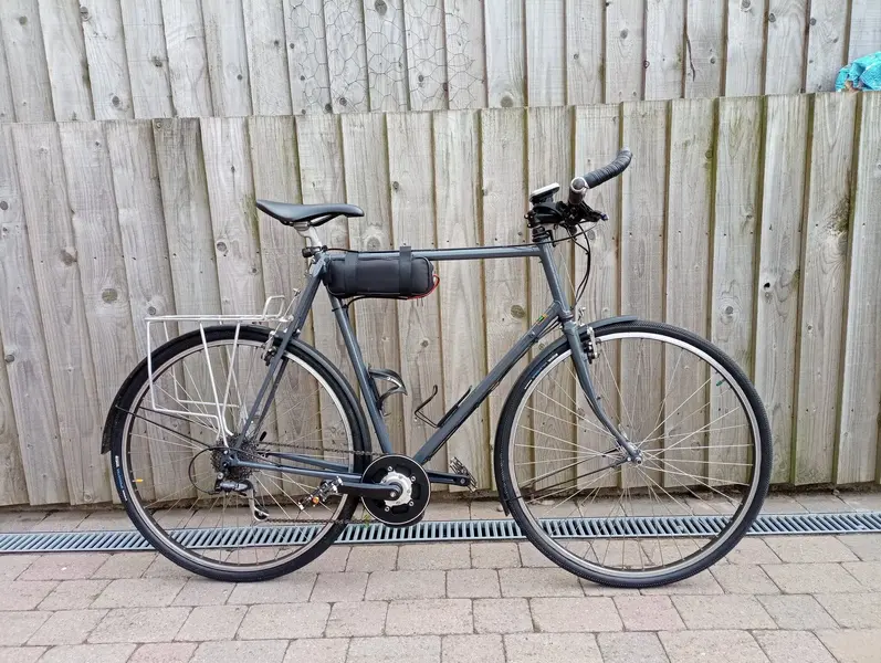

Flat bar converted with period XT STI.

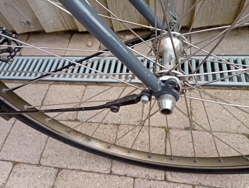

250W TSDZ2 mid mount torque sensing motor. These are really superb. Gets me to work and back on Turbo also putting significant effort in at an average of 18mph. This TSDZ2 has no drag when turned off so can choose to get a bigger workout.
