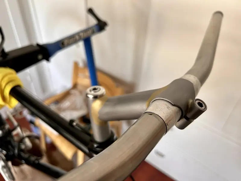

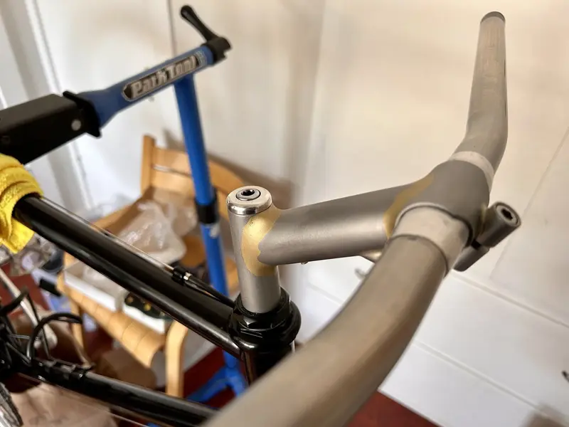

So, I decided the custom ICR stem Paul made for me would go on the bike unpainted for a while, and also on its longterm form:
I'm going to send it to either D&D or Joe Bell to be repainted a close as match as possible to the original "Light Violet Metallic" Tim ordered the bike in, as a little callback to it's original form.
For now: I'm not mad about staring at those welds while I ride!

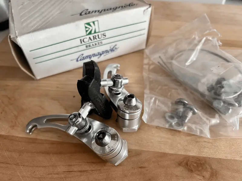

Seeing as it was out with the old, in with the new in the rear, and because I'm a complex contrarian, I decided I'd replace the newer Paul Touring Canti on the front with a bargain that had fallen into my lap via one of the vintage Facebook groups:
I'd always wanted to try these, and if there's a bike that's suitable for just a single, shiny silver cantilever it's this one! I also figured the cut-out design would fit nicely with the rest of the holey-ish build.
Pads were changed to Kool Stop Thinlines before install and I had fun trying to set them up using both the Hunter Nug and the lovely little proprietary Campy end on the straddle cable.

Nice 😎 I was very tempted by those FMC brakes

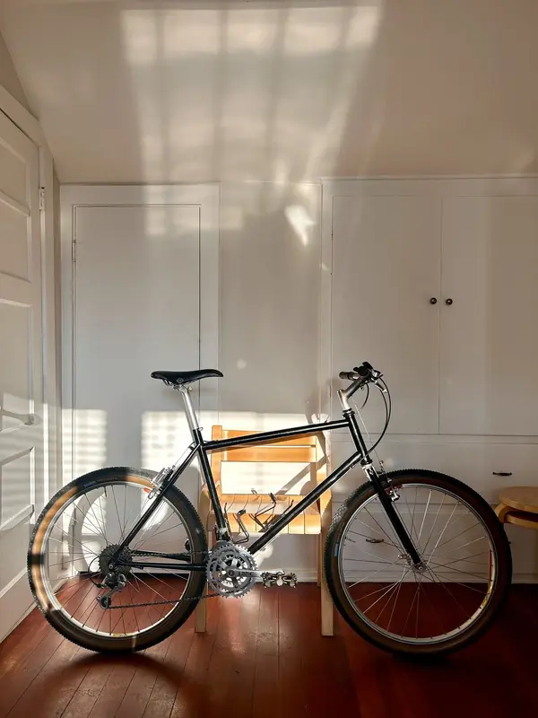

We get some nice light in the kitchen at the end of the day...
Sorry about that tire logo orientation ;)
I forgot to say I went back to the Humptulip Ridge for tires, too. I just didn't get on with those Ultradynamico's and I personally think the profile and ride quality of the Renne Herse is far superior.
The italians never disapoint when it comes to luxurious styling. I love Campagnolo. The rear brake is not bad ;) (best rim braking ever)
