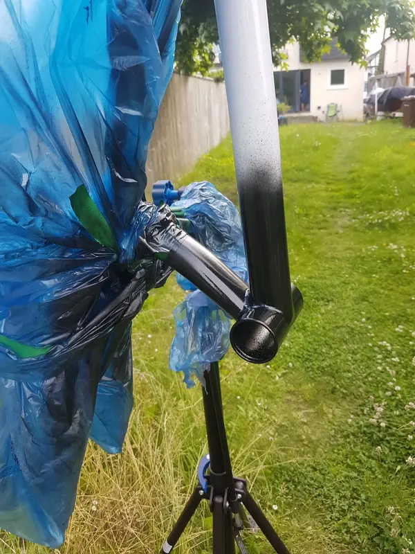

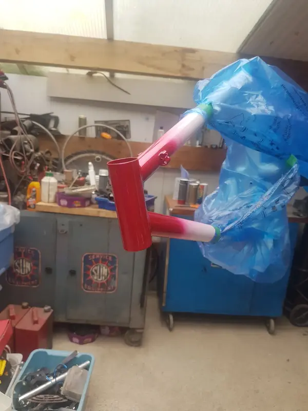

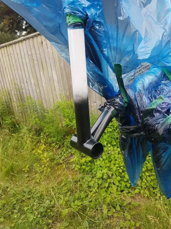

Also having a nightmare getting metallic spray paint to finish the paint job, that was supposed to be the easiest part , pop over Halfords job jobbed. At the moment i am looking at Deco Colour Metallic sprays any other ideas?

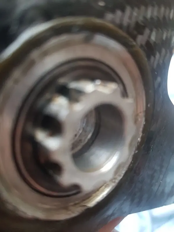

The rear spinergy has lost the freehub thread which is normally game over so a cunning plan. I have drilled the back out to 17mm by 8mm deep
This recess gives me enough room for a 2mm thick top hat retainer for the bolt to lock onto.

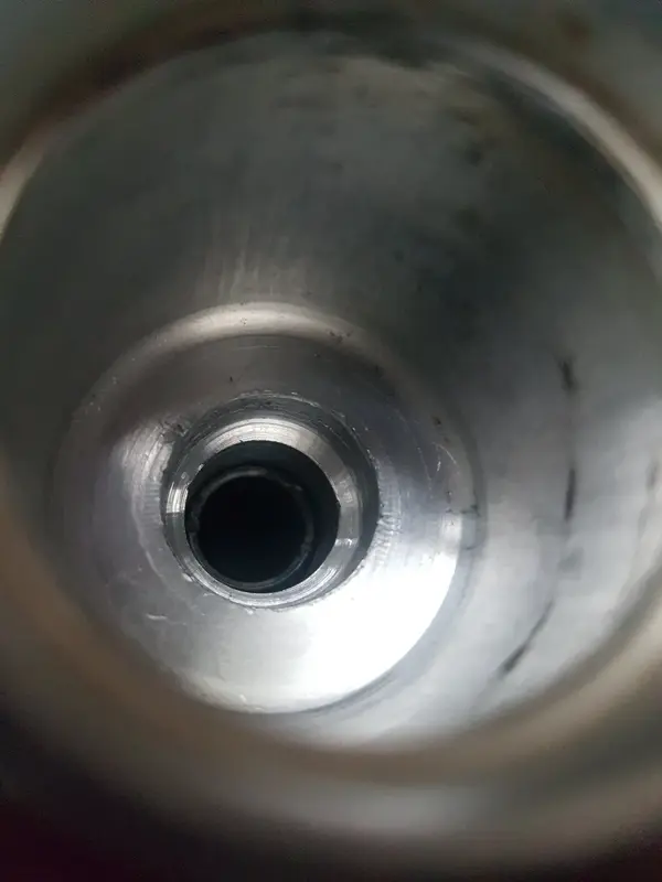

Here you can see around 8mm untouched bore which will hopefully be enough cross section for any load on the end. GA cycles are on.the case for a new bare axle so next job is to make extra long cone nutscso they can be locked out side of the freehub body.
Also gave them a clean.
They will live again!
