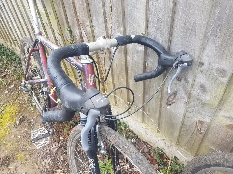

I did a brief intro to this but to recap I had my Stunt Jumper borrowed and my LBS “Coombes Cycles” in Hereford happened to have a frame and fork set ready to go. I have never bought a complete bike and always just built stuff. So this suited me well.
From memory it was second hand at the time but only just and can only have been used for a few months so not sure on its history. Any way I saved some pennies and got the frame set, a pair of Judy Jet C’s with headset adaptors, Cinelli wide bars and a pair of roller cams for the brakes. This was ridden to death for a few years and with minimal changes (Bar ends to flight deck being the most memorable).

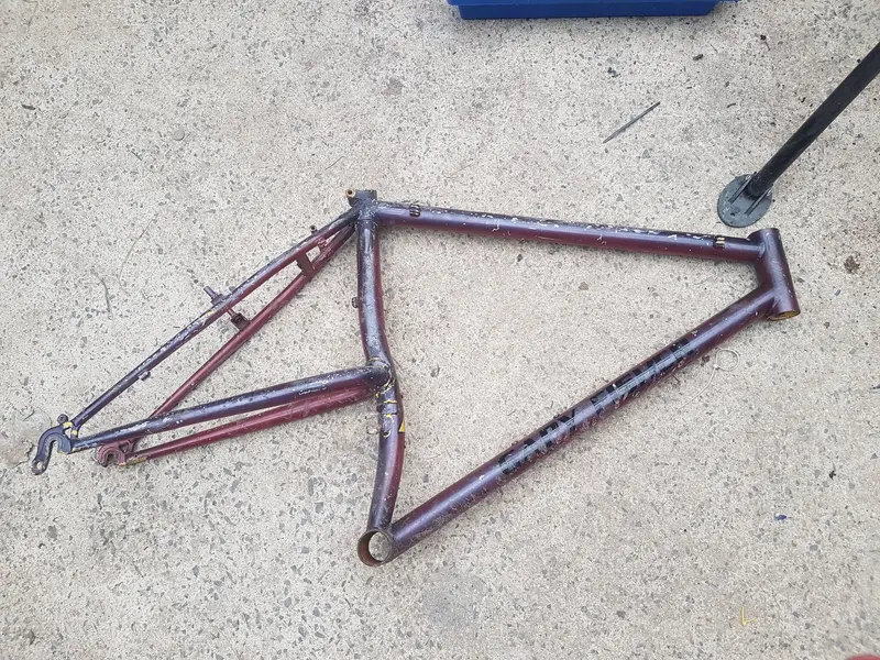

Around 96 I had a moment and lightly kissed the back of a double decker unfortunately the frame and (my face) snapped. So, I contacted Mark at Coombes and by chance they had a frame that had been in their hire fleet and was up for sale so I got this.
I spent a fair bit of time prepping and spraying the frame in two tone purple which you can just make out. On the forks and stem which have not been used since 96.
And then came I to the end of uni and cycling just came to a bit of a stop. I started moving around for work and this came with me but with no love or care. I soon became the rider who used squeaks and creaks to warn others of my arrival.
But over the past few years my son has got into bikes and the time has come to explain how this was in my eyes one of the fore fathers of MTB design ( we will negate the fact they all snapped)
This the old setup as of 2021 when stripped but to be honest was pretty much how it always gas been as I have just replaced like for like as parts wore out.
Frame 91-92 Gary Fisher Estay
Fork Judy Jet C 1” Steer with 1 “1/4 adapters A- Headset and cap

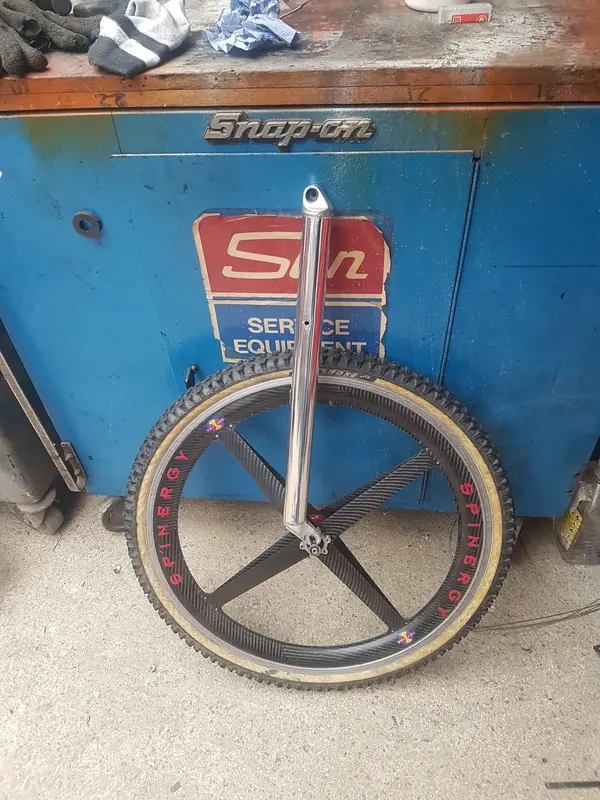

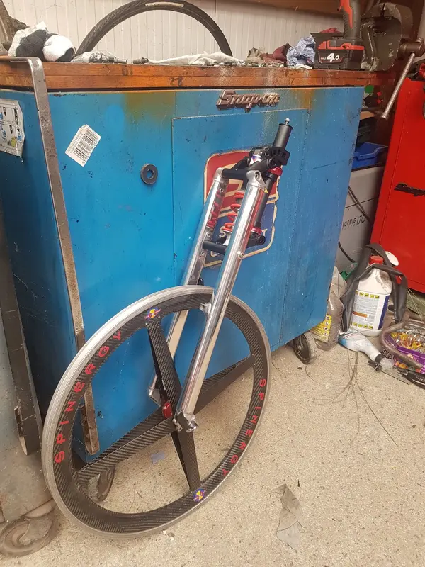

So we are now at fully stripped and I have some ideas on paint (luminous / metallic fades) and a suitable replacement for the Judy’s in the form a Girvin
The drop bars are going, and I wanted to find an original set of Zoom Brahma bars with grips but so far i have had to settle on a set of Zoom Fast tracks

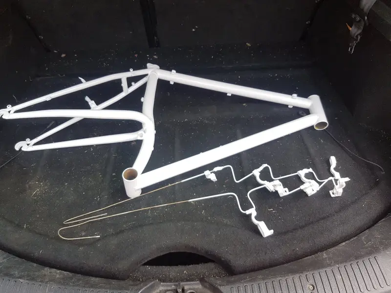

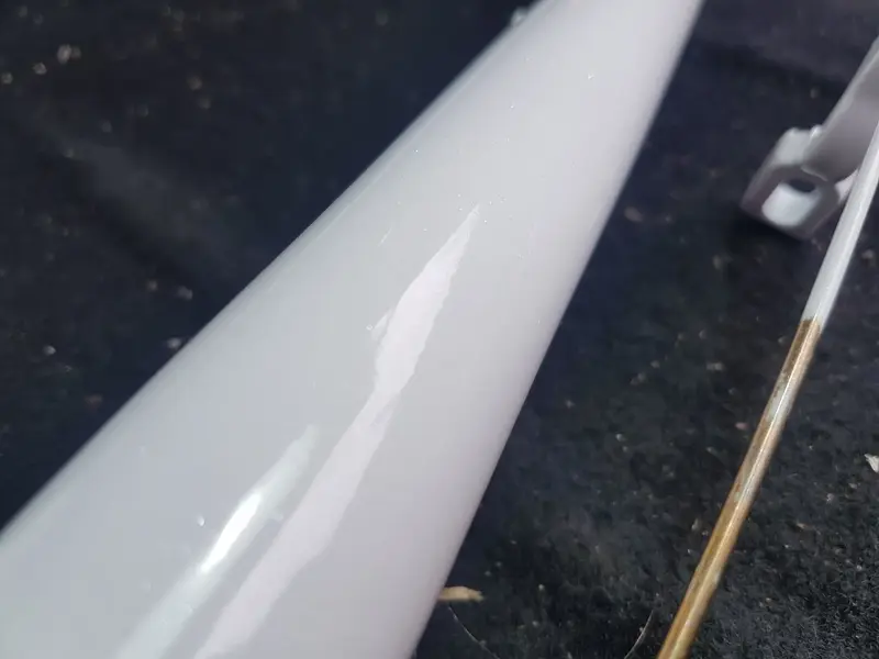

As mentioned the frame has been stripped and then powder coated. I wanted to do something in the spirt of early nineties so a multicolour fade at each lug with a base colour on the main tubes.
I didn't want to go full appliance white (keeping it real) so added some flake to give it a bit of sparkle.
Luckily the brace that was added 30 odd years ago has held up and there were no cracks by the front mech braze on.

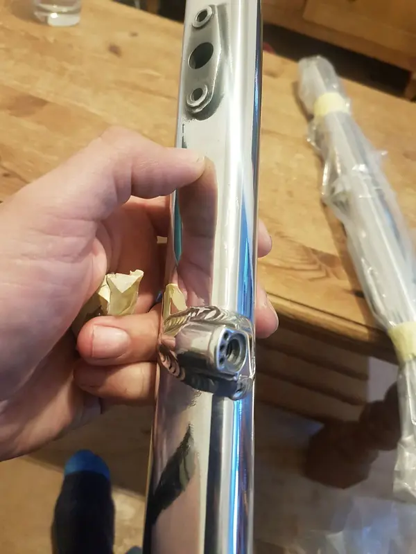

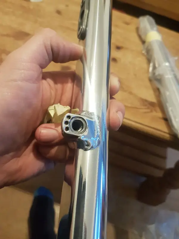

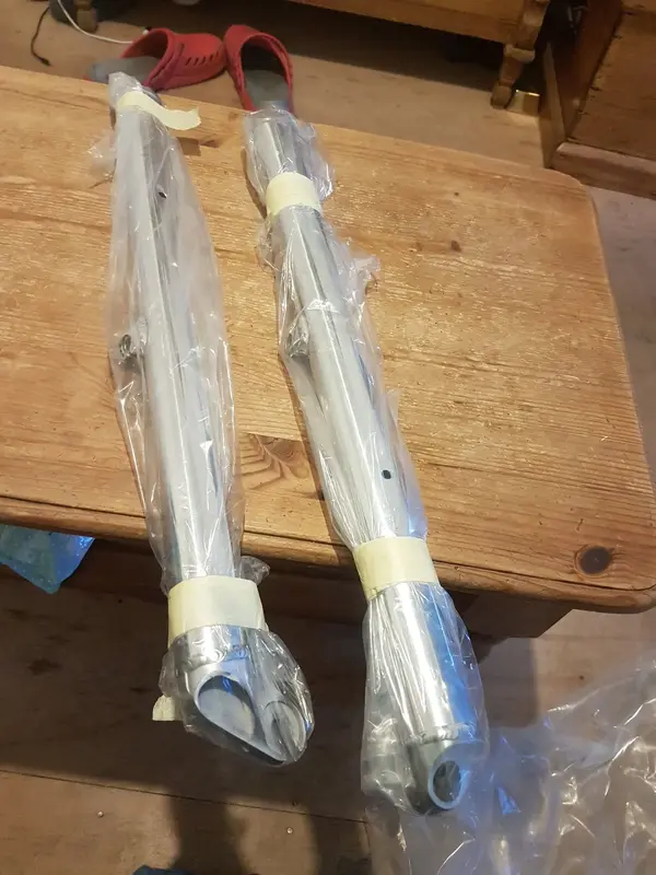

Christmas had come early when i got home as my fork legs have just got back from the polishers.
They started life here and after a bit of internet searching i confirmed they are the AM (After Market) versions so no Proflex's were harmed.

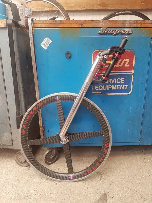

More Christmas Presents arrived today in the form of these.
These are the ones that Magpiegifts kindly let free to the world.
The front has no issues and after a quick wipe over, clean and inspect I removed the bearings to find they were exactly as described being good but old and they are a commodity so new ones will be sorted today.

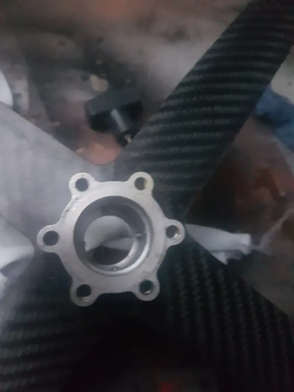

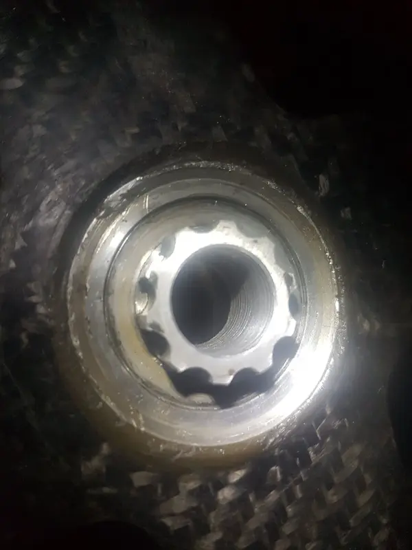

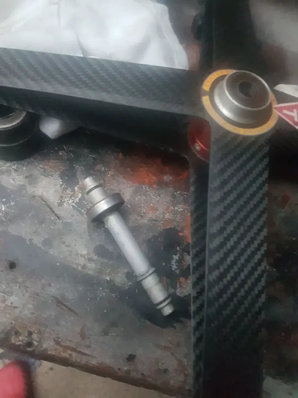

The rear is a bit more convoluted as the axle was snapped (GA Cycles in Southampton is the current best lead). More pressing the freehub locking thread has gone
But I have a plan which involves getting a broken hub ( PLEASE see my wanted add). This will then be cut up so I am left with the threaded section in a top hat billet. The hub will then be reamed out oversize (+ few thou) and then top hat inserted with some thread lock to take up the gap allow for some self centralising. Unless some one else has any ideas.

Just to keep a bit of momentum up with this thread or i will just let it die due to being easily distracted. The issue with the rear Spinergy is no thread to attach the freehub to.
SO the options are:
The thread is M14*1 (have taps) so i can make a lock nut and then either remove some meat from inside the hub inner rear face so the nut is closer to the outer edge or get a longer freehub bolt if they exist ? ? Or continue with the above solution
OR the other option is go for a screw on type freehub and then tap out the hub to M22 ?
In other news but no pictures the front is now full operational with new bearings and a good once over.
