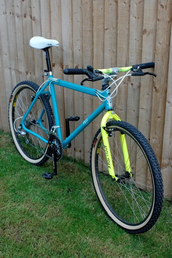

Finished the last few bits tonight - decals and stuff.
Here's a pic from the garage, will do some more when I get it out and about.
It's pretty much everything I wanted it to be - for now!
Nice! 8)
That’s the right choice of components for that frame, imho.
I’m not sure about the unpainted stem, though. :roll:
Cheers and enjoy it!
jmazpiazu":d0klby85 said:
Nice! 8)
I know what you mean about the stem, it just feels too 'catalogue spec' for it to be painted though, this is supposed to be emulating a race bike of the time which presumably would have had all manner of prototype and custom stuff coming and going.
Also check this video of the 1990 worlds at 5 minutes and 37 seconds.......
http://www.youtube.com/watch?v=qfx82fVznDQ
Now it makes sense to me. :wink:
racer x":o4eitc0l said:
Black stem cap :lol:
Yes that's the one - better get the black marker pen out!!
The stem looks very similar - the cable routing especially.
I am not convinced that racers would have used bullseye cranks though?
The arms/spider are nice enough but the BB/spindle design is way ahead of its time but let down by the quality of the bearings (absolute crap) and the way it fits together with all those spacers is a bodge IMO - I just wouldn't trust it not to all come loose and fall off.
I have read about the switch from campy stuff to shimano here:
http://mbaction.com/Mobile/News/Durango ... _3378.aspx
I am pretty sure others would have done the same BITD so I am going to have a bit of a play with this, maybe fit campy chainset and brakes....

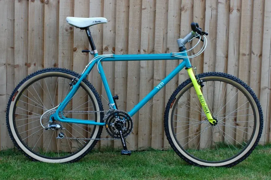

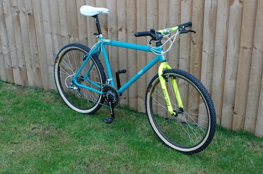

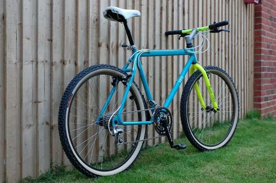

Here's a few more pics:
Here's the spec:
Frame: 1990 YETI F.R.O.
Fork: YETI Accutrax
Headset: XT (NOS)
Stem: FTW Prototype
Handlebar: Taperlight
Grips: ODI
Brakes: M732
Brake Cables: Shimano SLR (NOS)
Brake Levers: M733 (NOS)
Shifters: m735 Thumbies
Front Derailleur: m735
Rear Derailleur: m735
Derailleur Cables: Shimano SIS
Freewheel: Shimano 7 speed HG 12-28 (NOS)
Chain: HG91 (NOS)
Crank/BB: Bullseye
Chainrings: Shimano SG 26/36/46
Pedals: m737 SPD (NOS)
Hub Skewers: Ringle Holey
Rims: Mavic MA40 (NOS)
Hubs: Bullseye (NOS)
Tyres: Onza Racing Porc (NOS)
Saddle: Turbo (NOS)
Seatpost: m730 (NOS)
Seatpost Binder: m730 (NOS)
