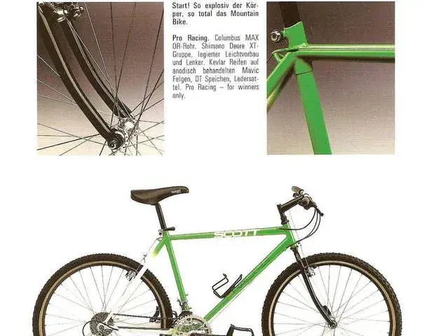

I'm 95% certain Nigel is a 1991 Scott Pro Racing...with very little original parts remaining.
Columbus Max - check
Canti noodle - check
Reinforced seat tube - check
Ritchey dropouts - check
They're a rare beast, so good score! Below is the best image I could find that I could steal, see what you think! The dropouts look different here, probably as it's a catalogue/pre production frame, but I've seen other images of the frame with the ritchey versions :)

No worries..I was thinking Scott but needed to do a little digging. TBH I was being polite when I said 95% certain, I'm actually pretty darned certain :wink:
It you search the model online there's a Flickr account showing a very nice version with the dropouts and the same front fork. I'm thinking the SE cantis may have been original too (kinda makes sense). This would be sooo cool repainted as original with M735 XT refitted 8)

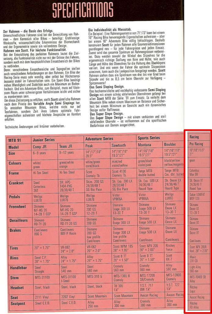

Here you go :D
