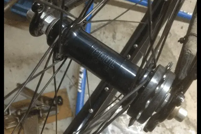

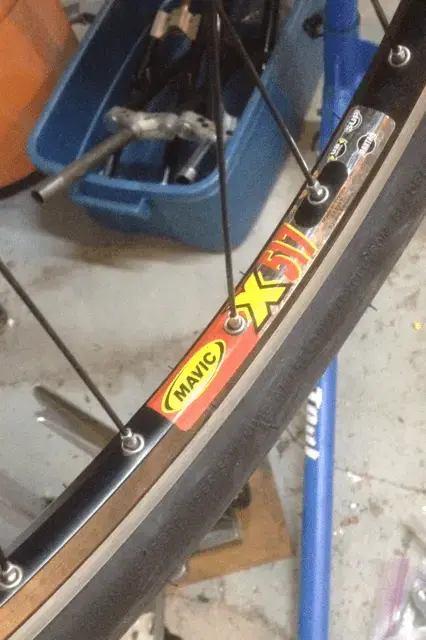

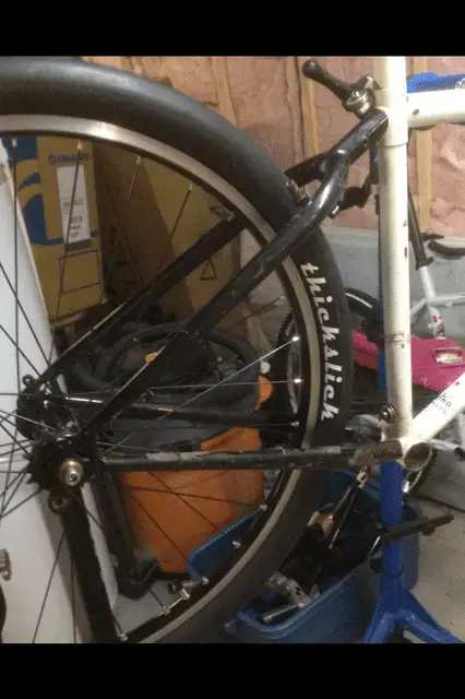

Re: 1990 Rocky Mountain Blizzard.... PAUL - Single Speed Build
New wheels came in... They were more than I wanted to spend but they are perfect...
The front is the exact match, just didn't have another rim tape liner so I couldn't mount the other tire
:D

Excellent build.
Keep us updated, i'm very interested in the Center Pull brake setup and what it takes to make them work with standard U-brake mounts.
