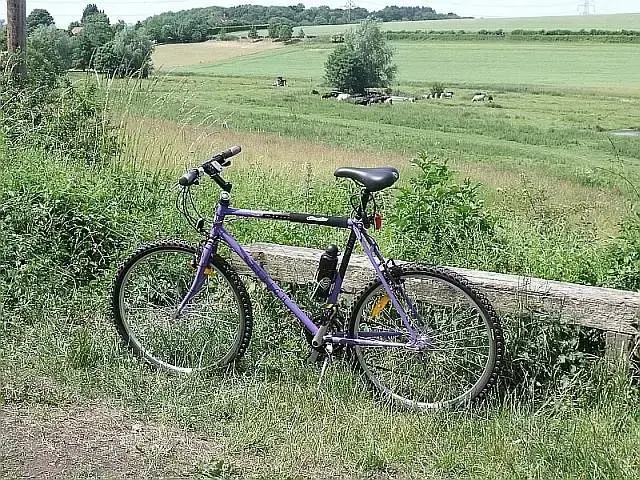

Hi, not quite a back to original restore as several bits had been changed over the years by the first owner, I'm the second. Handbuilt Reynolds 501 lugged frame. Updates were new handbuilt wheels with Quando QR hubs and a Shimmy freehub/ 8HG cassette, new V-brakes, and a bottom bracket lube. What was in there was no longer a lubricant.
The original Exage Biopace crank set is fine, the wheel upgrade took it up to an 8 speed, with 24 'vitesses'. The original front and rear mech still work well, but the original shifters and brake levers were long gone. It's got Deore thumb shifters now. 501 H/bar still intact. Chain toast, a new one is on the way. Found on Ebay, Price: £55.
It's a very old school ride , heavy but comfortable.

Thanks guys, I did a shakedown 16 miles offroad on it today, The bottle cage fell apart, the front mech wants to swap places with the rear mech, and out of the 24 gears on it, I have 4.

But the ride quality is fabulous. Biopace was always a nice thing to pedal.
Points noted about skinwalls. I'll wear out the cheapies, then move forward into 1990.
I pulled the bottom bracket and forks, the lube in both had the consistency of Marmite. All the metal is fine, so they've been teflon greased, All much better.

It cost about £300 new in 1990 I'm told, a lot of dough then. I rode it (off-road of course) to the local village square today, where half a dozen of the local ne'er-do-wells wondered what the heck it was. If it hasn't got springs all over it, and 'Apollo' on the downtube, it's not an MTB.
New drivetrain and mechs a must. My thumbs are bleeding.
The montage I have shifted like this when I got it, but with lube, new cables and a darn good clean it was fine. Until the frame parted!

I had my bottom bracket doctors hat on again, today, the large chainwheel was bent by about 10mm, chucking the chain off even with the mech limit screws properly set, that and the oval Biopace made it a pig to align. The 20 year old chain is toast. It must be a foot longer than when it was new.
I want to keep the Biopace, so the chainwheel went into the vice for a bit of 'cold-setting' ( bending) . Try as I might to save them, the front and rear mech are shot, so new Acera stuff is going on. I have it on my road bike and the shifts are dreamsville. All the drivetrain bits should arrive tomorrow.
Here's what this cheap bike has cost so far:
Ebay bike £55.76
Wheelset and HG 8 cassette: £69.00
Tyres and tubes £22.00
Teflon Grease: £6.00
Front & rear mech, plus chain £40.00
Deore shifters- used £15.00
V-Brakes: recycled £0.0
Levers, ditto
Saddle £11.50
=£219.26
