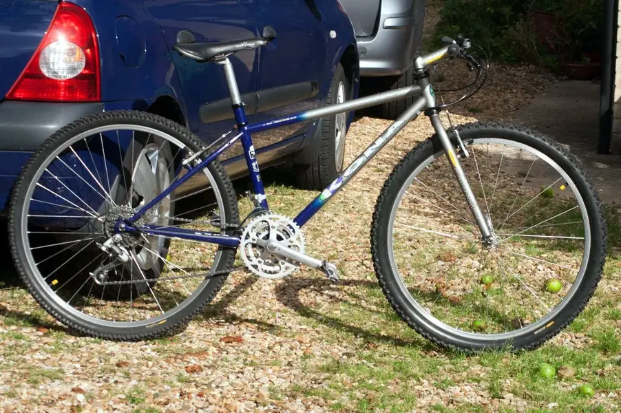

That would explain it then. Very nice Cindercone BTW, the frame lugging and angle looks very similar to my 93 Lavadome which is very light. Did Kona use the same frameset across different models?

Dug this out, bought a while ago for this project, along with the other xc ltd stuff
Could anyone let me know what size bb would be needed for this ?? Or how to work it out standard un54 115mm I was thinking would this be ok ?
Nice lavadome agent29 by the way
Cheers
Ha thanks :D
Thanks for the info n all, just scouted eBay and found a un55 127mm which should be bang on, thanks again. :D
