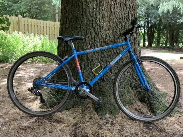

1990 Kona Fire Mountain
Great work on the paint.
Versatile bikes these, I’ve recently build one for my 11 year old but in the style of an Islabike Beinn, of which she was familiar but had out grown.
Bit heavy but pleased with it
Re: Re:
enc":3hlrsi0a said:
Great job, you should do a tut on the splatter job :wink:
Thanks, I could do one with more pics but essentially as follows:
- DO THIS OUTSIDE IF WEATHER PERMITS or put down lots of sheeting. :-)
- I used Hammerite smooth as it goes on really well, runs slightly but not too much
- I use a wooden kebab skewer, which is thick at one end and thin at the other.
- Dip in the paint and let it drip onto the part
- Move quickly for a thin line and slower for a thick one
- Do the odd random dot
Last point is probably the most important and one that I don't think I did very well. If you look at the original Brodie painted ones, they got quite a light splatter. Particularly the cheaper Fire Mountain. I'm guessing they were on the clock and had to get through a certain number in a day. It's incredibly tempting to just keep adding more until you can't see the colour underneath. If I'm being honest, I think mine has a bit too much on it but then nothing else is original on it.
