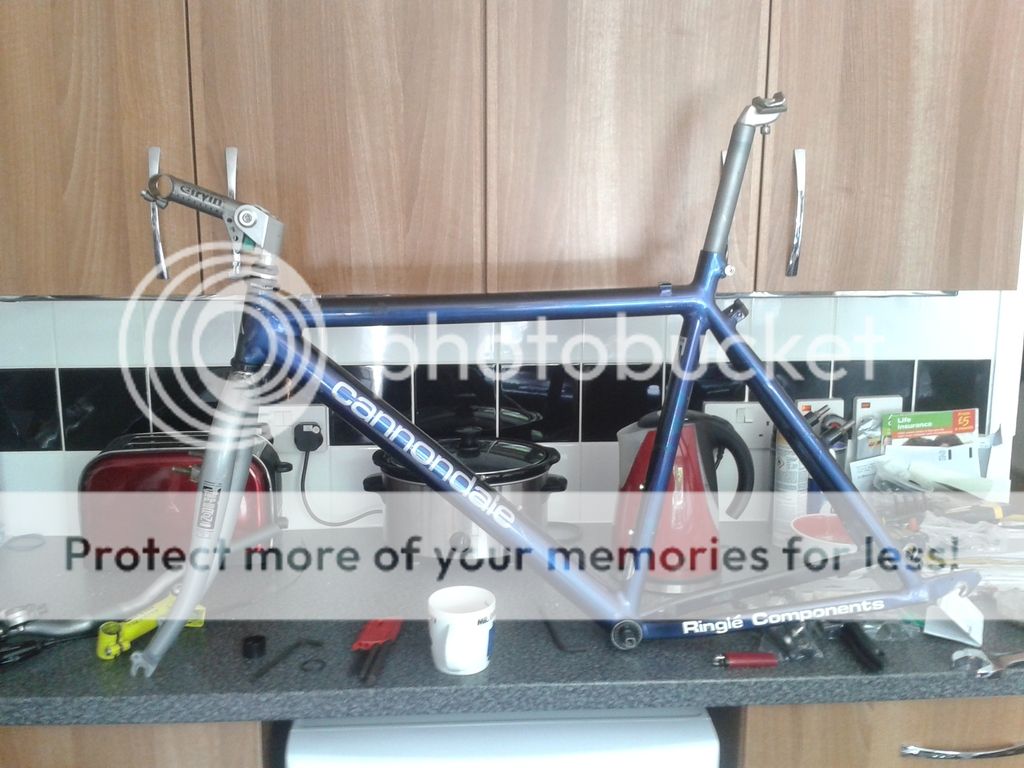

So far the bottom bracket has been fitted as well as the forks using a Stronglight A9 headset and a bottom race neoprene seal. A 135mm Girvin flexstem has also been added. The seatpost will probably be replaced with either a suspension type or a 350mm Kalloy.

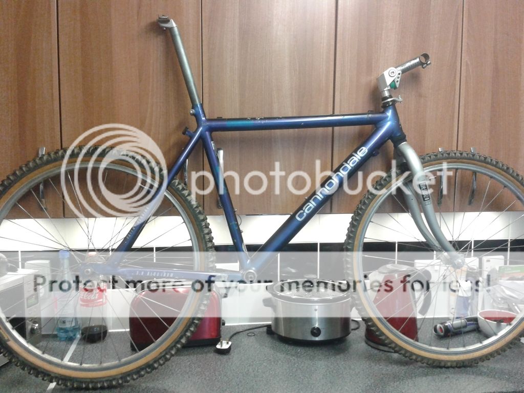

At the moment it looks like this.

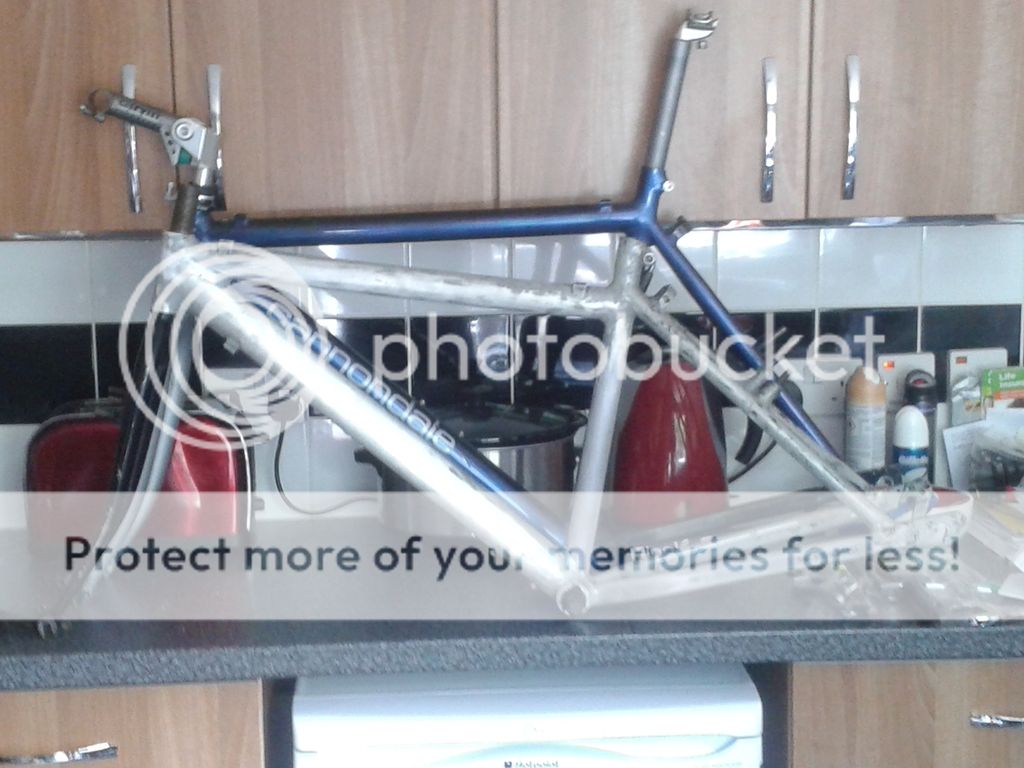

To give you an idea of the size of the frame going into storage.

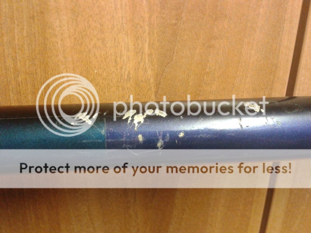

There is some damage to the frame that will need cleaning up before powder coating. Scrapes on the top tube and chain suck. It's not too bad but will need dressing.
Thought I'd take a photo with wheels and tyres on just to see the proportions and how it looks.
