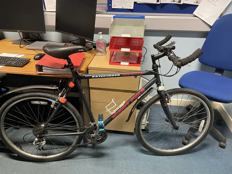

51789899-BF34-4C44-8B52-163994CBFAD3.jpeg Love to know how your getting on, also if you can, do you know what diameter the seat shaft is? As I have a similar project, but had to cut the seat stem out and not sure of the size to replace it
no updates so far, I'm afraid. I need to get it powder coated next, but I haven't had the spare time/cash to do it.
I'll see if I can find where the seat post ended up. I suspect it's gotten pushed behind some bathroom furniture that's currently filling 80% of my shed (that also hasn't helped with progress) 😕
Cheers, if you could find the seat post it would help me out massively. I measured what I salvaged of the old one at about 26.3 but someone on here has said they think old muddy fox’s are 27.2.
I’ve got one in the garage that has a dynatec seatpost I’ll pop it out tomorrow & let you know what size it is 👍
