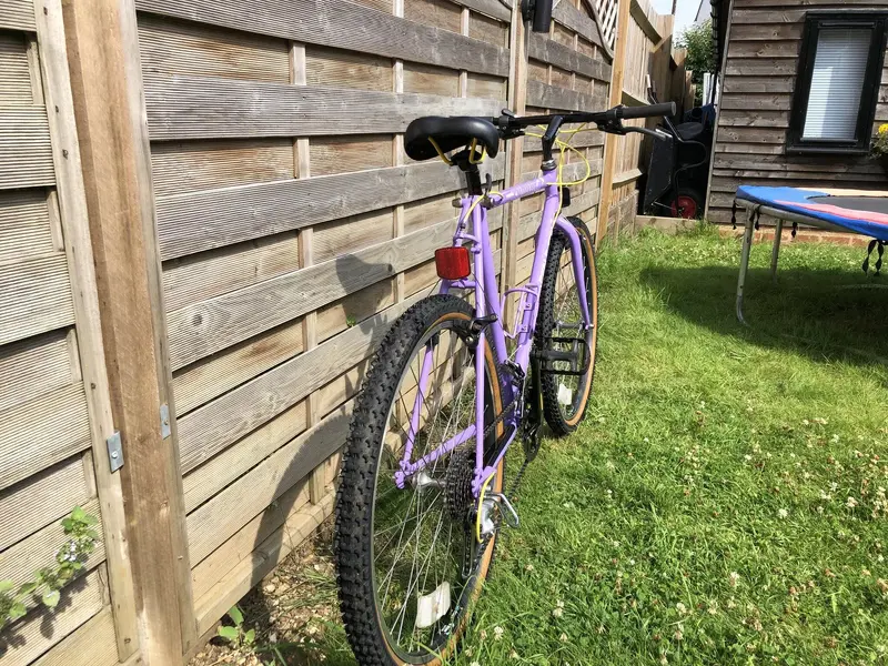

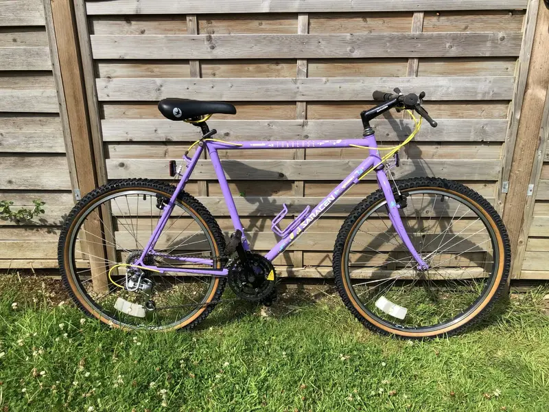

...And assembled/cleaned.. also had to straighten the rear derailleur hanger. Rear gears still wouldn’t index or shift cleanly, traced that to the rear mech twisted and lower limit screw wouldn’t engage! It must have been damaged in the past, or maybe just totally worn out? Replaced it with a DX one from the spares stash, now working spot on. :)
Anyhow, it’s all back together and ready to go. Looking forward to having a ride on it today and seeing how it performs.
