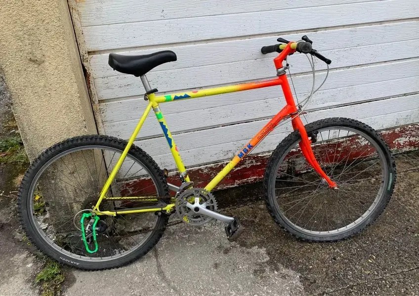

This bike popped up on my local FB marketplace for £10. Seemed a shame to miss out on these glorious 80's colours and graphics.
From some internet searching (mainly in French) it looks like a 1989 MBK Aventure.
From what I can tell pretty much all the components are original and in reasonable condition.
Shimano 'Exage Country' front and rear derailleurs / shifters and brakes / brake levers (cantilever on the front, u-brake on the rear under the chainstays).
Shimano Exage Biopace cranks and Shimano Exage Trail pedals.
Wheels are Alesa concave rims, need to check the hubs.
Plan is to keep it as original as possible I know it's not worth investing a lot into.
Cables, brake pads, tyres, tubes will need to be replaced. Everything else stripped, cleaned, rust removed, lubricated and reassembled.
Welcome any ideas or suggestions from the community!
