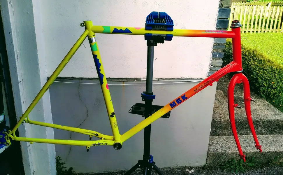

Got the bike on the stand.
First step strip the frame and see how everything looks.
Good news is there are no nasty surprises, nothing seized and everything came off in one piece.
Apart from a few marks near the crank and from the front derailleur the frame is rust free.

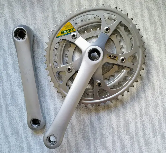

Next up: the legendary 80's biopace cranks. What were they thinking?
Shimano FC-M250 - 170mm arms with 28-38-48 removable biopace steel rings in silver.

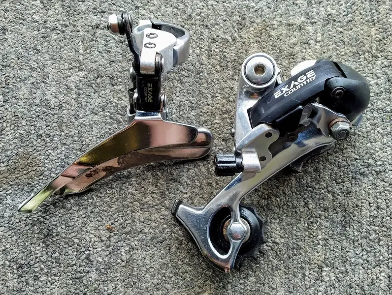

Derailleurs cleaned up, some surface rust on the inside of the front derailleur plates that came off with some WD-40 and a wire brush.
Jockey wheels are a little worn so will replace with some spares I have lying around.
FD-M250 at the front and RD-M250 in the rear both from Shimano made in Japan
