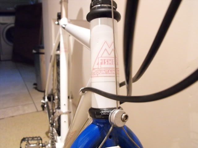

stumpjumper1990, thanks, yeah the logo on that yellow Fisher Montare looks nice.
makster, I had a good look at your Montare XT sticker made by Gil. That is from very thin lines and if that was on this grey fisher, I can see why it wasn't clear on the brochure picture!
orange71, thanks for the info, it is good to know that Gil is Fisher sympathizer!

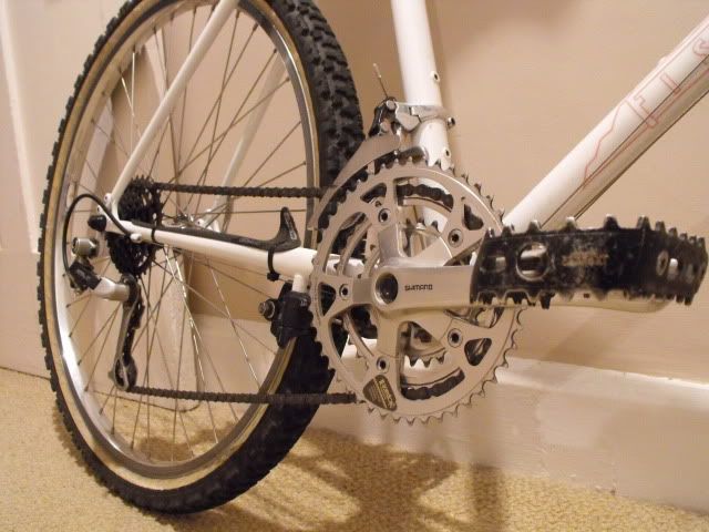

At the moment I am collecting parts a bits by bits (literally). I want to replace worn freehub body but I have a bit of question about shimano freehub compatibility and I can't find the answer I hope you can help me.
The freehub on my CR-7 is XT HB-M730. Will this Shimano Acera X Freehub Body fit? I ve got impression that the issue may be the diameter of the dust seal on the axle...
http://cgi.ebay.co.uk/Shimano-Acera-X-F ... 19c2829f42
These are the parts I want to collect for this project...
Shimano Deore Biopace chain rings (Alloy) 46-34-24 (or similar)
Shimano Pedal PD-M730 or PD-M731 or PD-M650 or PD-MT60 or PD-M735
Shimano XT 7s Thumb Shifter M732
Shimano XT Brake lever M732 or M733
Shimano 7s freehub body
Shimano HG90 or HG70 Chain
