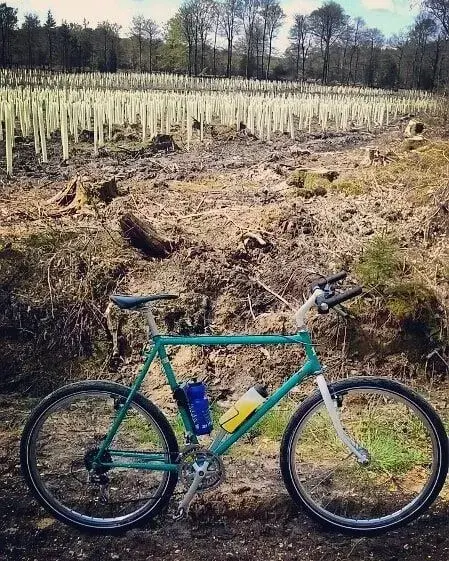

I bought a 1989 Claud Butler Pagan, in Reynolds 500, brand new in 1990 and I still own it. Its had a fairly easy life spending many years relegated to the shed by a long line of "better" more modern main bikes.
Somewhen in 2014 I found myself without a main bike so I renovated the Pagan from the ground up and started using it:

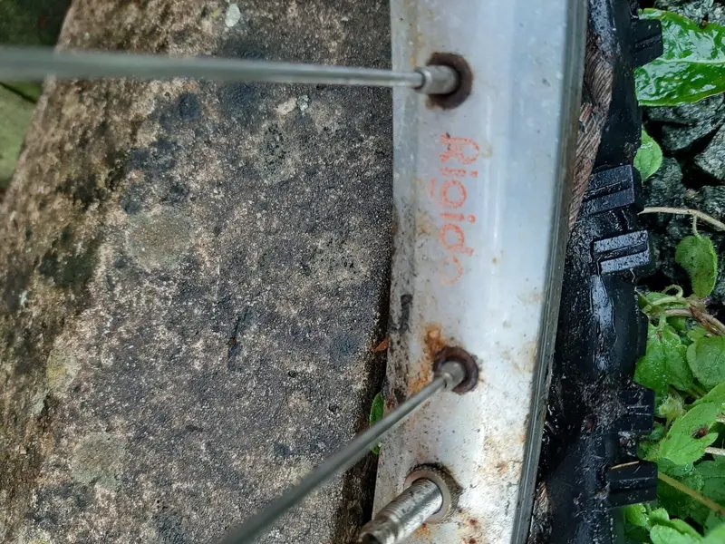

I have just had it returned to me in this condition:
Never trust a teenager with your bicycle.....

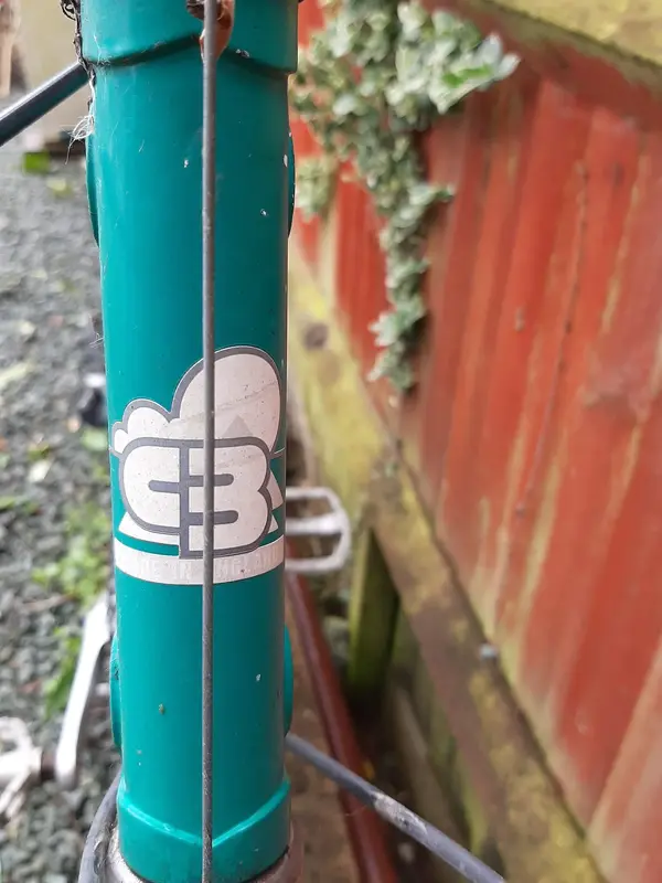

So the Pagan was listed in this colour scheme in the 1989 catalogue, it has/had the mainly white decals. Although these were mostly removed years ago, when I was younger and more stupid....
Here's what's left of the original stickering:

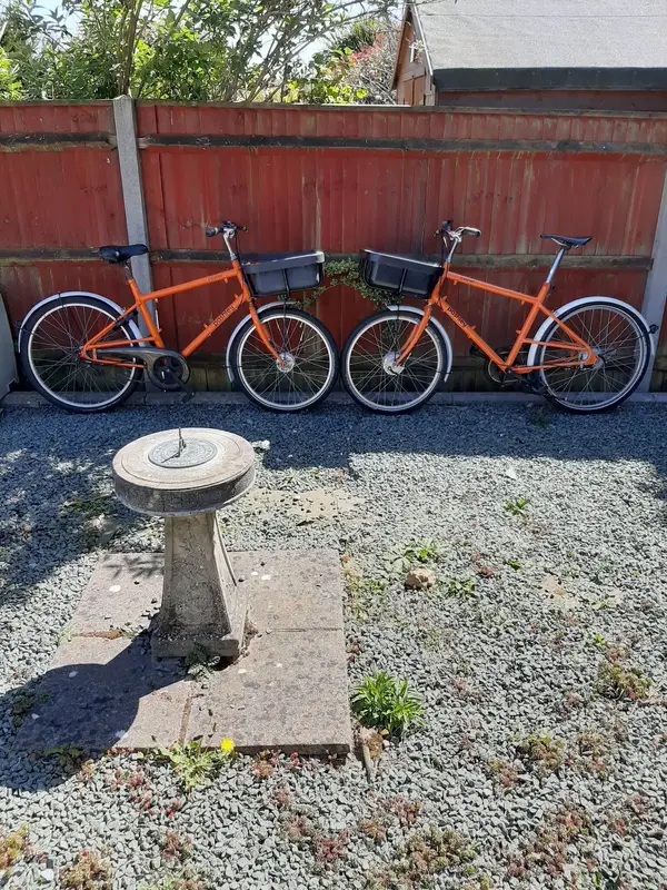

I've no idea on budget, I've managed to collect a shed full of spare bikes down the years so I have load of generic mtb bits I'd like to re-use where possible. As well as two Pashley Couriers I need to sell to fund this.
