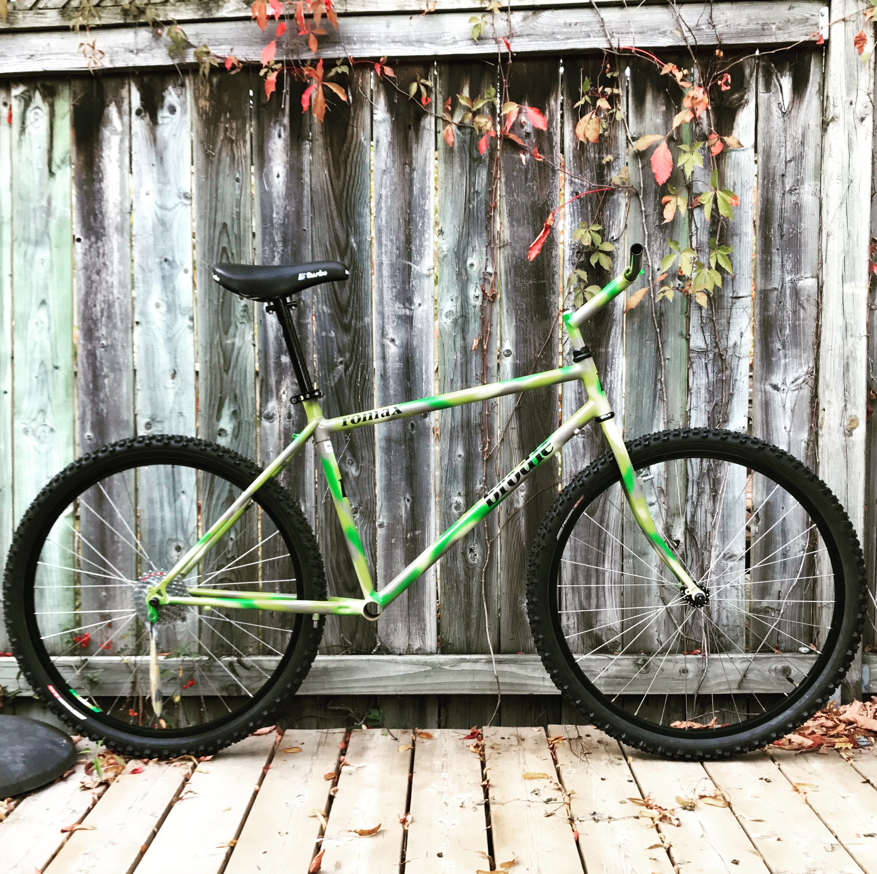

I'll try to get the previous pics back up for this build. Here she sits now.
Just needs a bunch of NOS XT parts and skinwalls. Black looks cool, but not the right vintage or look I am going for.

This one has been pretty much done for a while. Just haven't had time to finish setting it up.
Photobucket strikes again so here’s the before:
Paul Brodie confirmed its a Romax built in Jan.1989. As you can see there were some modifications made to the bike. The previous owner removed the rear U brake and replaced it with a V brake setup. The work was done well by Marinoni in Montreal, but it wasn’t what I wanted. Luckily for me, PB had a bit of time between all of his other projects to restore the rear U brake (I went lower as you can see) for me. Flawless job as you’d expect … and off it went to Toxik Harrold for paint:
I sent him a pile of pics of what I had in mind and it turned out even better then I had hoped.

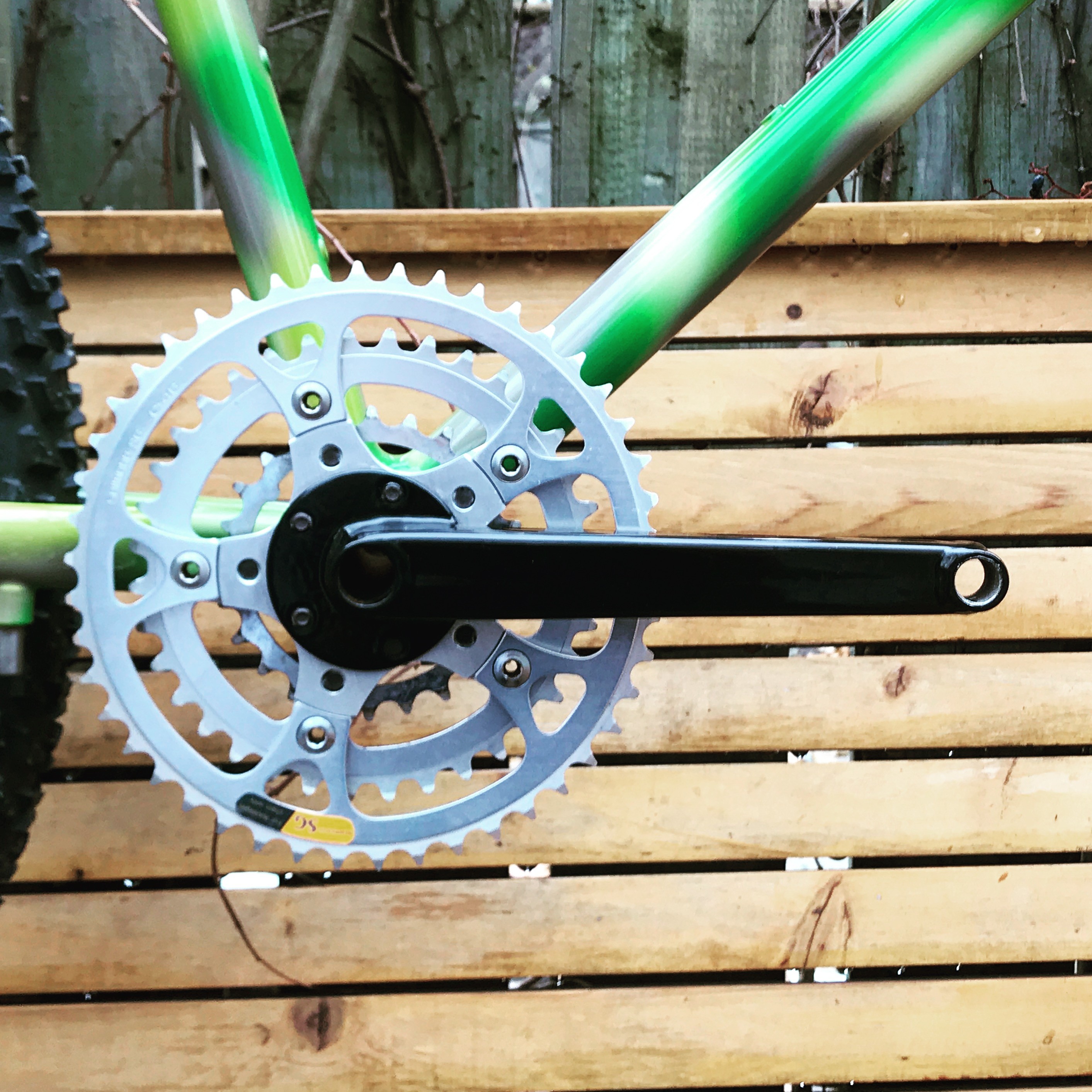

Here she is now. Basically every part on the bike is NOS outside of the Bullseye cranks which were restored to new condition. Total time machine.

Cranks: Bullseye with NOS Keeper
Crank Bolts: NOS XT730
Chainrings: NOS XT730
Chainring bolts: NOS XT730
Bottom Bracket: Bullseye
Pedals: NOS XT730
