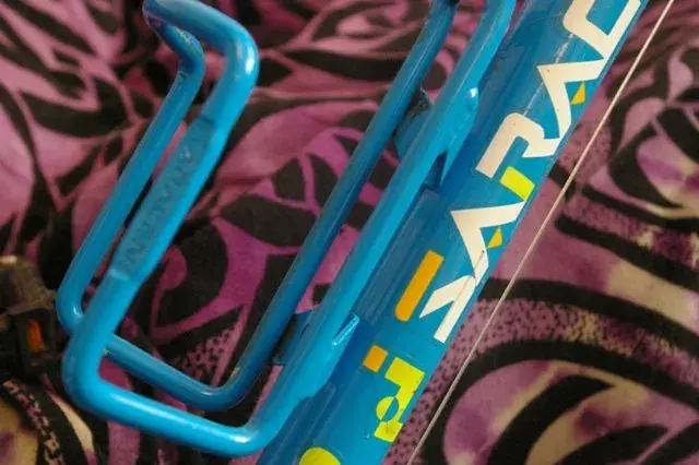

I've found a few spots of rust on the frame, nothing I'm too worried about.
Might clean them up if I can find a suitable colour match for the paint... Failing that I'll Kurust them for now.

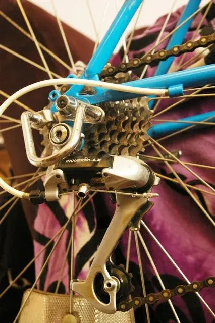

Now that I've spent a bit of time with this bike I can properly address a couple of points earlier in the build...
The bizarre effect on the paintwork is the dreaded rust, I'm afraid... It's slowly worked under the paint and caused it to bubble... Doesn't look too serious though, perhaps will need addressing in future though.
The front mech has had a pivot replaced with a nut and bolt in the past but doesn't actually look like it's bent in anyway aside from... Well... Looking bent. I'm wondering if that is because of the Biopace chain rings... The shape of the cage is a bit... eccentric. It works perfectly, anyway.

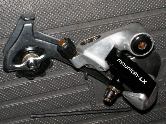

I can't get indexing to work satisfactoraly. I notice that the rear mech has no spring through the centre as per many modern mechs. I recall reading that the springs on this type of mech slackened off over time. Could be that or it could be that I'm rubbish at setting up shifting. Cables seem to move nice and smoothly.
In the meantime I good with using friction, the thumbies are a doddle to set up!
