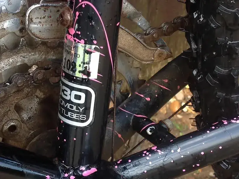

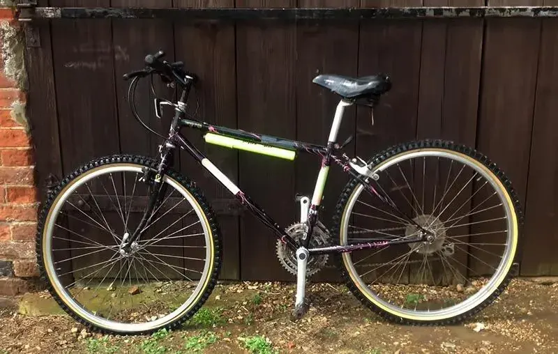

Hi
got this fire mountain on ebay £60.00
just needs some work on the paint what would you do if it was yours

Saw this on Ebay myself, It's looking nice! And the paint seems way better than mine was by the looks of things.
If you read my thread all I did was touch up the paint with enamel (easy with the bike being black in the main) and then giving a good go with some Auto Glym Super Resin Polish. Just follow the directions with this and it will give good results. I find this to be less harsh than T-Cut and gives a nice shiny finish.
The components on mine were mostly shot, so the bike was perfect for a little upgrade. Again this one doesn't seem as bad by the images, so a good cleanup of them might do the job. I would suggest new cassette and chain for reliability, and definitely new cables, outers and brake blocks. Note that U brakes will destroy tyres if the blocks are too worn, as the arms will drag closer towards the tyre sidewall.
