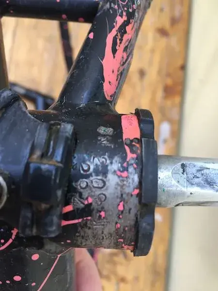

Anyway, here's something else I've discovered whilst stripping down. There's a security post code on the BB which is wonky enough to suggest a drunken home job by Dad or a copper fresh from a late night shift? . It seems to read BN20 8JS which is an address in Eastbourne - I should have been a detective I reckon :lol:

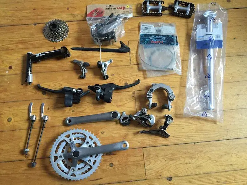

I've been busy harvesting together some more parts, the cool thing is that I now have a near complete Mountain LX drivetrain to add on as pictured, thanks to another member on here. The only exception will be the XT wheels that I mentioned earlier, these will be dressed down a bit with standard chrome skewers though.
I also received a longer T-bone stem with the package as a nice little bonus - this may prove useful should I find the original version a little too short.
The frame has cleaned up well, I'm just waiting for some touch-up paint to dry off and I'll hopefully be able to start putting the thing back together ;)
Re: 1988 Kona Fire Mountain
Wow ! you have been busy getting a nice collection together and i can see your Fire mountain looking a real treat when you've assembled all those parts on it 8) , i remember T Bones being really popular back in 89 and always looked the part on just about on any worthy mtb ;) ..
So may i ask what paint your using for touching up as i'll be doing the same soon on my 89 fire Mountain and i want to make sure i get a decent finish and as for the chromed skewers i reckon they'll actually add nicely to the overall finish ;) ..

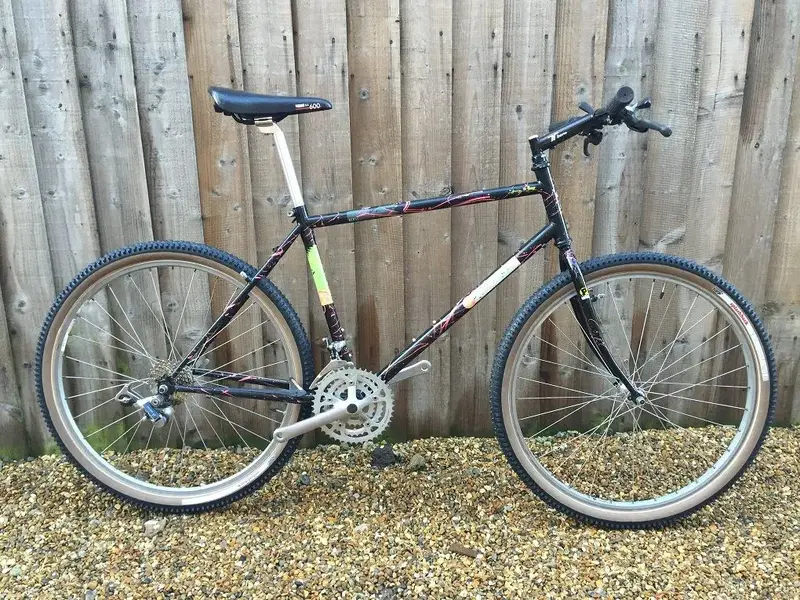

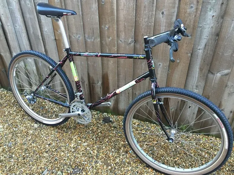

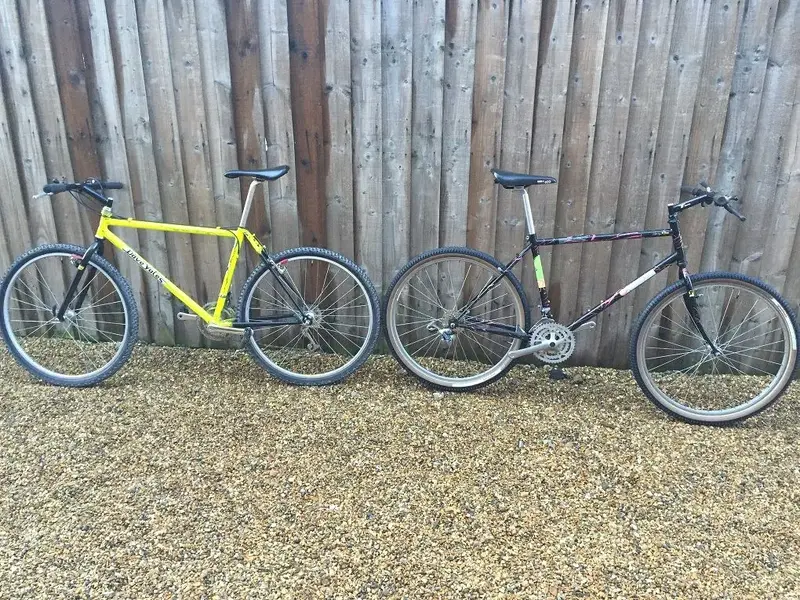

And here it is so far! It stopped raining for long enough this morning to take a couple of outdoor shots.
I actually like the riding position and overall look with the T-bone stem so it will stay on, although I'll keep the original stem just in case. The bike has been built with regular riding in mind, so tyres are modern Splashbacks and cassette is a new retro style Shimano HG41.Saddle is a bit of a temporary measure until I can see a certain gent in East London about a Turbo, seatpost was cheaply sourced from Ebay (but is pretty much the same as the OEM version). Headset and grips were sourced from the parts bin and some parts swapping between builds. The forks seemed to have a JIS steerer so a touch of dremel work was needed to fit the crown race - all is nice and snug now though in the headset department.
I'm pretty stoked with how it's looking so far. Not too much to do now before it's back on the road... I'm doing some work on my diabolo at the same time so it's muscled in on one shot :D
Damn that's looking really well so far and the T Bone stem looks really well all though i do get the impression that it's about an inch longer than the original stem ..
i'm not a fan of the splasbacks for looks as i prefer somthing a little more beefy but each to their own on that score but as for your cassette choice as i've got the same on my Raleigh which i did have on my ol Rockrider previously and the gearing is ideal for road and light trail ;) ..
That saddle looks a little to narrow for me but seems to suit the look of the FireMountain and your Diablo looks pretty impressive by the way mind you i'm a sucker for yellow framed bikes ;) ..

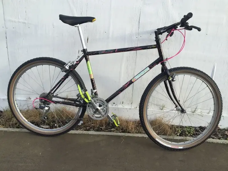

Bit of a fast forward on this one - I actually finished it a while ago but Christmas sort of got in the way of updating the thread :facepalm:
To cut a long story short the FM has now moved on to a good home and will hopefully enjoy a happy retirement rolling along on the South Coast..It's been a nice little project, I'm pretty stoked with the result in the end.
Here's a picture taken before I handed it over to it's new owner. I should have taken more scenic shots but I was too busy riding it! now on to some more projects :)
