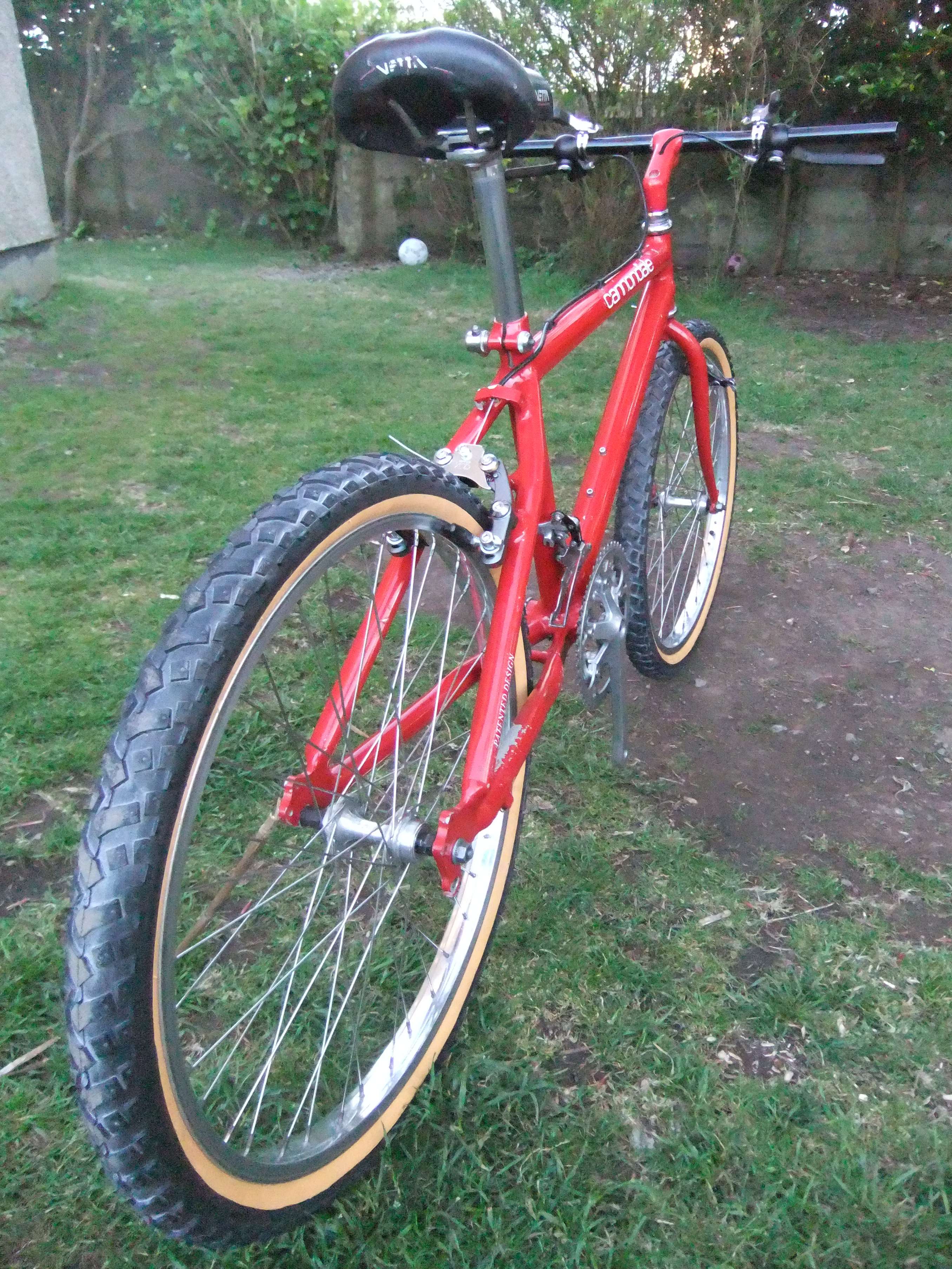

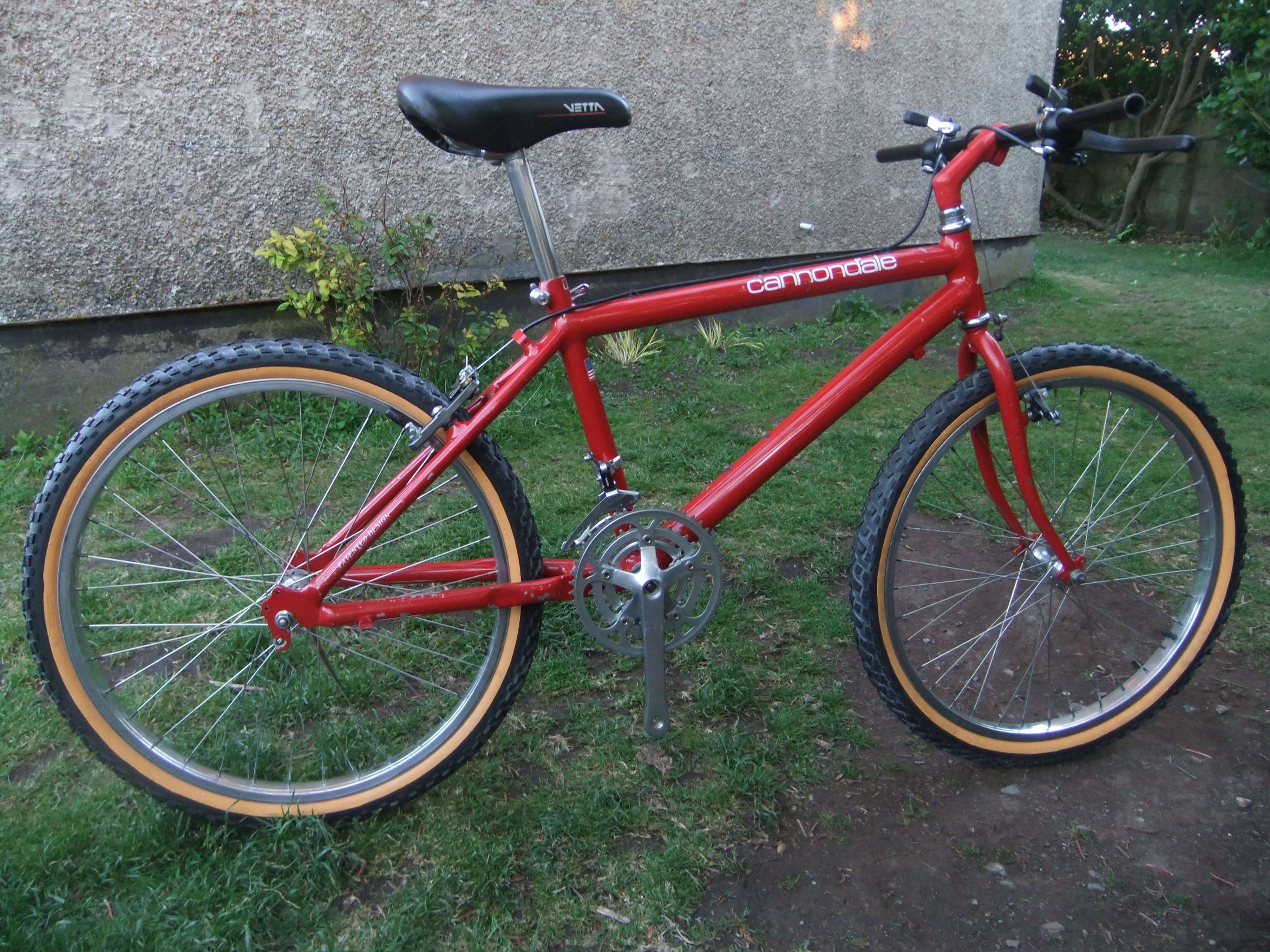

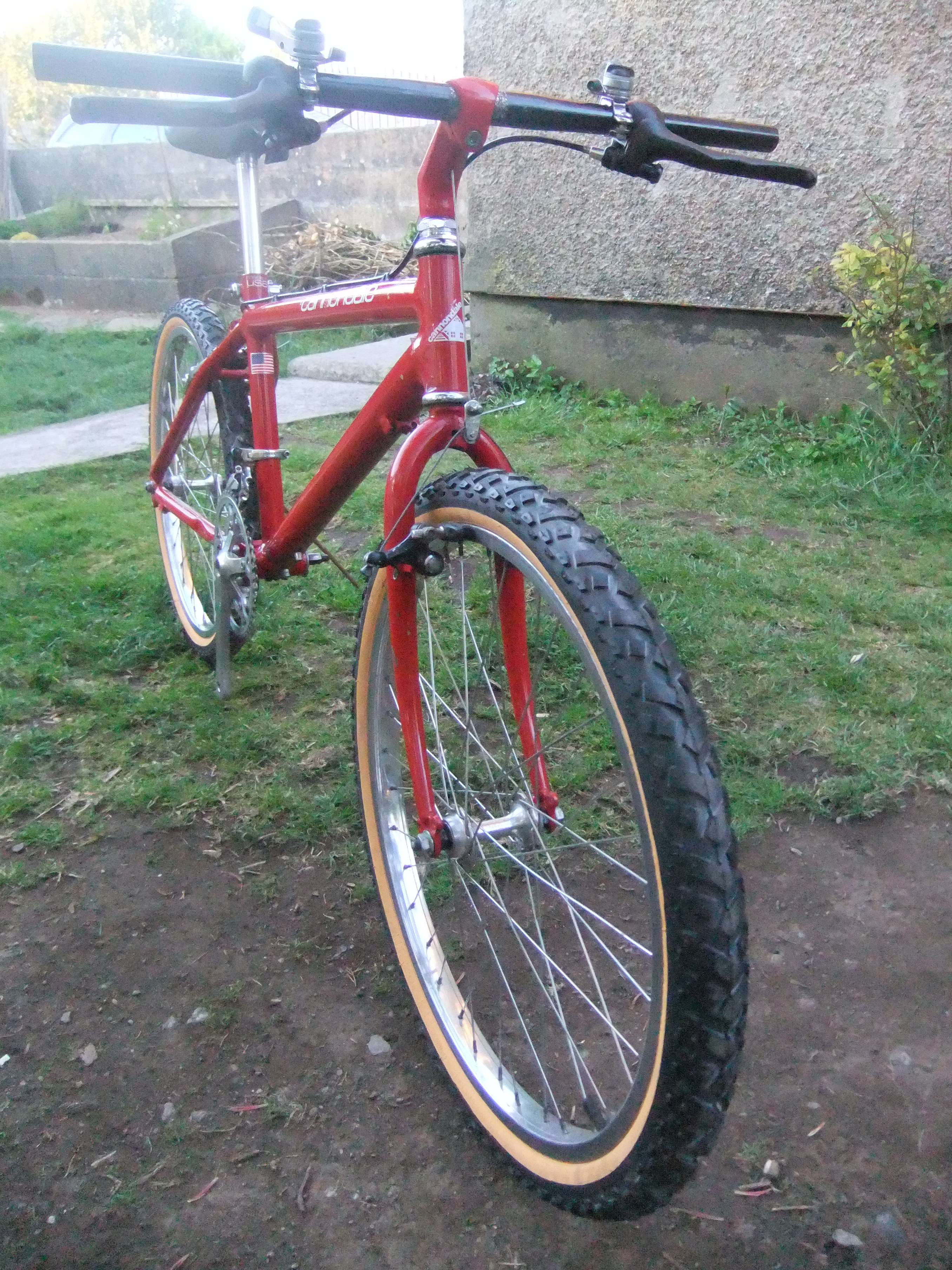

I've made quite a bit of progress in the last week or so, particularly today. I've stripped and regreased the hubs, BB and headset, they're still not the smoothest but are so much better than before. A bit of Peek polish and some sore fingers has brought the wheels up ok, still a lot of tarnishing but again, so much better than when it landed. Everything else has had a good clean so I started putting it back together today. I have a nos Suntour 6 speed freewheel in the post and I still need a LH crank or complete chainset, grips, gear cables, pedals and chain. Apart from that I'm almost there :roll:
Here's how she looks now...

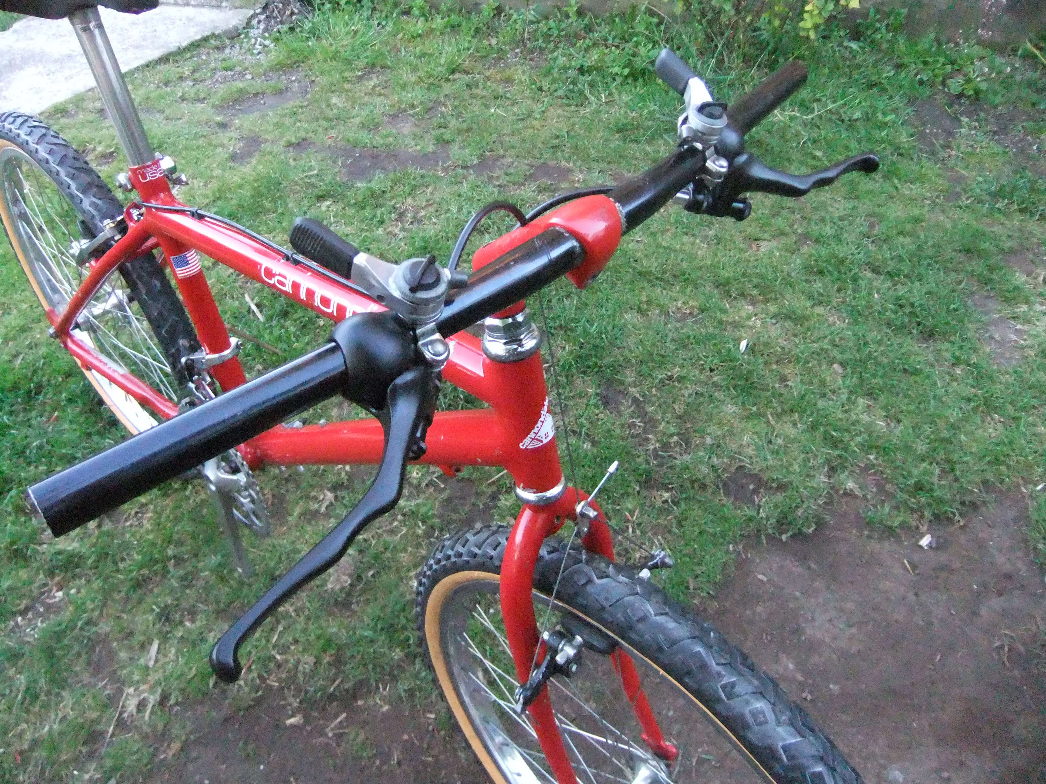

Cheers Roy :D
They're cabled up and ready to go (although the roller cam needs a bit of adjustment). If you look at the 1st pic you can see the cable routing in the blurry background. The rear facing cable works well routing through the stem for the front brake but not sure about the rear one. I may alter that outer once I've given it a test ride; the fact it point backwards doesn't allow such big loop for the outer cable but you obviously still need enough to allow full lock in either direction.
Re: 1988 Cannondale 24"x24"
That's looking tip-top :) Those brake levers are very interesting indeed, as for cables you really only need 60degrees movement to each side plus it'll help stop the bars flipping round and denting the top tube in case of accident. :wink:

did you use standard mountain bike brake cables? or road bike brake cables?
looking at the levers, i didn't think the mountain bike cable ends would work/fit in the levers. never tried yet mind you. :oops:

I just used standard mtb cables. There's not really anywhere for the cables ends to sit as such but because they pull straight I don't think it will matter too much.
