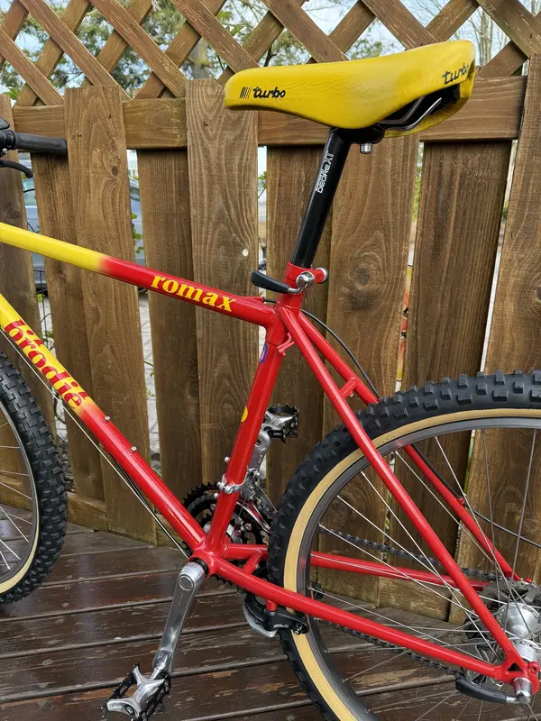

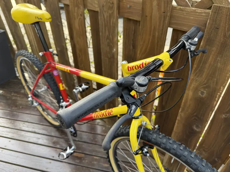

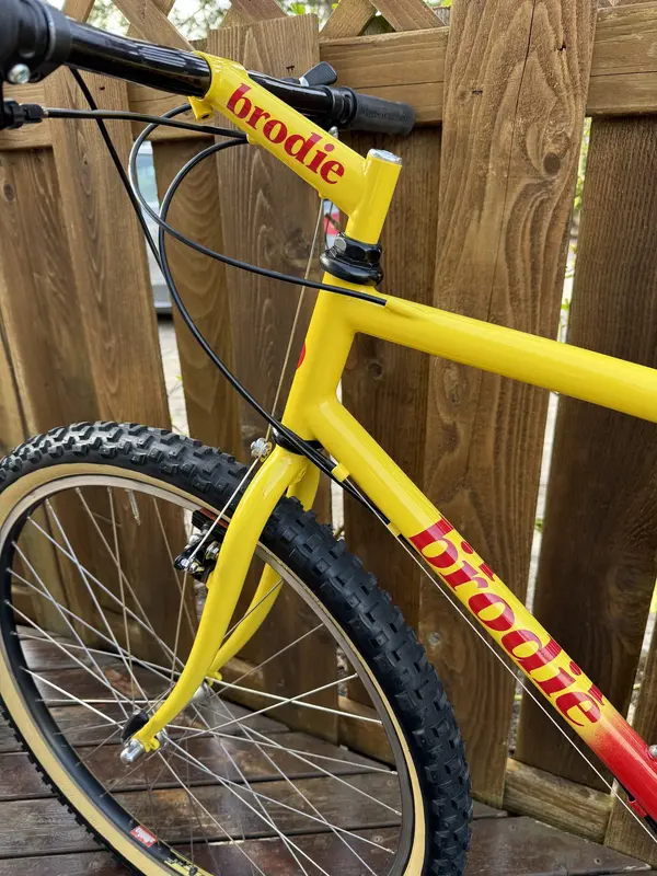

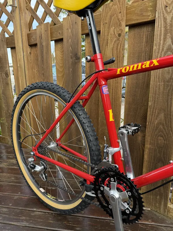

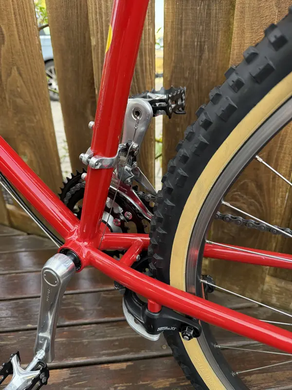

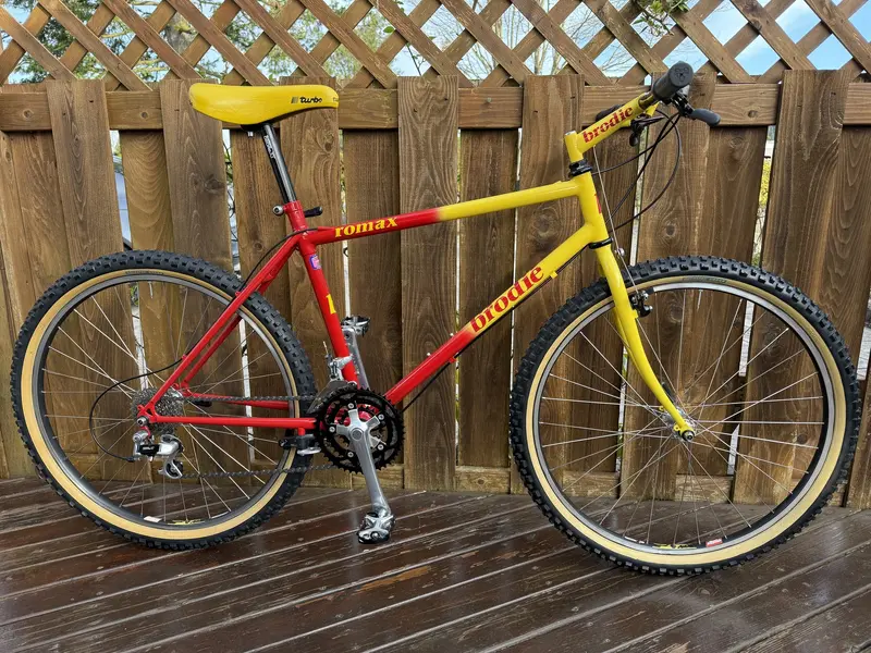

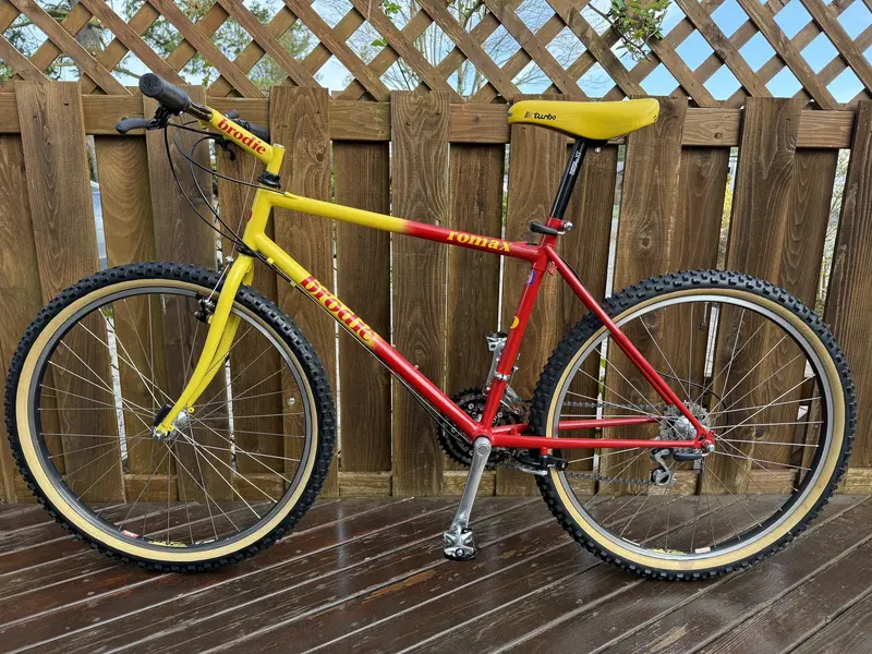

1988 Brodie Romax
It's finished and I love it

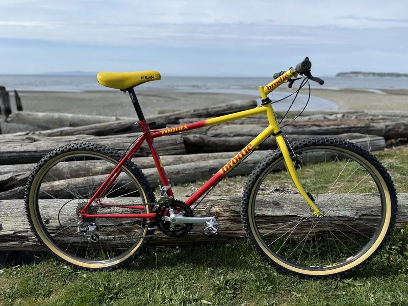

I waited a week before shooting the clearcoat after laying down the base coats, a good idea to ensure the base coat was fully cured and it was also nice to have a few days to carefully add small touch ups to the original red paint where there were some paint chips (top, seat & down tubes).
Personally, I find shooting the clear coat very stressful, it’s not hard to make mistakes which could cause thoughts of starting over if your picky. Fortunately, I got through clearing the frame and I’m satisfied with the results, not perfect but acceptable. I found clearing the stem and fork last year so much easier (for obvious reasons), I find frames a lot tougher being an amateur armed with a rattle to get every surface even, etc.
So after a few days of the clear coat curing I tried my hand at cut polishing some areas which received less paint and were lacking that smooth texture the thicker areas had with pretty decent results I think. Overall, I’m very happy with the finished frame paint results.
This 18.5” frame shares the same geometry of the 18” catalogue spec, compared to my previous 19” brodie climbMax it has a shorter top tube and wheelbase, I’m not a very tall dude so the fit is much better. I absolutely love the ride.
The yellow Turbo saddle was a big splurge being an NOS example, I picked it up last year in the fall. Kinda the icing on the cake I think 😊
I’m lucky enough to own some great retro MTB bikes. All the bikes I dreamt about BITD. This romax tops them all though. It really ticks every box and then some 😊

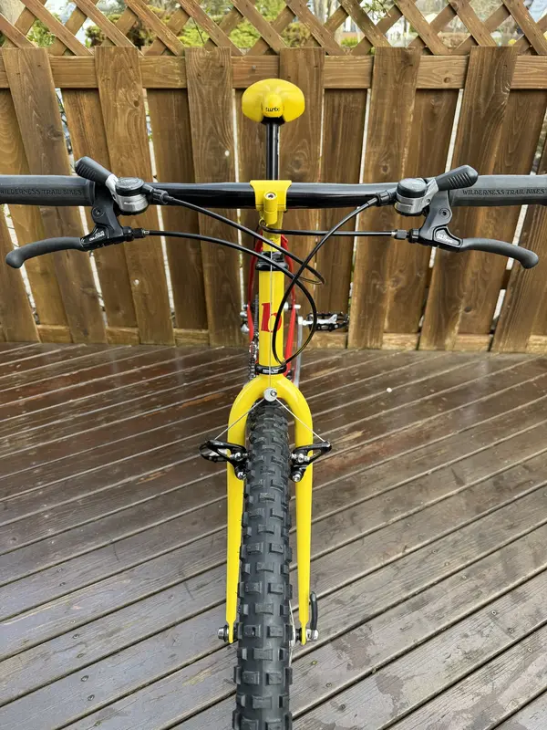

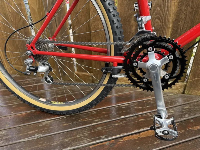

Finished build spec:
Frame: 1988 Brodie romax (Frame # 278 18.5” Tange MTB 4130 Tubing)
Fork: Brodie fillet brazed unicrown
Headset: Deore XT HP-M735
Stem: Brodie TIG ICR 140mm
Handlebar: Unbranded black aluminum
Grips: WTB Trail
Front Brake: Deore XT BR-M732 Canties
Rear Brake: Deore XT BR-M731 U Brake c/w Brodie booster
Brake Pads: Scott Mathauser Super brake
Brake Levers: Dia Compe SS-5
Shifters: Deore XT SL-M732
Front Derailleur: Deore XT FD-M735
Rear Derailleur: Deore XT RD-M732
Cassette: Shimano CS-HG41 11-28
Chain: KMC
Cranks: Deore XT FC-M730
Crank Bolts: Titanium
Chainrings: Suntour
Chainring bolts: Shimano Dura Ace Alloy
Bottom Bracket: Deore XT BB-UN71
Pedals: Suntour XC 9000
Hub Skewers: Deore XT
Rims: Wolber AT 18 (32H)
Hubs: Shimano XT FH-M732 (rear) HB-M730 (front)
Tires: Rockstar Sierra 26x2.1"
Tubes: Maxxis Ultralight
Saddle: Selle Italia Turbo 85'
Seatpost: Deore XT 27.0
Weight: 26 lbs
Awesome bike and build! Very nice work!
I agree with you 100% in regards to clear coat. I messed up all my frames at the first try so far.
