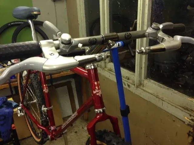

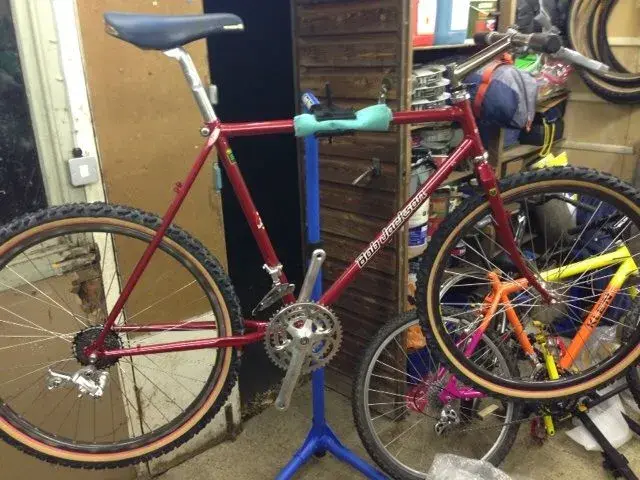

Bit more progress tonight
Yep, it's starting to come together now.
Will get some pics in the day light
Bit of a milestone today, final got the drive side pedal out of the drive side Euclid crank
It taken months, had to buy a vice, destroyed a park tool pedal spanner, so had to buy a set of bluepoint spanners, and finally it out.
Had to strip down the pedal, and the axel has issues, hopefully I can get the thread recut to sort it else I need a new set of pedals!

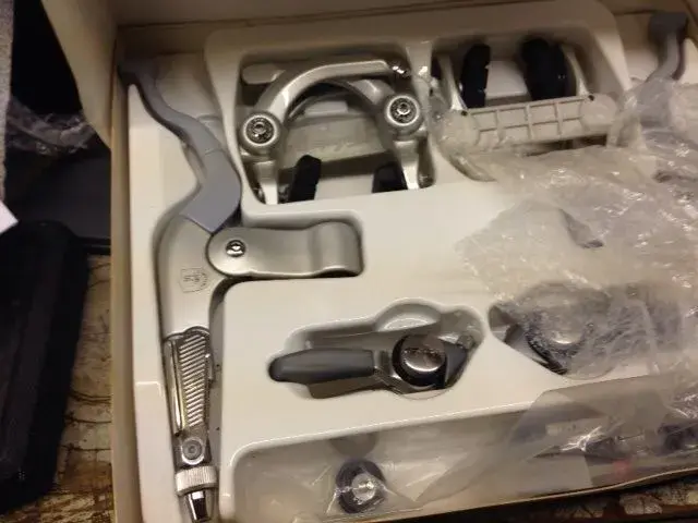

Got a set of cantis on the way, so once they arrive will install, then just cable up

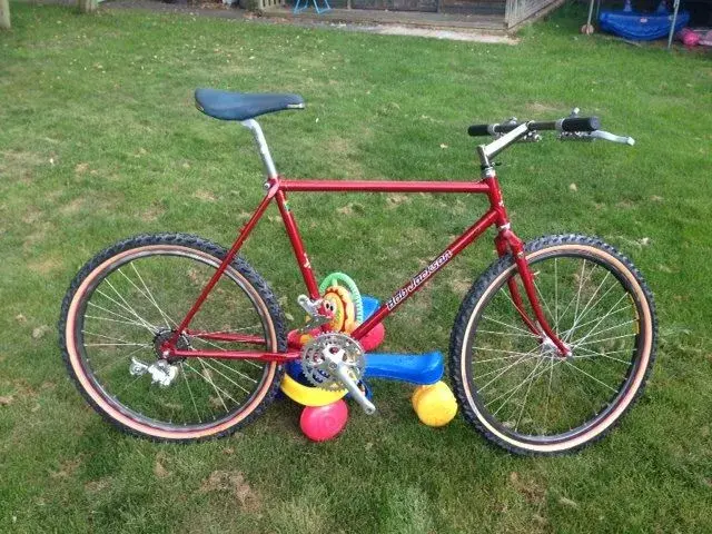

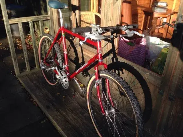

Wish I was in Warwick, afternoon snaps

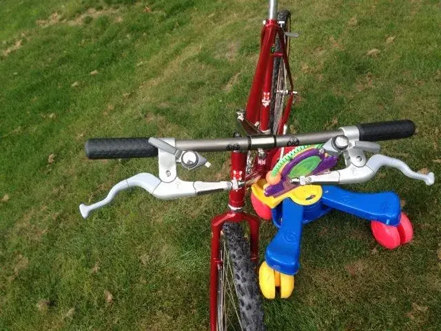

Re: Bob Jackson - Confirmed born in May 1988!
Small steps, but progress nonetheless.
Front brakes now sorted - thanks Will
Rear U cabled up and working
Grips changed
Pedal axle cleaned up with a hack saw and wire wool, pedal rebuilt (amazing didn't lose and bearings!) and installed

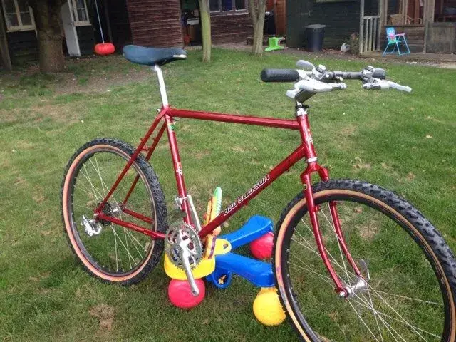

Just need to cable up front brake, gears and find a chain. Then on the home straight - toe clips, deciding if i can afford a new brooks for this, maybe flipping over the seat post etc
Wow, what a transformation! It must have cost a mint. Is the post really that long? It looks like the typical road posts of the era that were only 180mm, that thing must be rare as hen's teeth.
