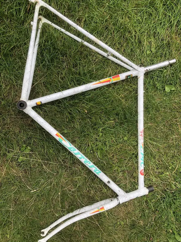

1988/89 Carrera GT Epic
Just don't go too caveman on it. If it isn't budging with reasonable force, pause apply more oil and wait. Better off taking longer than bending the frame!
Yep, not going to risk messing it up - it’s only the drive side that’s stuck. Not the end of the world if it stays stuck, I can still clean and re-grease it from the non-drive side opening.

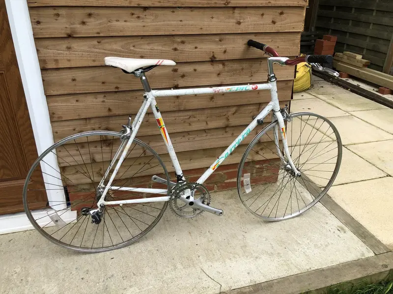

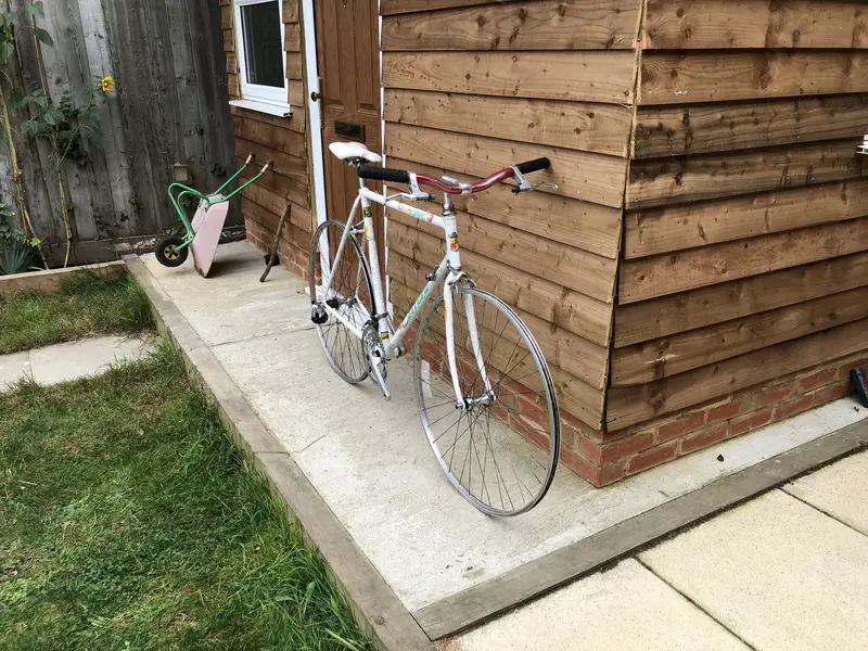

Managed to give this a good old clean and polish. It’s come up pretty good as some predicted it would.

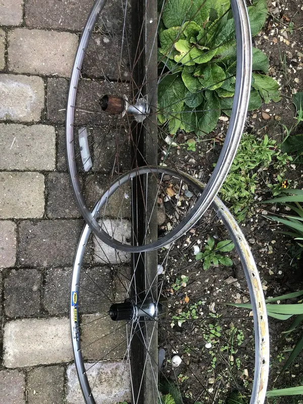

Next decision is wheels; the original spikes are hella rusty. The hubs should be good after a service and the rims are very good (Araya’s). Do I just rob the spokes off these cyclocross wheels I have, or should I upgrade to the Tiagra hubs as well? Originality or modern 8-speed?

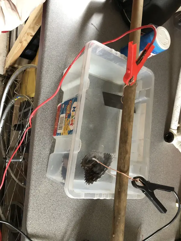

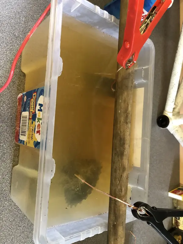

Using electrolysis to clean up the original 7 speed cassette, this had very little wear so I wanted to reuse it. Plus I’ve never tried the electrolysis before so this was a good excuse to give it a whirl.

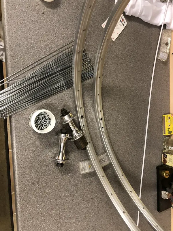

I’ve decided to rebuild the original wheels, just waiting for replacement spokes to arrive and then I’ll crack on with that too.

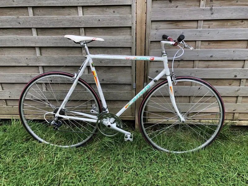

Managed to spend a couple of hours on this today. Just methodically working through the components cleaning and reassembling on to the frame. Tried on some Azonic bars that I have to give the flat bar conversion a try, it seems comfortable like this but I’m not 100% decided yet.
Once the spokes turn up I can rebuild the wheels and get this ready for a test ride, tyres are on order too..

Got the wheels built and bike is now completely built up apart from new brake blocks which should be here Friday..
So chuffed with this, only did a quick spin up the road (using my work boots to slow down!) so far, but riding position is nice and this is light and seems fast.
Clearance between base of fork crown and these 25/700c size tyres was a fag paper at best, but some careful ‘massaging’ with a half round file has given me 2-3mm now.
This has been a bit of a budget build for me - not intentionally really, but total spend is just under £100. That doesn’t include the bars, 3ttt stem, grips or brake levers - but I had them already. I normally only go for 80/90’s mountain bikes as projects but I’ve really enjoyed doing this road bike for a change.
