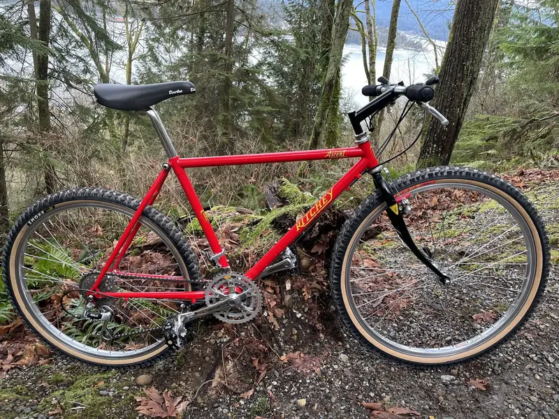

Don’t mind the black tape in place of a handlebar grip which is temporary while I wait on the stem. It’s built up as far as I can go with it.
I’m super happy with the paint/decals. I can’t wait to ride it again. Also, it’s great to have a late 80s MTB to add to my (2) steel & (3) aluminum vintage 90s MTBs.

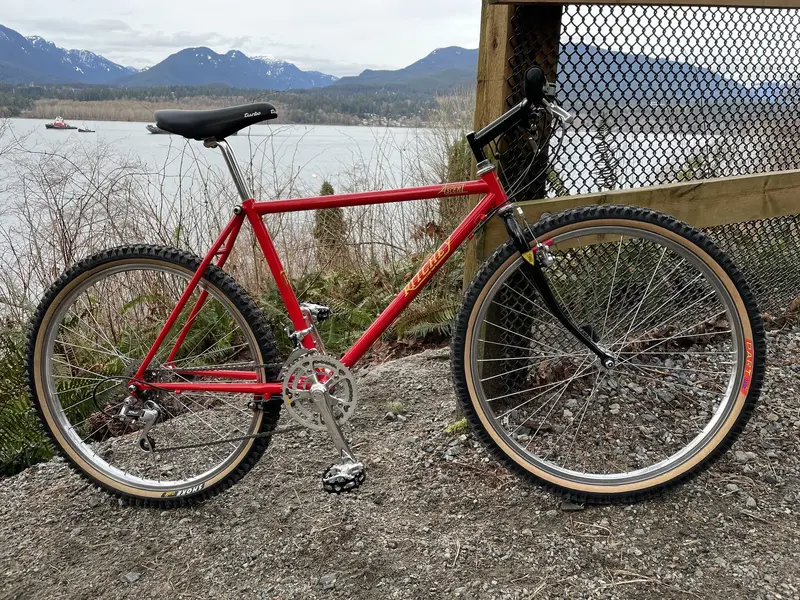

Here is the build detail:
FRAME: Tom Ritchey 4130 (Tange), Double-butted seamless Chrome-moly, ovalized seat tube at the bottom bracket, reinforcing seat collar with cold forged vertical dropouts. Weight: 5 lbs 2 oz (2325g). Price: $600. Year: 1987.
| Threads | English | | | 24 | 36 | 46 |
| Wheelbase | 107.2 cm ; 42.2 in. | | 13 | X | 72 | 92 |
| Seat tube | (center-to-center) 45.5 cm ; 18 in. | | 15 | 42 | 62 | 80 |
| Top tube | 56 cm ; 22 in. | | 17 | 37 | 55 | 70 |
| Head angle | 70 degrees | | 20 | 31 | 47 | 60 |
| Seat angle | 73 degrees | | 24 | 26 | 39 | 50 |
| Chainstays | 43.3 cm ; 17.4 in. | | 30 | 21 | 31 | X |
| Bottom Bracket height | 29.2 cm ; 11.5 in. | | | | | |
FORK: Tom Ritchey 4130 (Tange) rigid unicrown Chrome-moly. Weight: 780g. Rake: 1.87 in.
WHEELS: Weight: 2096g - Rear wheel (1159g) Front wheel (937g)
| HUBS | Front: Shimano Deore XT HB-M730 (140g), Rear: Shimano Deore XT FH-M730 (356g) |
| SPOKES | 36 - 3X Stainless Steel 14 gauge spokes, brass nipples |
| RIMS | Araya RM-20, 27 mm wide (970g) |
DRIVETRAIN:
| REAR DERAILLEUR | Shimano Deore XT RD-M735 (250g) | | |
| FRONT DERAILLEUR | Shimano Deore XT FD-M730 (111g) | | |
| CHAIN | KMC (300g) | | |
| CRANKSET | Shimano Deore XT FC-M730 175mm ; 58 - 94mm bolt spacing (734g) | | |
| BOTTOM BRACKET | Shimano Deore XT BB-UN71 (244g) | | |
| REAR COGS | Shimano Deore XT CS-M730 six speed 13-30T (287g) | | |
| PEDALS | Suntour XC II (439g) | | |
COMPONENTS:
| FRONT BRAKE | Shimano Deore XT BR-M732 (170g w/ brake shoes) |
| REAR BRAKE | Shimano Deore XT BR-M733 U brake (265g w/ brake shoes) |
| BRAKE LEVERS | Ritchey Logic (180g) |
| SHIFT LEVERS | Shimano Deore XT SL-M730 (185g) |
| HANDLEBAR | Zoom (161g) |
| STEM | Ritchey Force 130 mm (370g) |
| HEADSET | Tange Falcon (190g) |
| SADDLE | Selle Italia Turbo 1980 (310g) |
| SEATPOST | Kalloy Uno 26.8 (220g) |
| TIRES | Panaracer – 26 X 2.1 Smoke (rear) Dart (front) (1194g) |
| TUBES | (293g) |
| SKEWERS | Shimano Deore XT (193g) |
| CRANK BOLTS | Titanium (20g) |
| HANDLEBAR GRIPS | Ritchey WCS True (45g) |
| SEATPOST BINDER BOLT | Shimano Deore XT (76g) |
| GEAR/BRAKE CABLES & HOUSINGS | (176g) |
| WEIGHT: 25 lbs 10 oz | |
