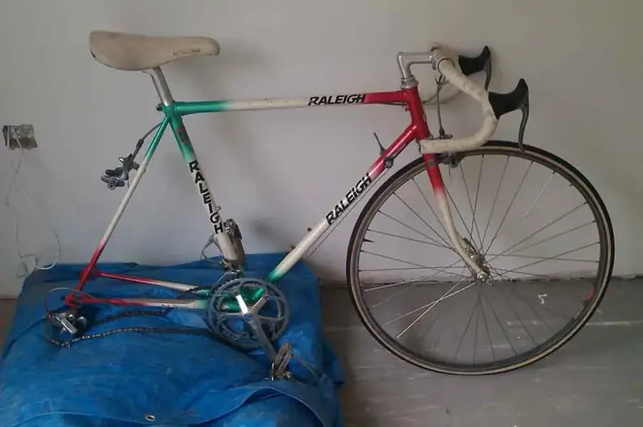

I got this bike off a friend to save it from the tip.
Whilst trying to work out the year and model I stumbled across your 653 race. This one has had a much harder life than yours! The groupset is Shimano 600 rather than durace. It has Mavic wheels with 600 hubs. The original back wheel is currently being abused on my friends turbo trainer but hes willing to swap it.
I've never restored anything before. Unfortunatley it has quite a few scratches and spots of rust so will probably have to be resprayed. The groupset is in pretty good condition. Assuming I don't cock it up and Im not too embarassed I'll post some pictures when I'm done.

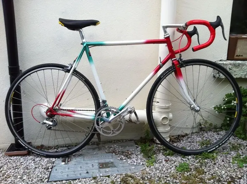

Found original photo of 653 race and how she has become!
Mines still going strong and in great condition. Rode her this morning and although the 42/52 is a killer on hills her gear change is seamless!!! :)
